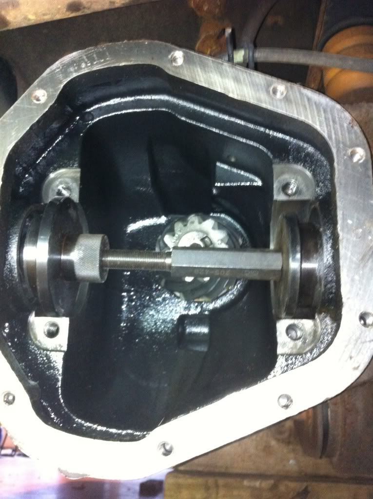

To clean the ring gear inside there use what you think cuts the heavy oil.
Me like buy spray cans of Quick start fluid better then brake clearer.
The in& out movement slop is ok since that is controlled by the inner bushing of the spindle. My spindles had a brass inner thrush bushing as the outer snap ring holes the axles from moving in & out once assemble.
When, I removed the ring gear out of the housing found that the bearing were all pitted but felt smooth when turning it.
Remove the ball wiper seals clean everything, I use to use gasoline for cleaning everything back in the day it has it's dangers plus not counting all those listed side effects.
You could pull it all down and clean it up an put it all back together then you know what you have.
Orich

For a one man installer tool. I'll see if I can show to a picture of one.
Okay here you go, this one you can buy on ebay most of the time.
Orich

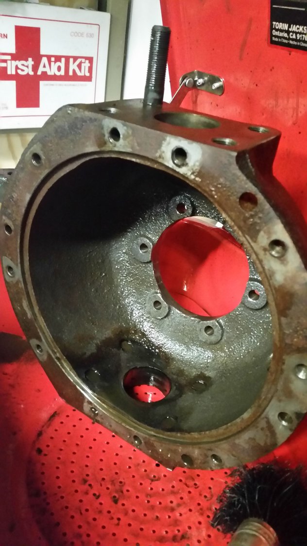

I might need to replace the bearing lol. I'm glad I took the knuckle apart. The lower bearing is ok but going to replace both bearings. The axle is in great shape. The U-joint is great. It's a spicer U-Joint and its tight and right. Where is the best place to buy a kit that comes with all the bearings I need for both sides? I will need to buy a tool to pull the race as well.

Originally Posted by F2501972
Now you know why, I stayed on you to keep pulling it apart.
You never know what you'll see if you have not cared for it.
Looks like someone has not taken good care of it, looks like someone packed it with grease then never lucked up the hubs to lube that upper bearing enough.
The upper king pin race can easily be drive in by using a large socket flipped upside down lay a flat bar across it an drive it in.
I use an old 1/2inch socket 6" extension , I use for a drive rod that, I place inside a large socket backwards to drive in bearing races only.
Been using it for extension for over 35 yrs just as a drive rod, the head is now mushroomed over from hitting on it for so long now. It's also good for installing freeze plugs to reversed socket to hole it and drive them in.
Orich

What would have caused the discoloration?

May be some kind of contamination while it sat for a long while.
A good wire wheeling on a hand drill will clean it up pretty easy an nice.

Heat also can color metal, but I doubt that the knuckle bearing would have created enough heat, as it only facilitates turning, which is not a high speed evolution, and would not do that. Rich is probably right.
Montana 4x4 has the bearing kits, shim kits, and the bearing seat install tool. The tool is not expensive, and if your shims clean up ok, then you do not need new ones.
baja
