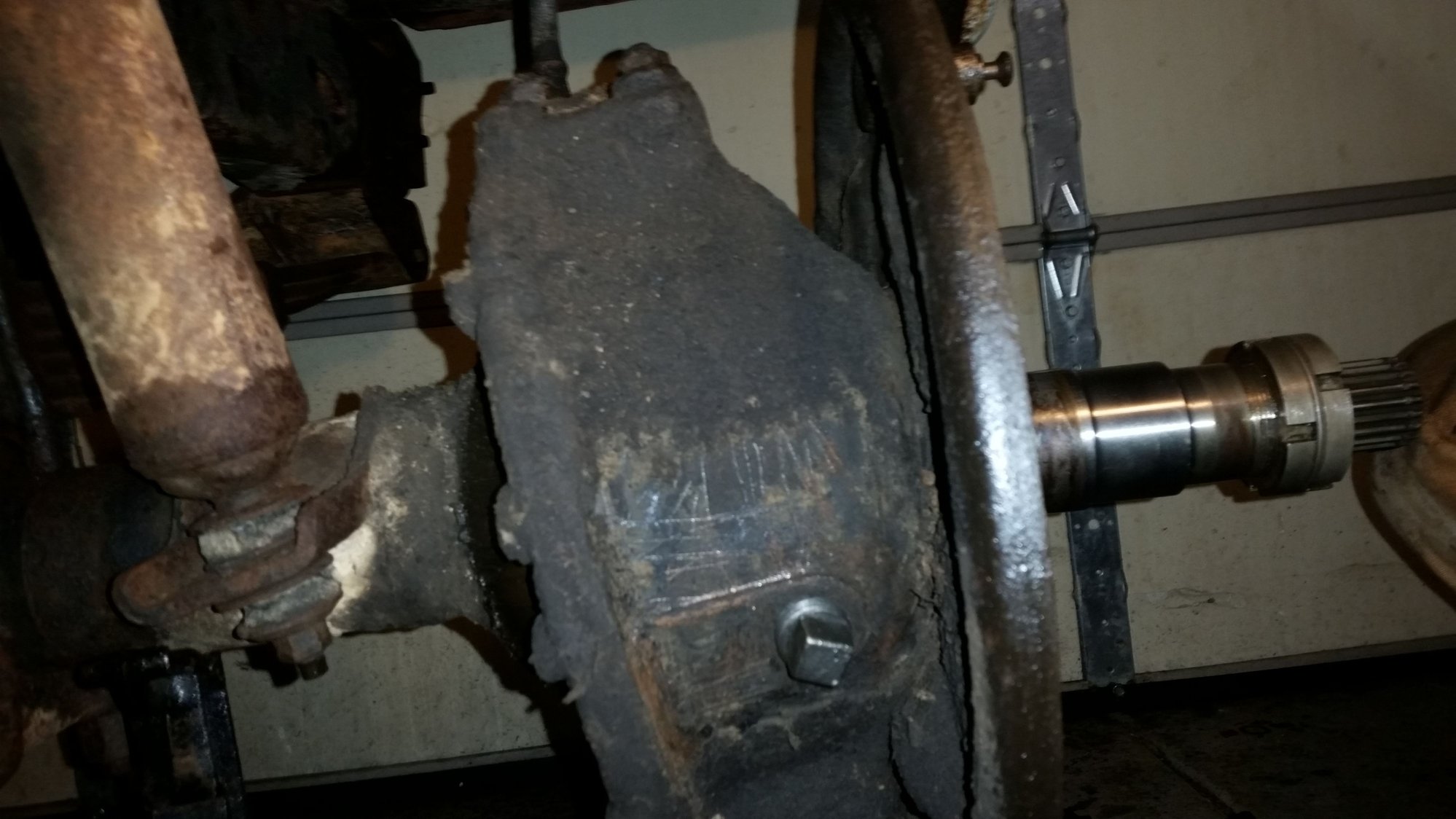

Thanks, is this the plug?
Fill till gear oil comes out? I took the plug out and cleaned it. Is that the plug you were talking about?
Yes Sir fill till it runs out 90wt. gear oil but mine leaked so mixed 90wt & STP that slowed the leak even with new ball wiper-felt seals.

F250, if you put 80-90 in the front knuckle it will leak out. Especially if your inner seals are worn. A lot of guys mix 80-90 with wheel bearing grease to thicken it up but you can also use corn head grease. Its thicker and wont run out. You can get it from impliment dealers like your John Deere or IH dealer. Pretty good stuff.
If to thick it may not get wipe up lubricate the upper king pin bearings very well. This is one of the purposes of locking up the hubs every 1k is to throw gear oil up into those bearings.
That's why, I mixed 90wt & STP it was still liquid enough lubricate well and not run out like straight 90/140wt gear oil.
Plus if you live in a colder parts of the country it may be to stiff to do the job it's intended for end up with a heavy build of grease of blockage around the upper king pin bearings that causes bearing failure.
What about running 140? I read where a guy found some info saying to use 140 in the knuckle. Thxs for the input!
