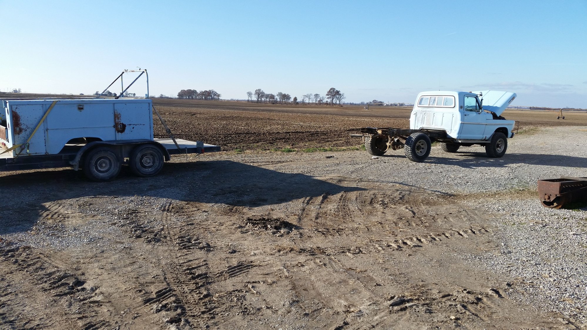

Guys, today Big Blue was Freed of the Utility Bed. It was a good feeling to knock that off the list.

Bed is on at this point but not bolted down. Had to make a mod for the bed to fit. The CS bed must be a little diff. The rest of the bed looks right but will have to look it over better tomorrow.
In this pic has bed bolted down. Yes!
