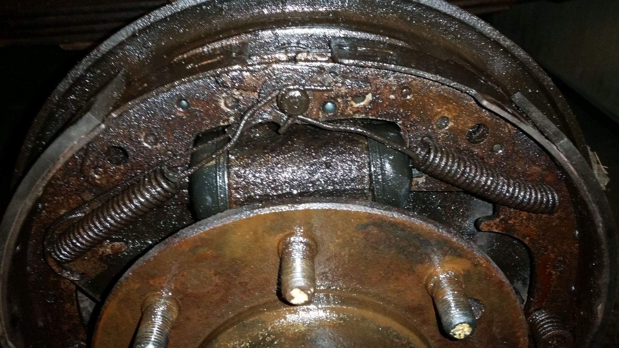

Old Dec 18, 2016 | 05:27 PM
  #83
F2501972's Avatar
F2501972
Joined: May 2014
Posts: 617
The wheel above was on the rear back (2 wheel studs missing). Look close at the wheel and you can see where 6 are -not- so good and 2 are great shape. I put this wheel on the front. Any idea where I might find a match to buy this rim? 16.5 rim. I will have the other side off tonight starting on the brake line front passenger.

What do you guys think about the rim? It does tighten down with the lugs. I'm not sure why 2 studs broke and 6 were damaged but with it now on the front it has the 2 lugs that are 100%. I'm wondering if that rim will be fine or if it is burnt toast?

Passenger side brakes: Wheel Cylinder was locked so this side will require a new one. It's been 30 years but again I'm learning how to ride a bike again lol. I'm rusty but I'll have it as good as new in a few days.

I'm guessing at one time the lug nuts were not tight enough. Broke studs and the wheel moving back and forth on the studs made the holes egg shaped. That wheel is junk IMHO. You may get it to tighten down but this is a safety issue. Like plugging a nail hole in the slick of a race car. You would be far better off buying four 16" rims and new tires. Even used steelies out of a JY.
