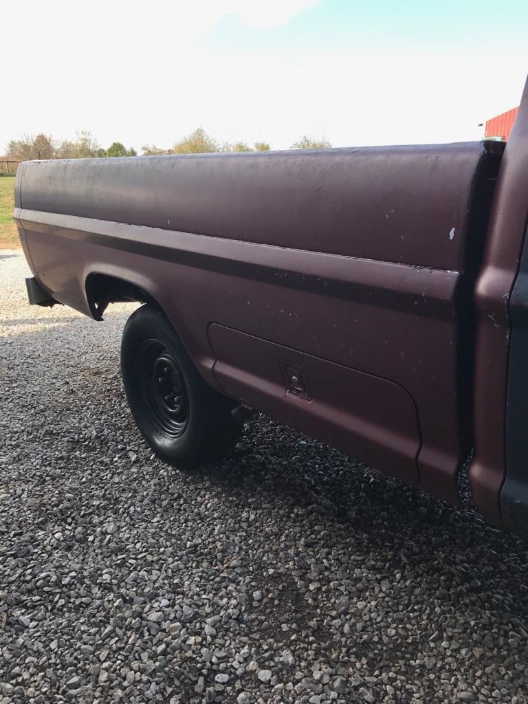

1968 or 1969 bed. I found this bed and bought it not realizing the 68/69 are different from the 70-72 bed. It will work fine and has the tool box (see other pic). I also found this other bed which has the chrome on it and has the light on the side see pic. Guy is asking 500.00 . I would like to use the bed I bought if a body shop can fix this bed to have the side light like the 72 had.
Old Nov 25, 2016 | 05:14 PM
F2501972's Avatar
F2501972
Joined: May 2014
Posts: 617
So do I sell the bed I bought and buy the white one above or do I keep the one I have and body shop fix so it has the side light?
Thanks -

Are the rear sections of your original bedsides in decent shape. If so a Body Shop can graft your end pieces with lights to the bed you bought.

The original bed is gone. Guy who bought it from Papaw took the bed to a scrap yard because the floor was gone where the extra gas tank sat. They put the utility bed on it. But if I can buy those end sections that would work great. The bed I bought (dark red/brown one) is in excellent condition. Where can I find those end sections? What are they called?

I have only seen the pieces to convert a 70-72 bed to a 67/69 bed that would cover the cut out. Not the other way around. You should ask your shop of choice about the conversion and if they say oh yeah we can do that "for a reasonable amount" keep what you have. If they say "well we can make it work but it will cost ya" be a little hesitant and list your current bed for sale and snag the white one. You may find after you dig into that white bed you need parts from both beds to make good one for your project.

67 to 72 long beds are the same f100 to f250 4x2 and 4x4 no differences at all. If the bed you bought is in good shape, use it. There isn't any reason you have to get the bed with the marker lights. That maroon bed looks good and you own it, go with that. Just my two cents, by the way nice truck and story.
