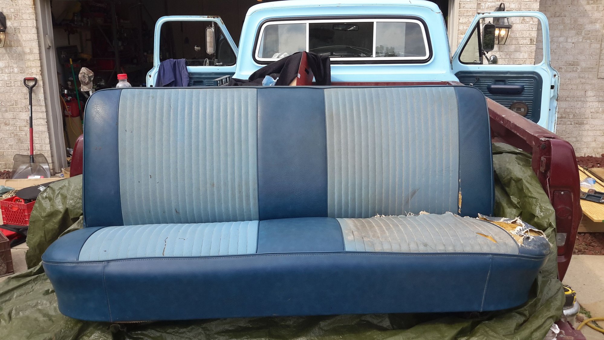

Guys, this is next on the list. I will post pics of the seat. I cleaned on it for hours and it looks pretty good. What would you guys do? Repair the seat? Recover the seat? This is a item on my check list that I will put some more money in or time. I'm ok with doing it myself if they make a high quality kit. But I think a good seat repair and keep original would be best.
Thoughts?

Old Jun 12, 2020 | 04:20 PM
  #913
orich's Avatar
orich
Joined: Aug 2003
Posts: 7,592
Likes: 10
From: **** hole San Jose ca.
My 71 f250 4wd seat had been repaired and a new cover vinyl pleated cover matching head liner before, I got the truck.
I did use the truck on an off road no hard rough off roading plus a lot of street hwy miles going camping etc. then put a 8.5' cab over camper.
My seat springs broke and got so bad poking through the stuffed rags, I kept stuffing in for padding. I scrounged for a number of yrs looking for a suitably replacement seat,
with not much luck for correct yrs. Then one day came across a nice 75 f100 with one of the beat seats in the number of yrs going to the pick n pulls junk yards.
I was driver in my car that day, so came back with my truck at which time had the camper on it. I went back into PnP got the seat got a guy to help me put it in the camper floor.
That was one of those days of feeling a happy score day... A number of yrs pasted and started replacing window seals etc. that's when, I ordered a oem seat cover from LMC (which is the only thing that did not need replacing with in 5yrs.) Beware of any rubber products as they are short lived from the ozone. I sure hated having to do all the rubber over even cab cushion's failed.
So good luck finding a replacement seat. Or have a guy rebuilt it who knows what he's doing.
Orich
Old Jun 13, 2020 | 11:12 AM
  #914
bajafishnut's Avatar
bajafishnut
Joined: Nov 2005
Posts: 2,694
Likes: 45
From: La Ribera, Baja, Mexico
I have to weigh in on Orich's side, have it recovered by a pro, and the foam replaced, as well as new, or better springs, as the old ones have probably lost some of their support. Materials can be better now days, but you must be selective to get good quality. So much cheap Chinese crap these days, that look good, but do not last. Since my truck is retired in Baja, with me, I had a local upholstery lady refinish my bucket seats, and while not original, they let me put a cooler between them, which I find very handy.
I like your idea of keeping it original, I vote for that, with new material, done in the same pattern..

Baja, I'm in agreement with both you and Orich. Great tip on the springs as well. It's good that you give your cooler a good place to ride LOL. Keep on rockin
