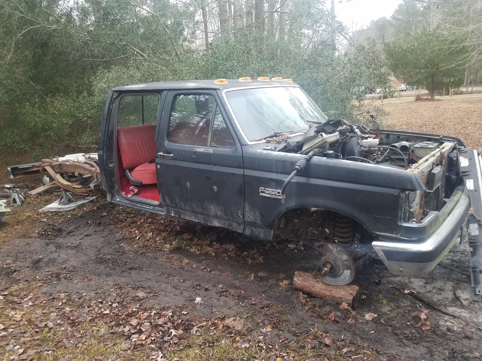

​​​​​​Had big plans for the weekend.... instead ended up pulling parts off this and making a little .ore money off it. Pulled and sold the driver side door and fender, also sold the rear retractable lap belts off it. So we did a little adding up on it.
bought for $200, pulled the engine and engine mounts($140) to use.
Sold: Hubs/wheels $160, Rear axle $150, fender/door $100, hood $40, seat belts $25. And traded some stuff for a set of Headers.
So added all up I have made just over 400 on it after purchase price. Plus got a engine and set of headers out of it.
Is that sliding rear window in good shape? How about the air filter housing?

I'll have to look at the back glass, but I think it was. I think air filter housing is complete and in decent shape aswell.

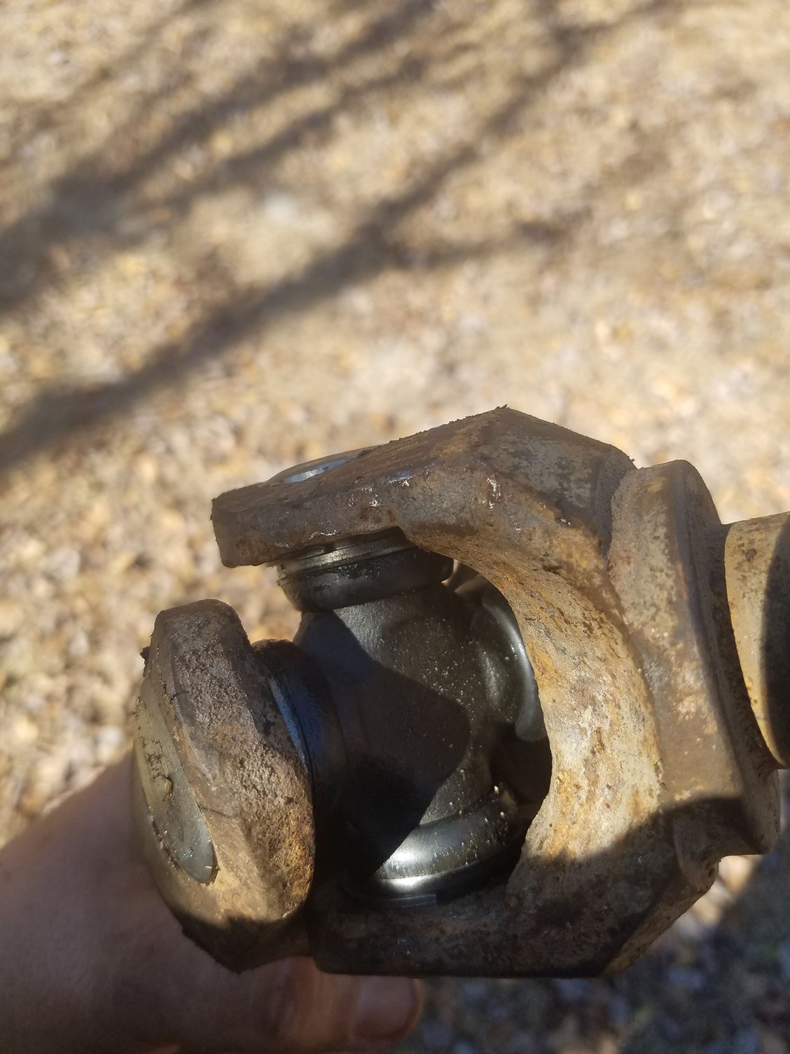

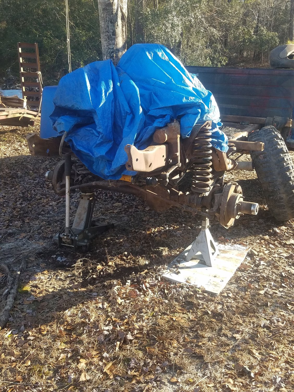

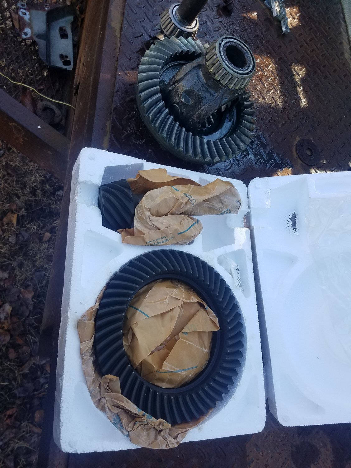

So I did a little more to the truck...
Decided to try something different and swapped just the front ratio, should turn the front about 10mph faster at WOT. Also pit in another set of Super joints in the axles while I had it apart. I also pit on another set of hubs that I had, so I've got functioning hubs again.

Nice work.
On the gear swap same size tire front & rear or different sizes?
The gear swap I take it is to help the front pull straight thru the mud?
I know for sand drags/mud racing the gear difference is not a big deal just wanted to know is all.
Did Ford make a full time locked hub?
For racing it is best to go full time locking type as they are stronger and should not blow apart like the un-locking type like to do.

38.5x11 front, 38.5x15 rear. Yea the idea is the front pulls you through the mud, which in turn makes it easier to handle.
I had a old worn out set of hubs on it that I talk welded the pieces together and slid back into the alum housing. The passenger side is still that way, but the driverside has a functioning hub incase. That way if I break something in the front I can atleast move it around unlocked.
