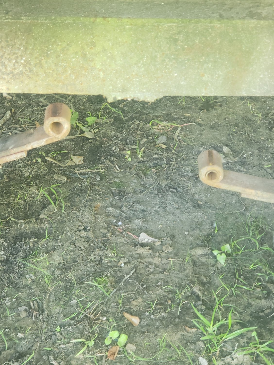

Well did a little work Monday, new exhaust hanger on my 01, new winch switch on the 800, tinkered with Ol blue a little.... unfortunately looking like the head is going to have to come off the driverside now 🤦‍♂️
Then moved over to the trailer, got to do a wheel bearing because I was careless and didn't pay attention to the dust cap going missing which resulted in a dirty/dry bearing. So while taking that apart I realized it also had very worn out equalizers on on the leaf springs. So I ordered new wheel bearings, dust caps, and new equalizers/shackles/bolts for the suspension.
I didn't notice the equalizer due to it being tucked up in the hanger until I jacked up the trailer. Needless to say it was way past time to replace it.

John, I have a ez-up don't remember the size now, if you want to brow it. a little shade is a lot better than working out in the sun.
Let me know and I can drop it off one day.
Larry, you found that just in time.
Wonder if you drill and install a grease fitting if that would help?
Many years ago I had to do shackles and bolts on my car trailer but the center pivot was good.
I need to check mine the next time I do the wheel bearings.
Dave ----
I'm not sure if it would form not, I saw some bolts with grease fittings for the shackles. But they all seemed to be for like 1-2000 pound trailers. This trailer is a 14k pound trailer... so didn't want to chance it.
At first I was also thinking of the bolts with the fittings and then just like you not strong enough.
That is why I was thinking if you drilled and tapped a hole in the pivot (the part you pictured) for the grease fitting you could get grease in there and not hurt how strong the part is.
I don't think there is much you could do for the shackles / links where they ride on the bolts because they are so thin or the spring & bolt but I have not seen that bolt wear like the ones with the shackles.
Dave ----

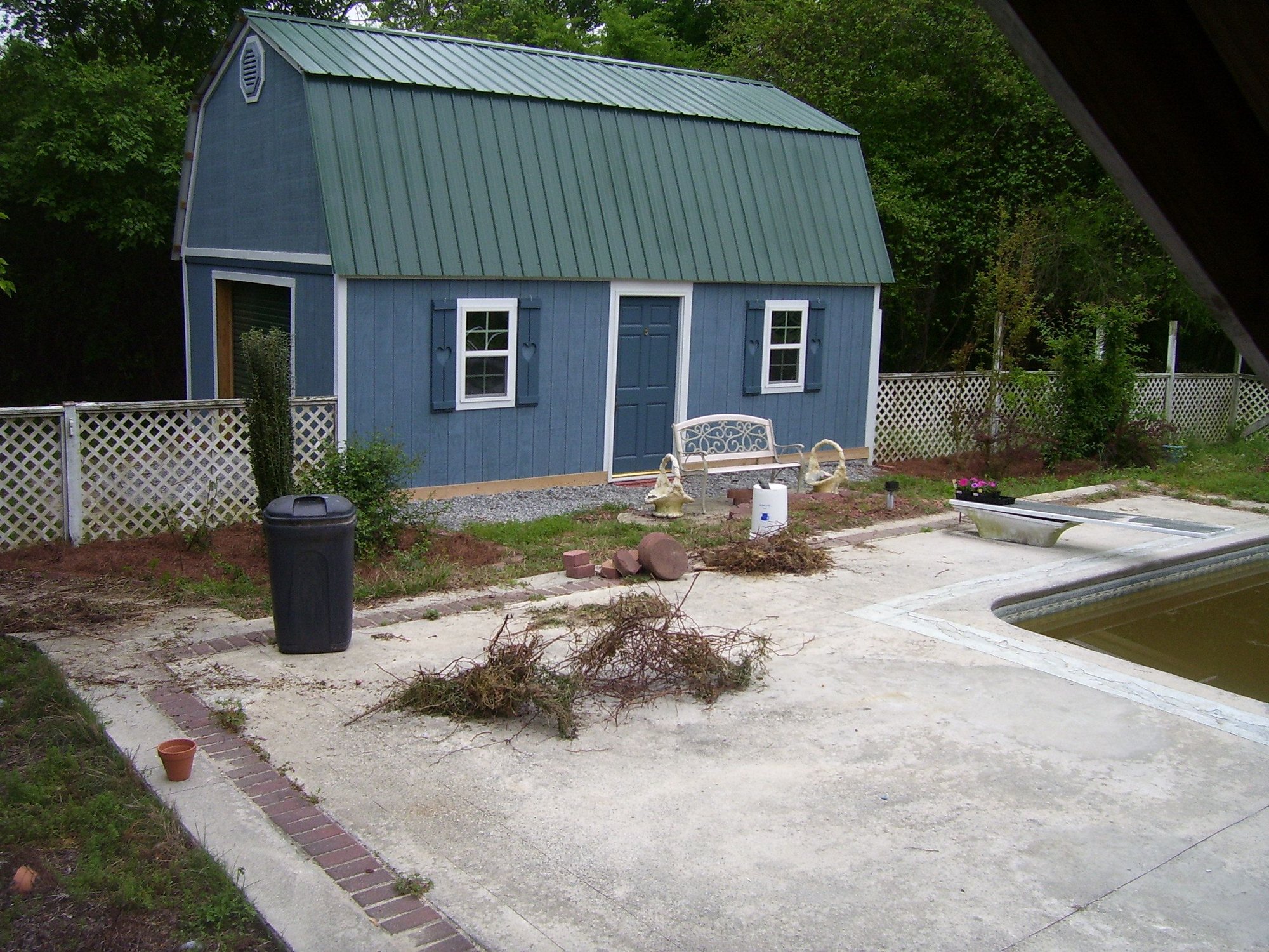

I built myself a little workshop a few years back. This was the last spot I had on my property. I have 1 acre, swimming pool in the back yard, then my leech field. In the front yard, I have to maintain a "repair" area for the leech field, in case it ever fails, not that I would want to build something in my front yard anyway. Across the road from me is the end of a farmers field and the pole shed where he parks his equipment, I would love it if he cut off 1 acre and sold that to me, then I could build a shop across the road - our driveways even pretty much line up.
I can't find a recent picture, this is from 2014 when I was still in the process of building it. It is big enough for 1 small car - currently has a Chevy LUV in it.

Got to work on the trailer today. Replacing the equalizers and shackles. Fund that one of the hangers were cracked also so had to weld it back on. Also got that wheel bearing replaced. Should be ready to go now for next weekend hopefully.
