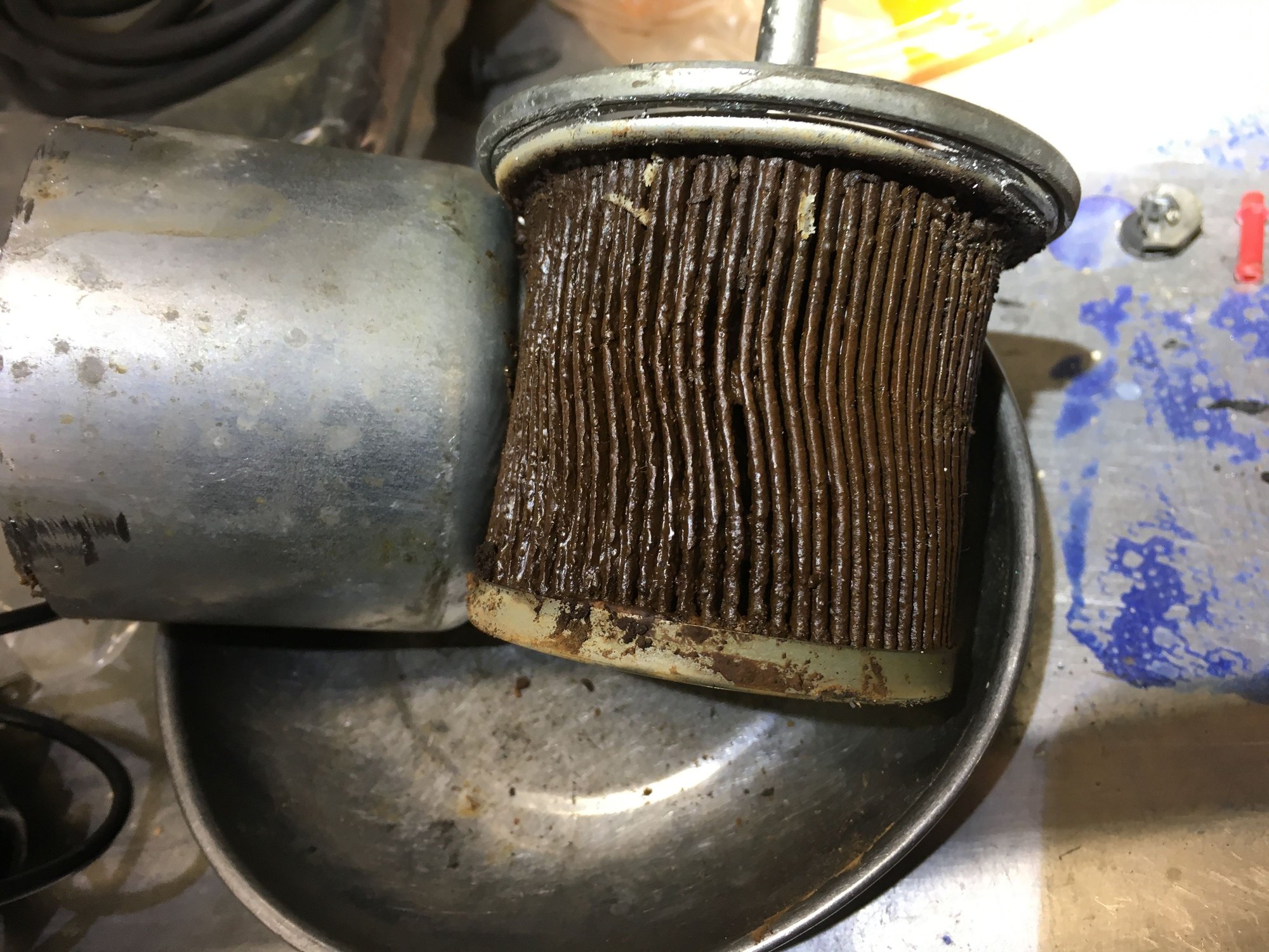

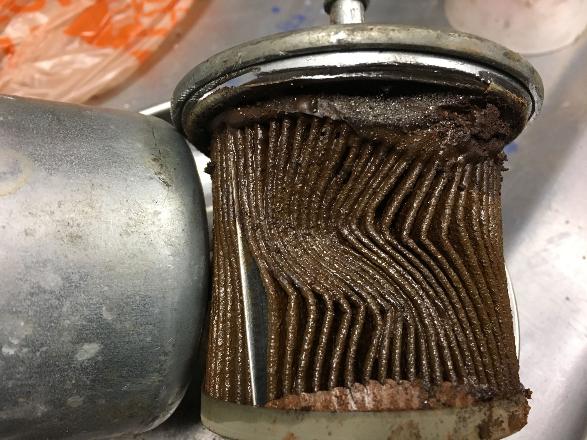

Think I may have a larger issue than clogged injectors.

That filter is pretty damn bad too... I wonder what the inside of the tank looks like.

I’m going to replace it again in a month or so to see how bad it’s gotten. If bad enough I will replace the tank. The rear one is the one I’m concerned with.

It looks like things are growing in the tank(s).
If you replace them do not reuse the fuel as the growth will come over in the fuel.
They do make an additive you can add to the fuel to kill it but I have never had any luck with it in a home heating oil tank.

Like a biocide?
