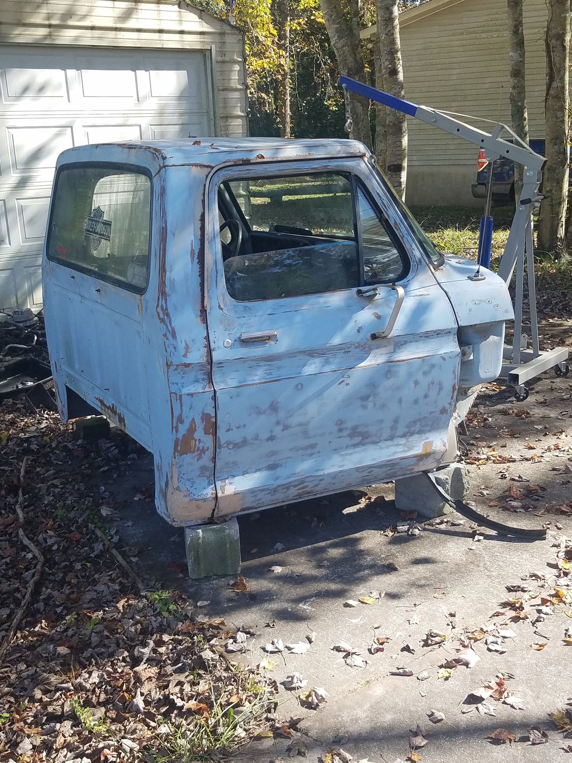

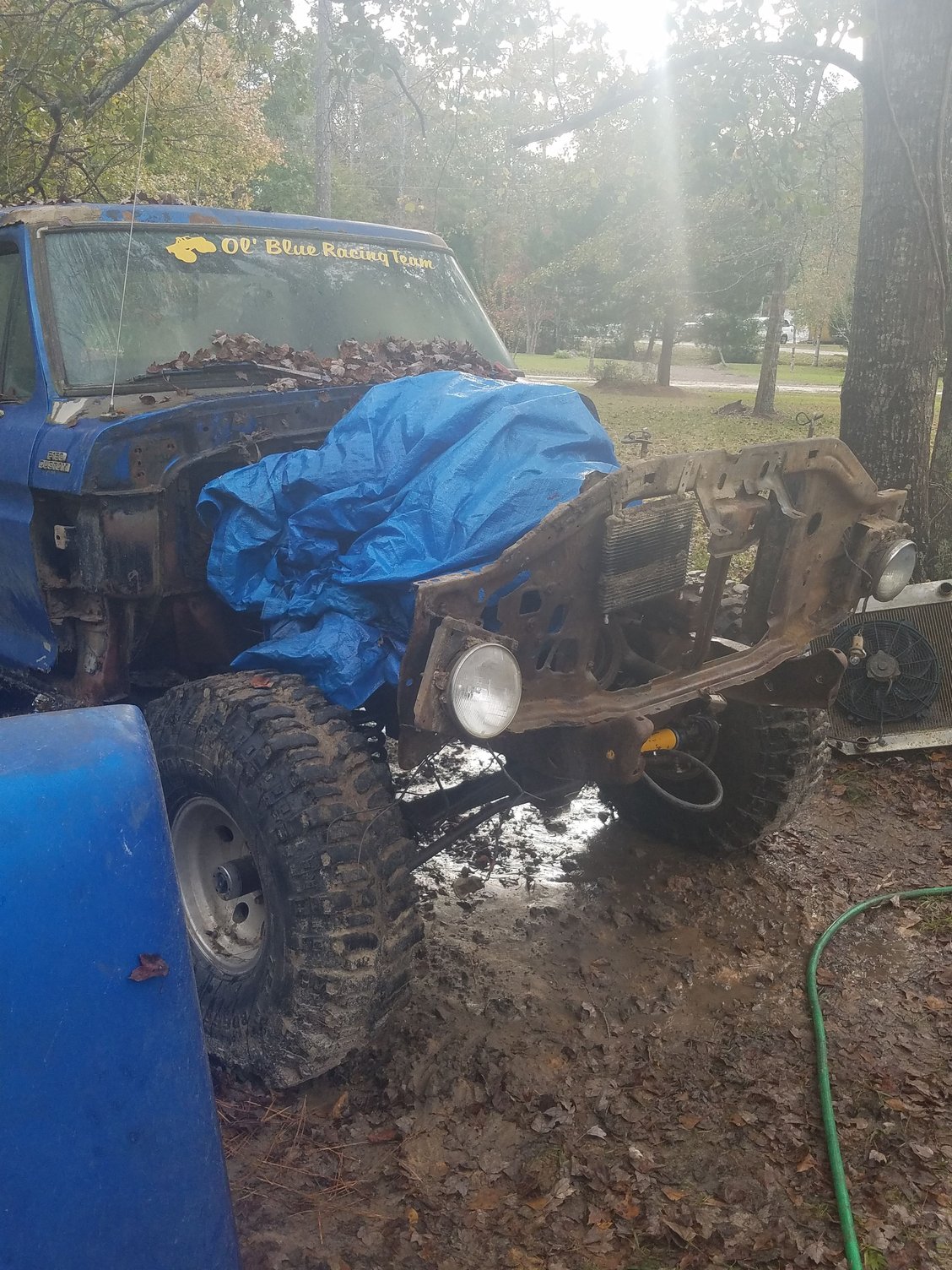

Then I moved on to working on my Cab swap. I got the donor cab off the frame, and did a little more dismantling on Ol' Blue.
I guess that explains the oxygen sensor trouble!
