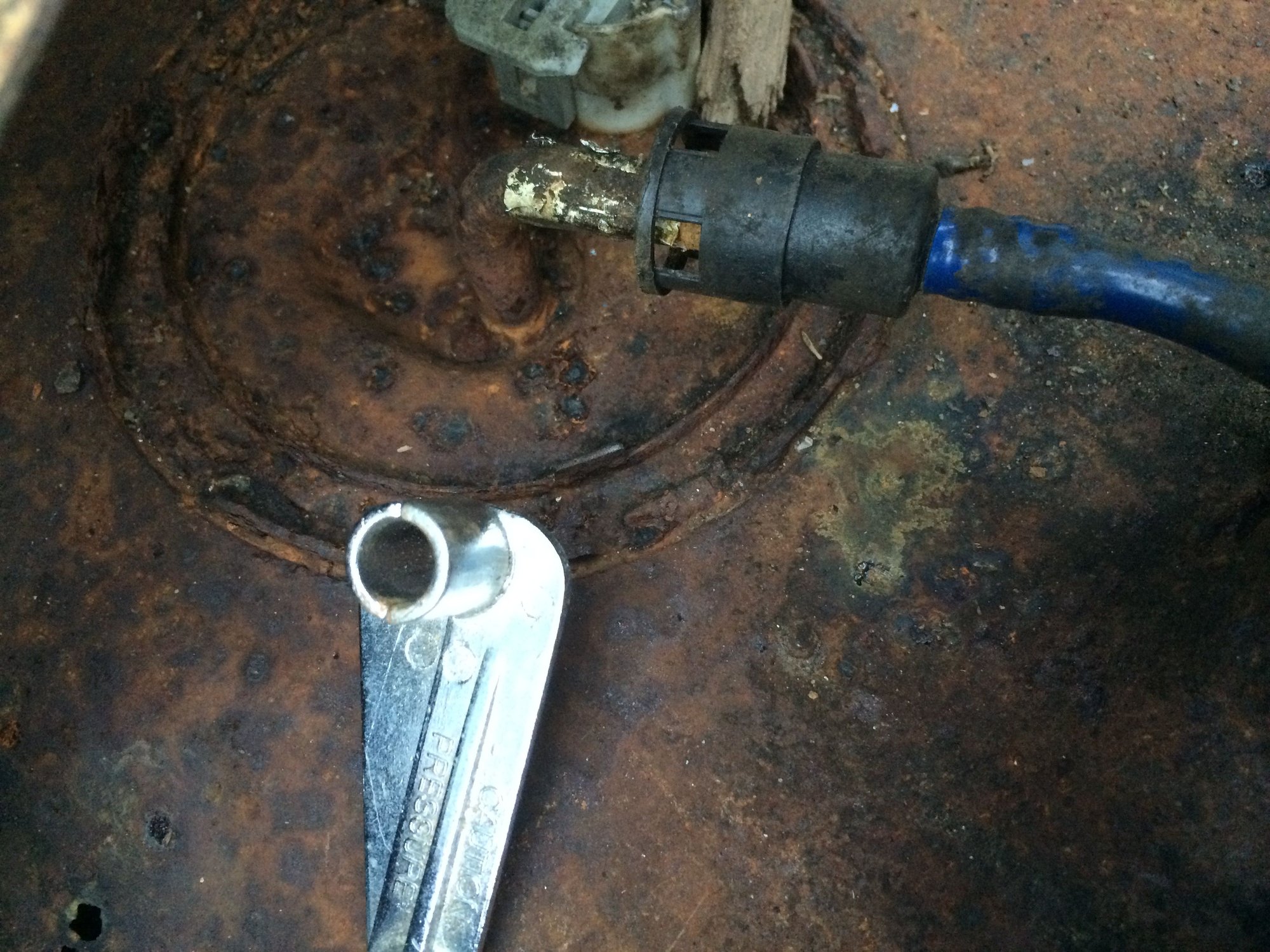

Dave come by and check it out, I'm normally around in the afternoons. I don't think we exchanged #'s at the last dinner, so take mine down and text me. 910-two-three-two-5838. Meanwhile, any advice on this quick-connect setup? I can't get it to release. Doesn't help that I don't know what I am doing, last vehicle I had that used this setup was a 1996 Windstar and I traded it in back in 2003, so it's been a while since I had to figure this out.

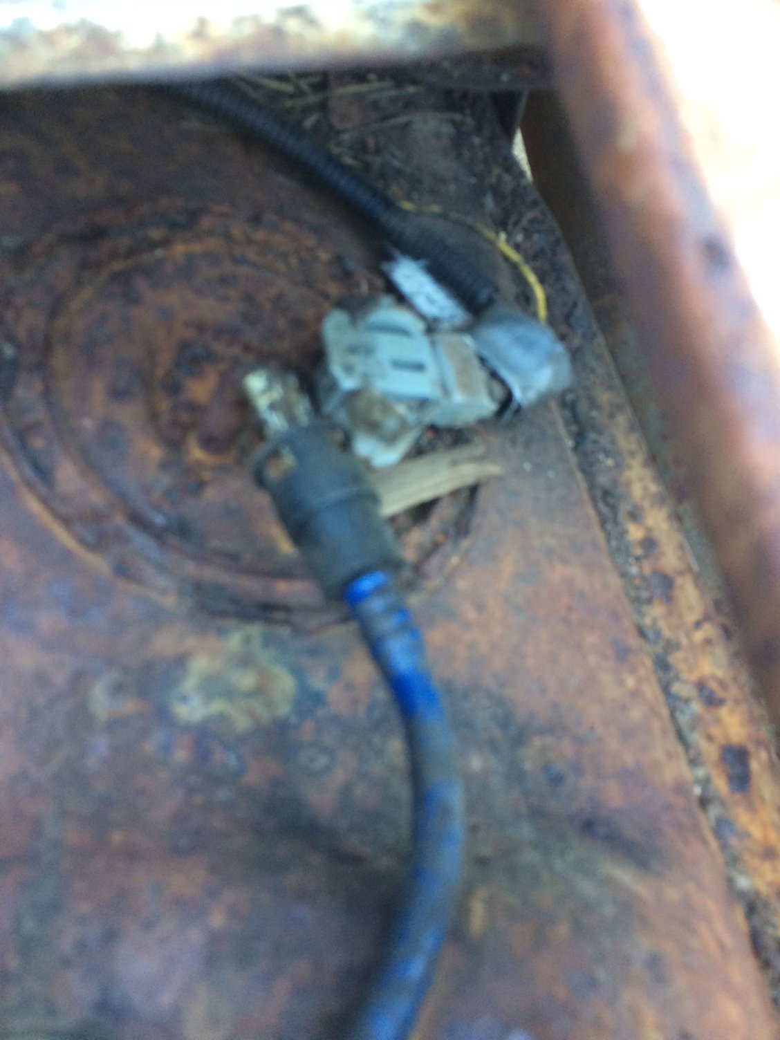

that blue and black one looks like its the squeeze lock connection... you just squeeze the outer casing and it releases the other line from inside it... looks like someone in the past has busted the casing on the tank side fitting or they busted off the tabs on the inside of the fuel line side.. cant tell from the pic if the white stuff there is the remnants of the white plastic connector clip for the tank side or if its just the paper tag they sometimes left on to tell you which hose to connect to...
the springlock tool you got there in the bottom of the pic is more for this style of fitting.. but can sometimes be used with a different style...
theres technically 3 types ive seen of the quick releases since they quit using the screw style fittings... (which i loved those over these newer things)... You have the spring lock pictured above used mostly in pressurized systems... Then theres the plastic squeeze and release style ive seen on alot of GM's (connectors shaped ovallish and grips onto the other half of the connection by its rounded lip sticking through the cut out openings... you just squeeze on the connector to make it round and it releases from the other line) and then you got these new ones with the internal clips that either need to be pulled or are squeezed like the newer electrical connectors or require the use of the spring lock tool... always fun trying to figure out which way they go with that last one...
for me i always hate dealing with the spring lock styles... it always feels like im trying to break the line to get them to release...

That truck is not from around here, it's seen salt/brine somewhere for sure. If that connection is what I think it is, just yank on it, the hairpin clip is already off.

Shawn, I saw those round style clip tools on a youtube video. But I knew had this release tool in my garage somewhere and finally found it. I know I did not take a good enough to see what the white thing is, but going from memory I think that where the vent tube connects. I'll have to look again.
Dustin the guy that previously owned this truck lived in Wilmington. I really don't think it's salt / brine I think it's the remnants of the truck bed rusting away that's taken everything underneath with it. That gas tank has rust holes on top.

They do make repair connectors for that plastic line. On the fitting , it looks like the retainer clip is gone but, make sure there are not any pieces left underneath.

I got the connector off doing what Shawn said. Although I could not squeeze it by hand, hand to use pliers. It slide right off after that.
Here you can see the white connector better, it is for the float, going to the fuel gauge.
Connector slid right off when I squeezed the black part with pliers. Thanks for the tip Shawn.
