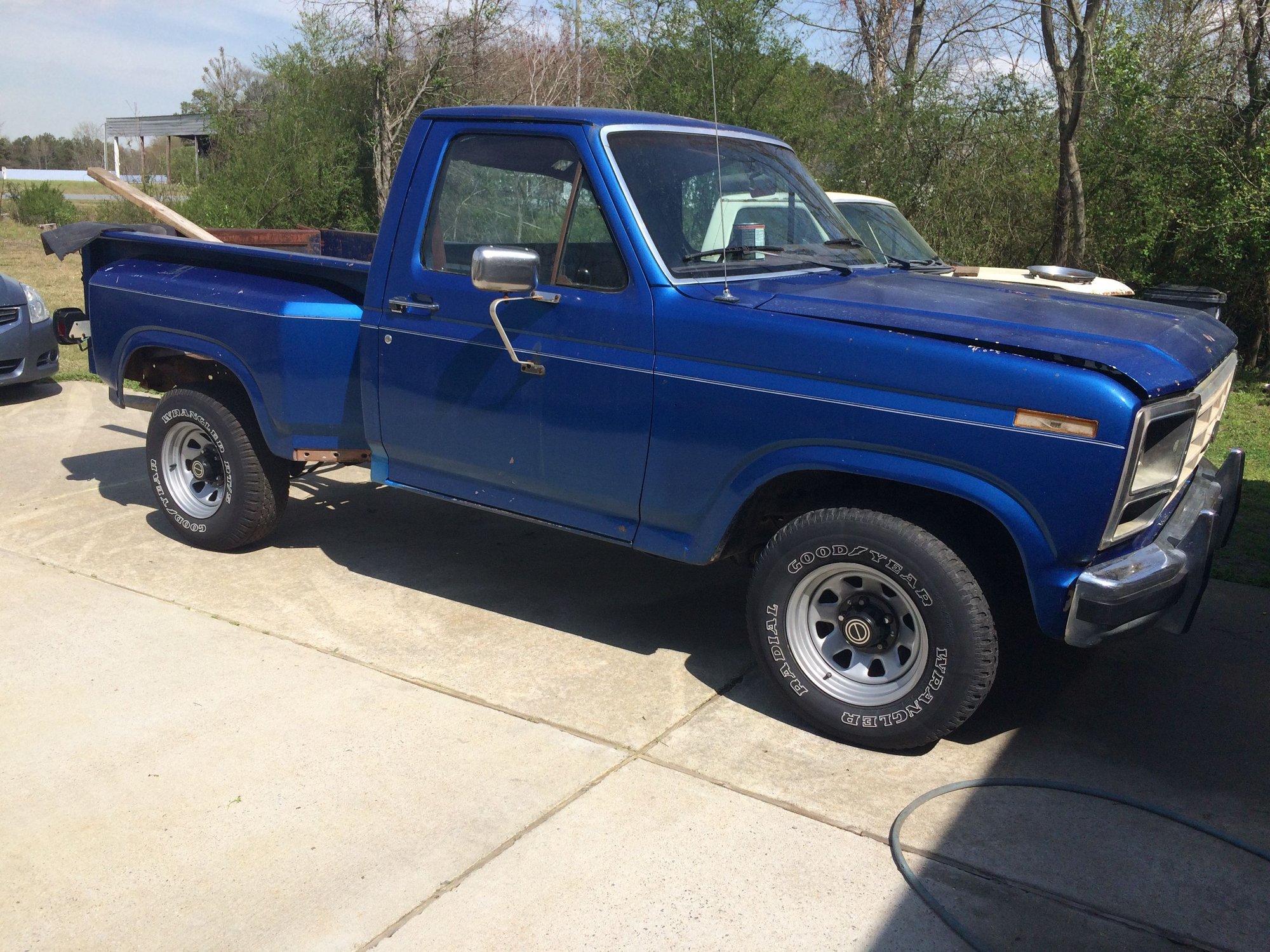

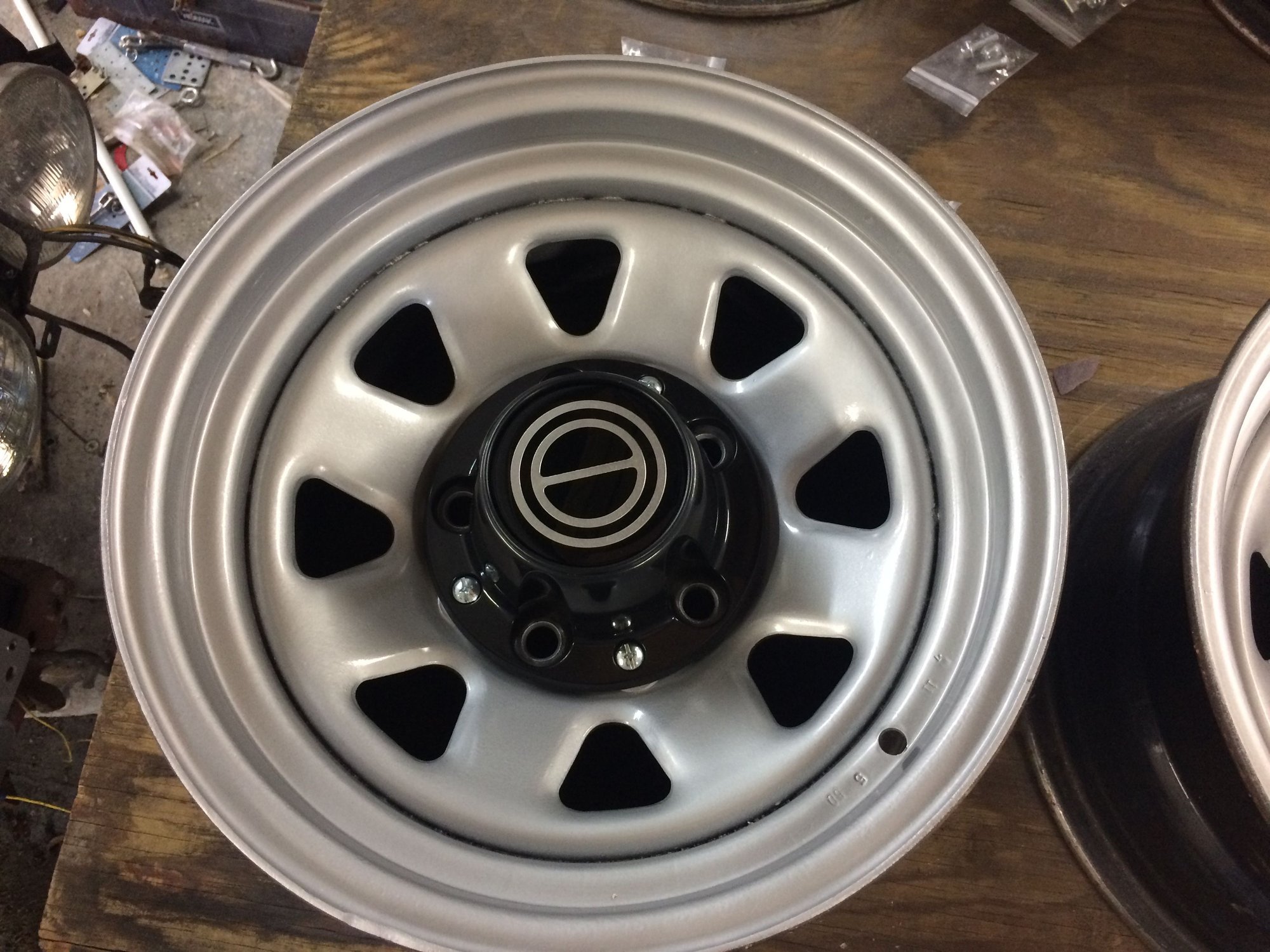

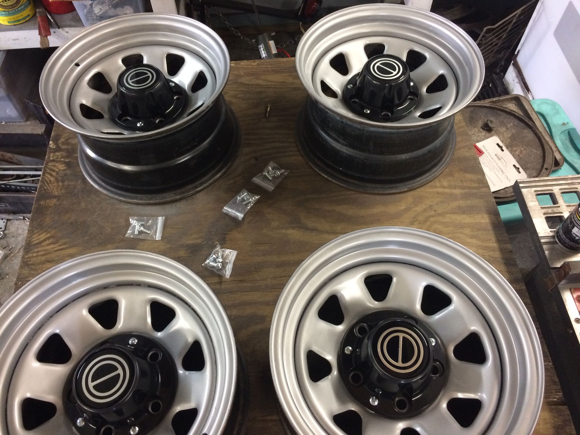

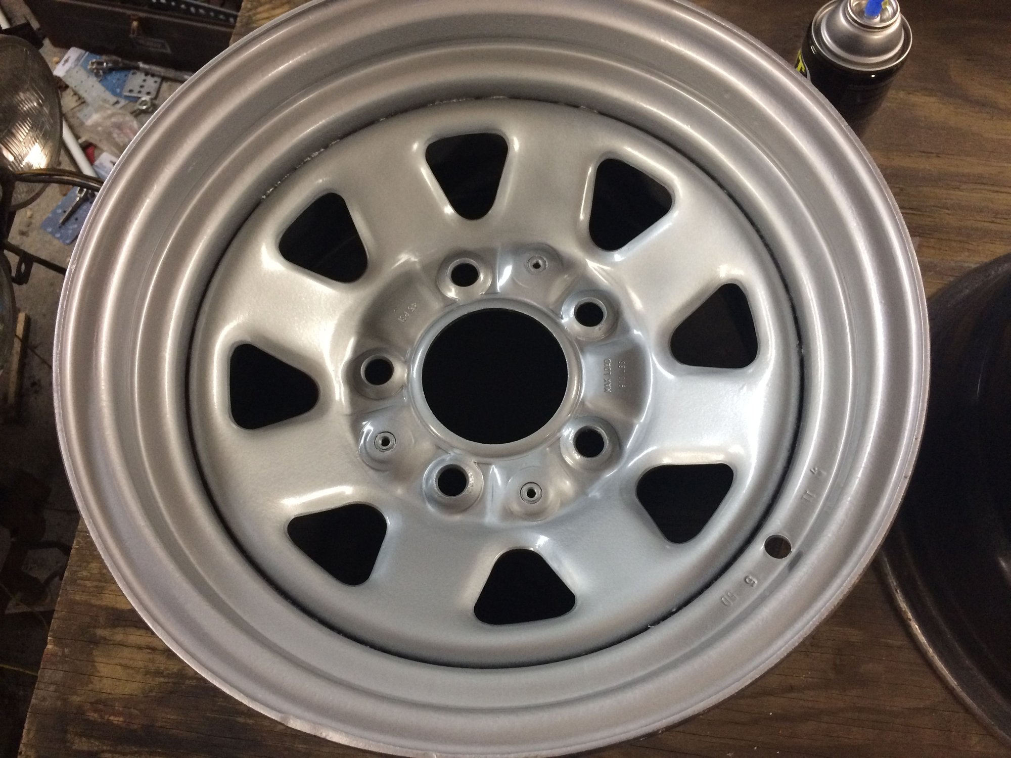

I finished cleaning & painting the rims, mounted the center caps, then I had some old tires mounted on them so I could put them on the truck. This is the look I was going for!
Freshly painted, maybe a few drips & sags..
New black plastic center caps
All four finished
Mounted on the truck!
Two of the tires from the parts truck, the other two were on the rims when I bought them. All are dry rotted and not good for the road, but should be fine "rollers" in the meantime.
