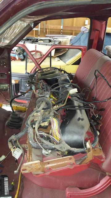

On the wiring in the blue truck I would not even spend any time with it.
You can pull that dash and wiring out as a whole. Do the same on the white parts truck and swap it into the blue one.
I did just this on mine and it worked great.
You will kill 2 birds at once, good wiring and the blue dash assy, in a blue truck not that red stuff.
The only thing I see needing to do with the wiring is for the motor is maybe extend or shorten some wires, oil & temp, as the IGN wires should be ok.
The speed control part will also come over too when done this way.
When you pull the 300 motor don't cut any of the wires and try and mark them, maybe keep the ALT as that should fit the 302 and all the charge wiring should match up.
When time comes to pull the dashes give me a call and I will come by to help if I can. Again I think it was easy when I did mine.
Dash and wiring from parts truck and how it went back into mine.

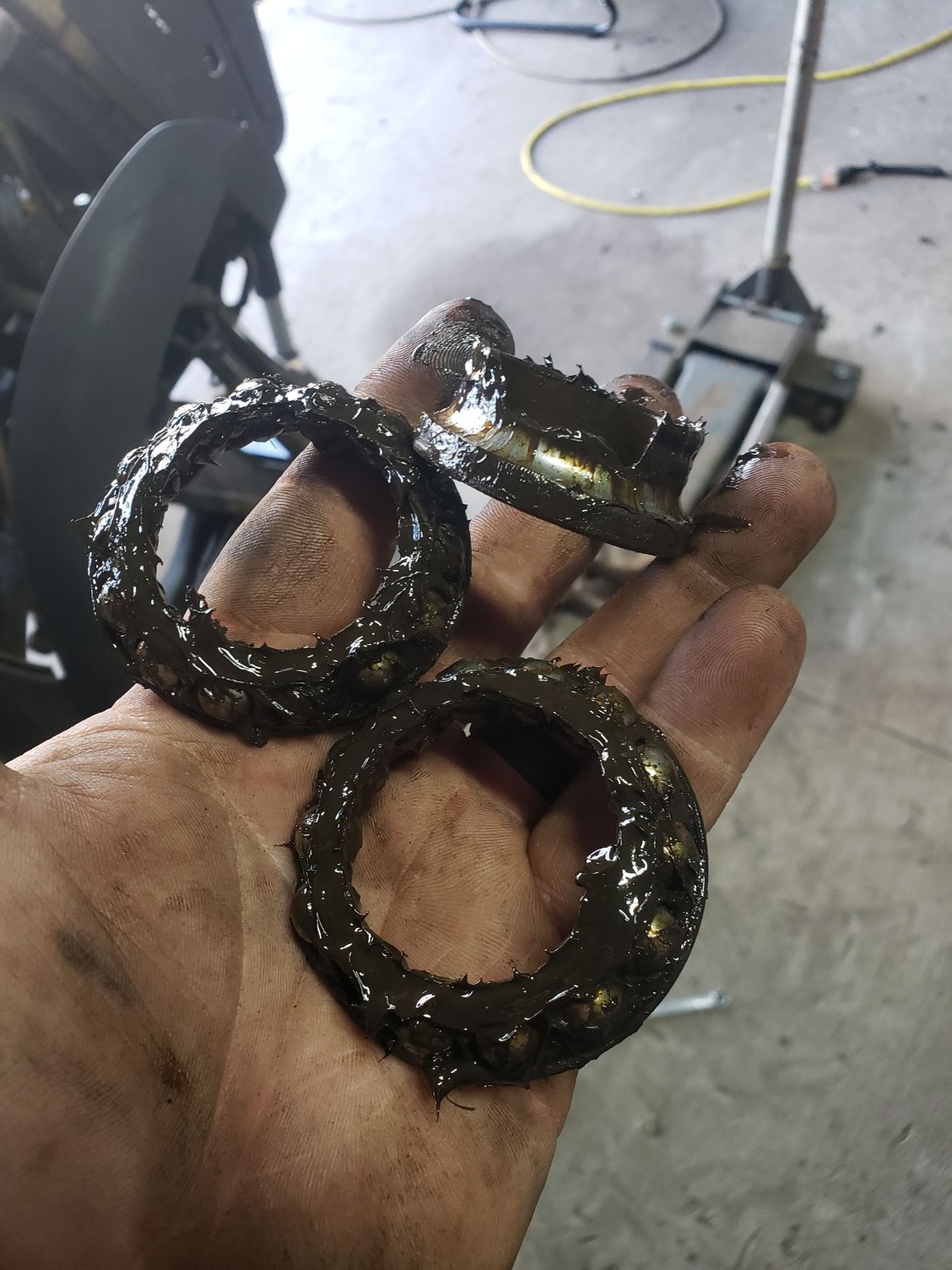

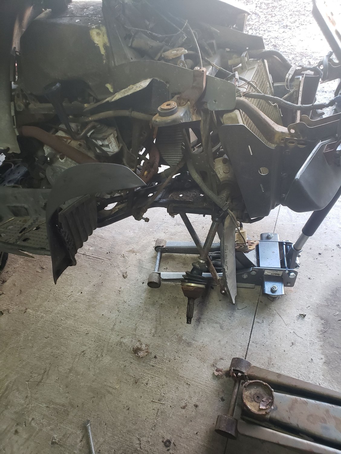

I did a little work on Ol' Blue this weekend, but once again it was cut short due to finding .ore broken stuff.... seems to be the story of my life lately. I did get the new rocker arm studs installed, but found I had a cracked pushrod guide plate, probably wouldn't of been a problem, but I'm not taking any more chances.
So I switched to working on the four wheeler, the front wheel bearings needed to be changed on it so I stripped it down to change those. Needless to say the old bearing were shot.... they're 1 piece bearings and the left side came out in 5 pieces.
I got the suspension pretty much back together, I just need to get some new rubber spacers for the top of the struts, and 2 new tie rods.

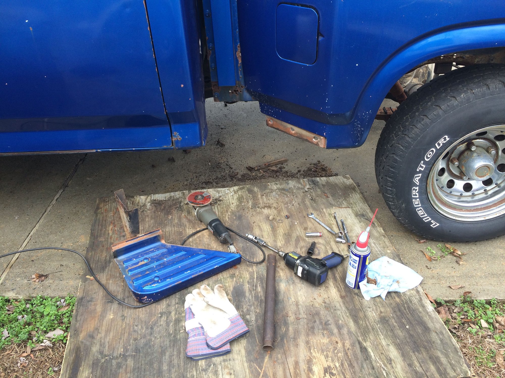

This bugger represents about 1-1/2 hours of work to remove! Don't you love trying to get off rusted carriage bolts? *note* That timeframe also includes unbolting the front crossmember from the bedsides, which was at least half of the time I spent out there on my back getting WD-40 on my face and rust in my eyes.
