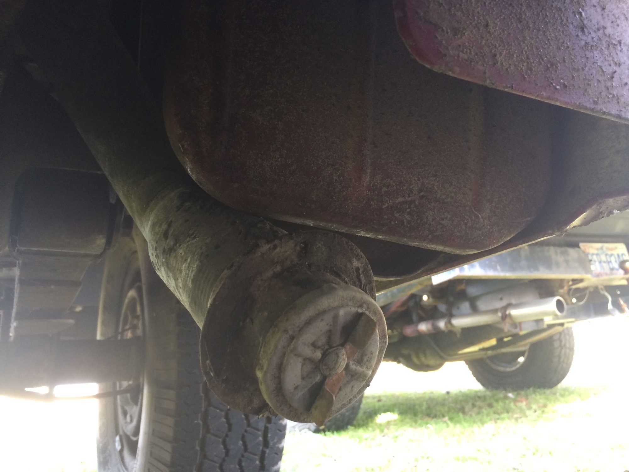

Dropped the tank on my new 83 F-100 project, what a mess. Rust holes in the top, and the parts truck - well damn I removed all the gas from the tank, through the fuel line, and then went to add some fresh gas to it so I could run the I-6 motor, and guess what. No way to add fuel to the tank! When the PO put that 95 bed on it, the filler tube is in a different location, so he just bent the hose to a 90 degree angle, reinstalled the cap, and let it hang down under the truck!

John, I used a small 2 gal. jug under the hood set up on the inner fender well and a long rubber hose from it to the pump.
I did not want to put gas in the tanks because I did not know how long before I got the truck on the road and the gas fo go bad.
Dave ----

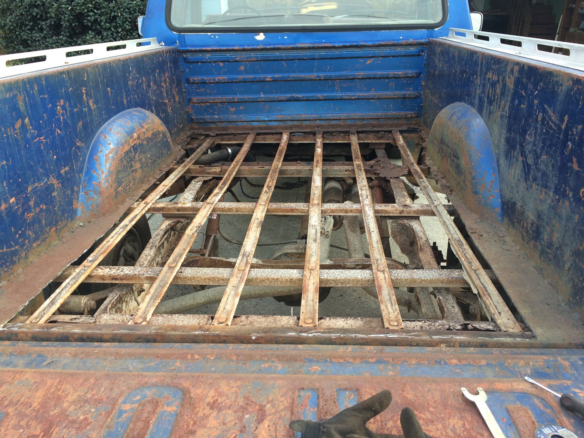

Spent the afternoon cutting out the bed floor of this 83 stepside. I'm going to have to replace at least 3 of the horizontal braces. I have no idea how this bed was held together, only had 4 bolts, none of which were tightened, and they were just going through the rusted old sheetmetal, nothing substantial!
Just throw down thin sheet metal on top of the existing structure and tack weld it down?
At least now I can see what needs to be done. But that's enough rusty metal sparks in my face for one day.

The way you cut the metal floor from the sides what if you were to remove the sides and trimmed the floor so it left a lip for the bolts?
This way you would not need to get other metal to make the lip.
Dave ----
I'm not 100% sure I'm following you. It sounds like you mean to bend the sides inwards to create a lip? But if I did that it would higher than it normally should right?

John, Think he means to cut the bed an inch or two from the sides so that you have a lip to bolt to. Do you have your glasses on?

Yes you went front to rear in a straight line down both sides on the metal floor leaving a W I D E lip. Just trim that lip back leaving an inch or little more following the contour of the bed sides. Then no need to come up with metal and weld it on. You may need to do a little welding if the welds on what is left is not too good.
