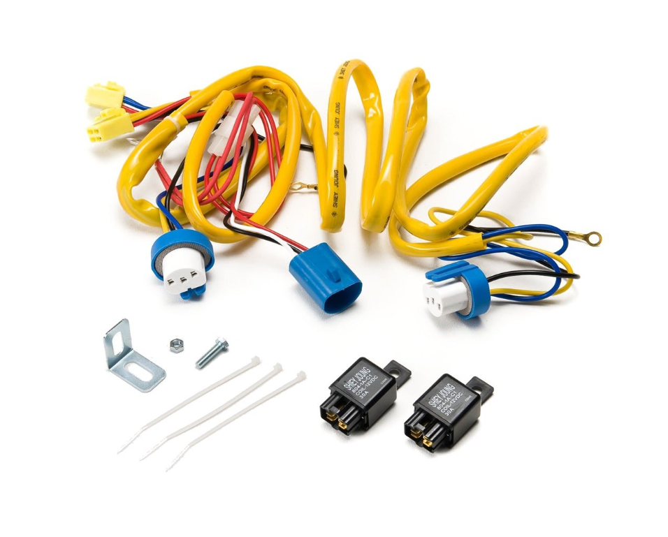

Marty, here is the one I am looking at.
Old Dec 10, 2019 | 05:38 AM
  #2527
FordTruckfan89's Avatar
FordTruckfan89
Joined: May 2013
Posts: 1,256
From: NC
That's similar to the harness I made for mine. Only thing I didn't like about those is the odd relays, no fuses and some reviews said they had a hard time stretching to reach both lights. I love mine, headlights arent anything special, but it does help them.
