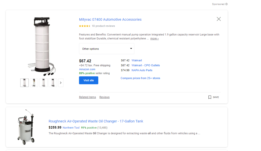

Originally Posted by Benztechnc
Hey John, I have a few of the professional ones laying around. One will even use shop air and a venturi style vacuum if you want to borrow it.
Just let me know.
Well I already finished my oil change, and the new one I ordered off ebay came in yesterday. But I'd love to see a pic of a professional one, just to know what I'm missing. And so that I might borrow it next time!

Something like these. I have both styles around here.
It's a little bit more than you might probably need for most DIY stuff.
Oh yeah, those are more than I'd need. This is the one I just bought, it holds 2 gallons (or actually 2.1 I think it says)
