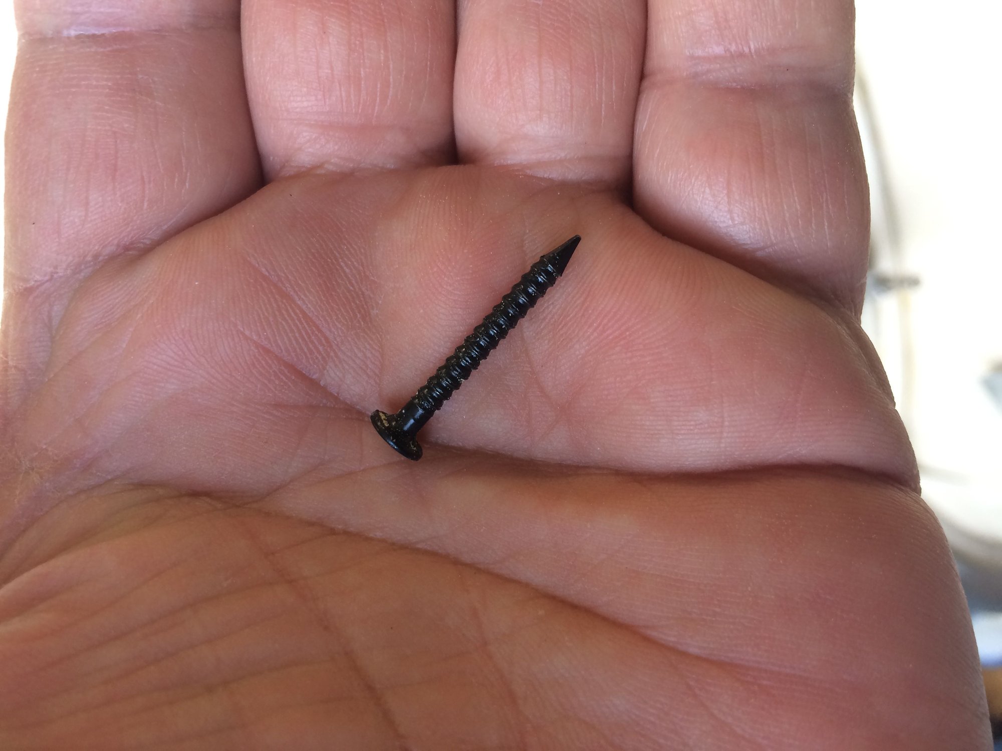

I just checked their facebook page and no pics posted yet. Meanwhile look what I found in the driveway while bringing the trash can to the road; the elusive trim tack that fell out of the box while Dave and I were digging through it, and searched for for 5 minutes straight!
At least it wasn't found by a tire!
