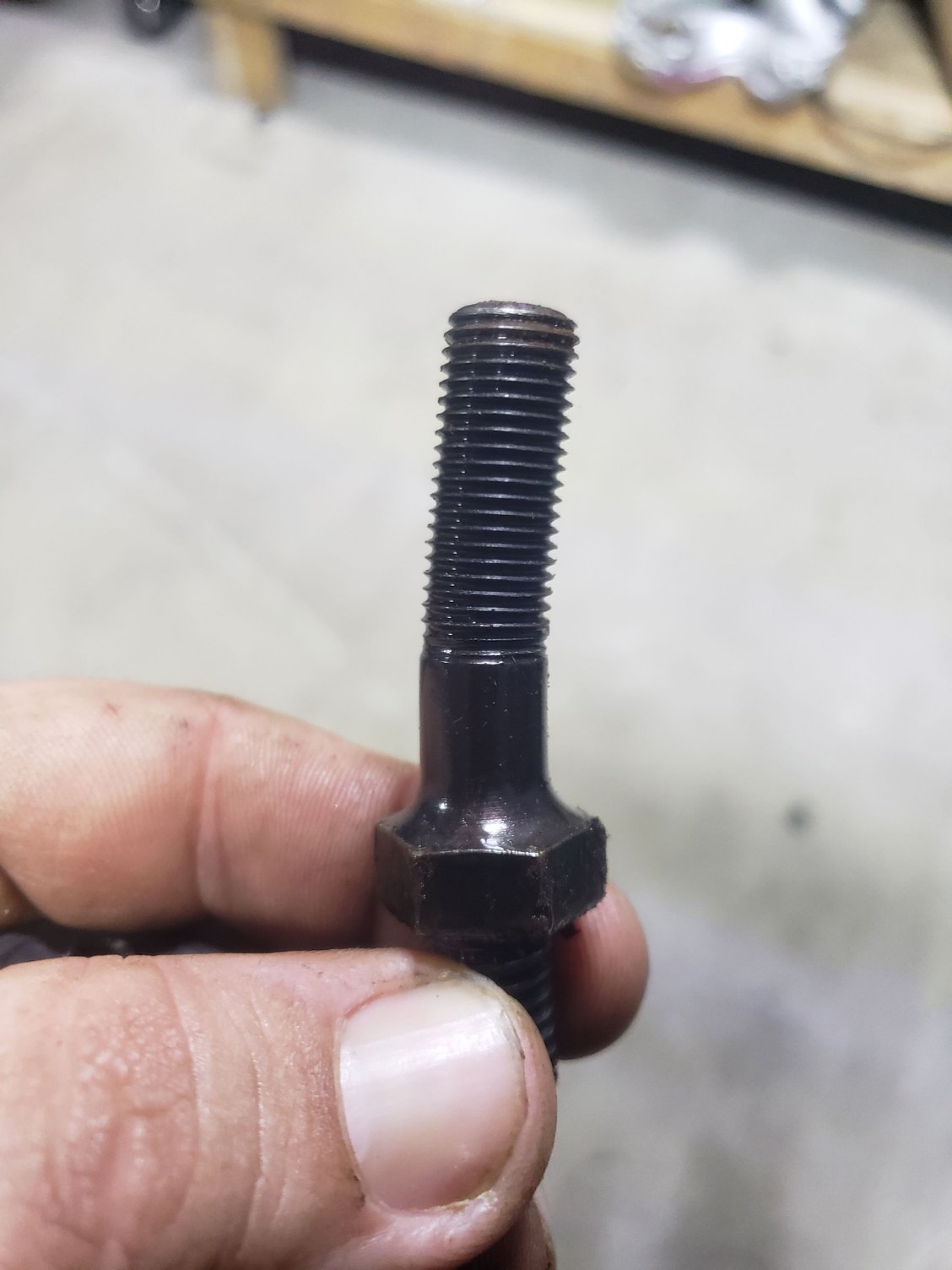

Did a little work Monday to the truck. Got the head back on, and the timing chain and back on. Got to order a few parts, I'm gonna put stud girdles on it to hopefully keep everything happy.
And the can gear with the new double pins.
Oh and the reason I need stud girdles....

Holy crap, bent that ARP rocker arm stud?!

3 of them to be exact.... 👀
The springs have about 950 pounds at full compression...

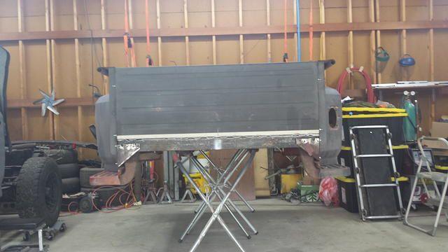

On the bed side panels, you cant get them and if you find used ones they maybe just as bad as what you have.
Because they bolt to the wood and the wood stays wet the bolting lip rots away and now you have nothing to bolt the sides down with.

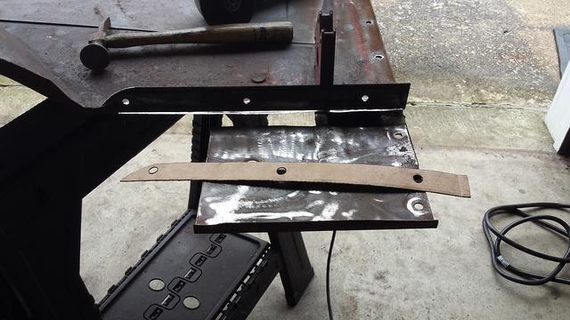

I was able to make patterns from what I had left of the lip to make cardboard patterns and used them on flat stock to make new lips and welded the lips to the side panels.
I may still have the card board patterns somewhere on the bench.
That panel that cardboard is on should also have a lip that fits under the bolt lip.
Because no one will see this from either side (fender covers most of the outside) I just made it flat and welded it to the bottom edge of the bolt lip.

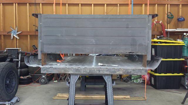

Because the cross braces and sills were to much $$ I went with a metal ribbed floor from my parts truck and used what was left of the rear sill and the step braces.
Long bed ribbed metal floor trimming to fit

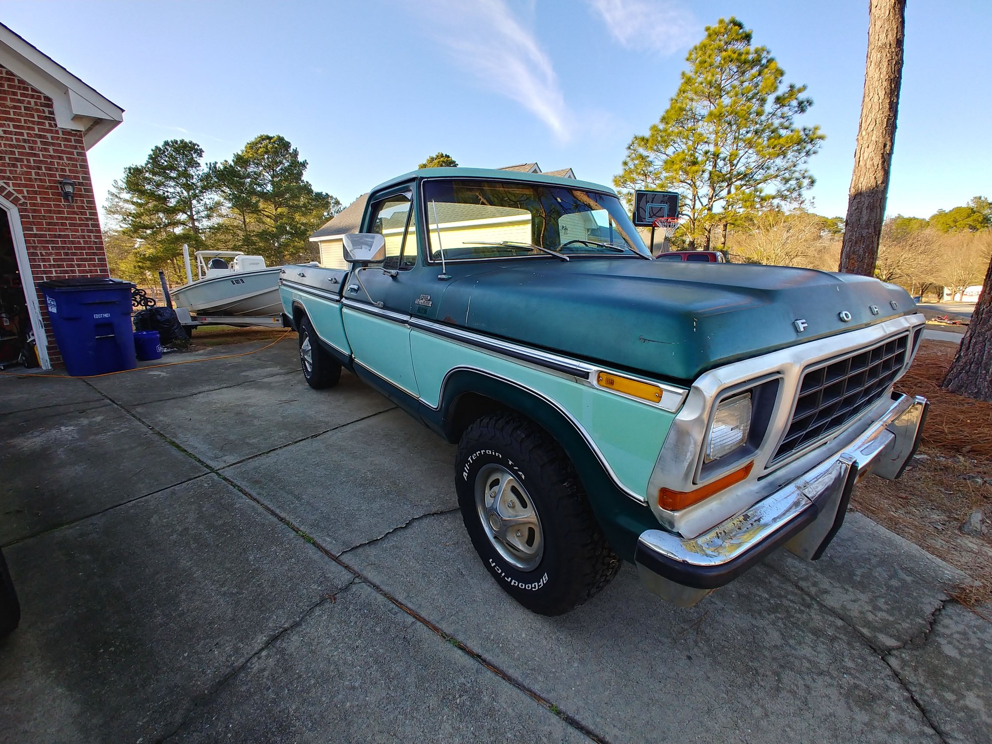

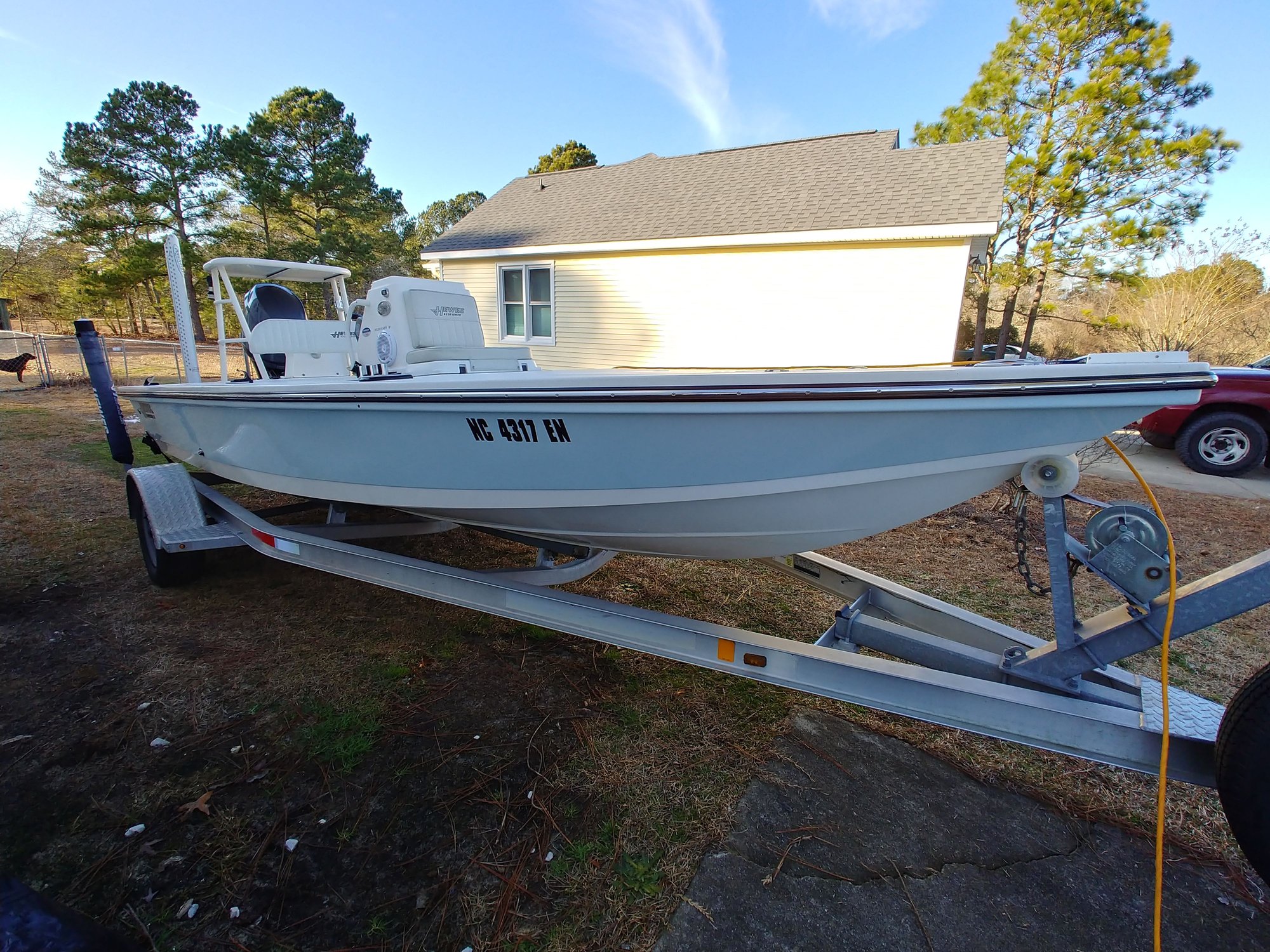

Put the truck to a little bit of a test today. Towed my new boat over an hour to the lake and back of course. Uncle Jesse did awesome!
My new sled. 2013 Hewes Redfisher 18.
