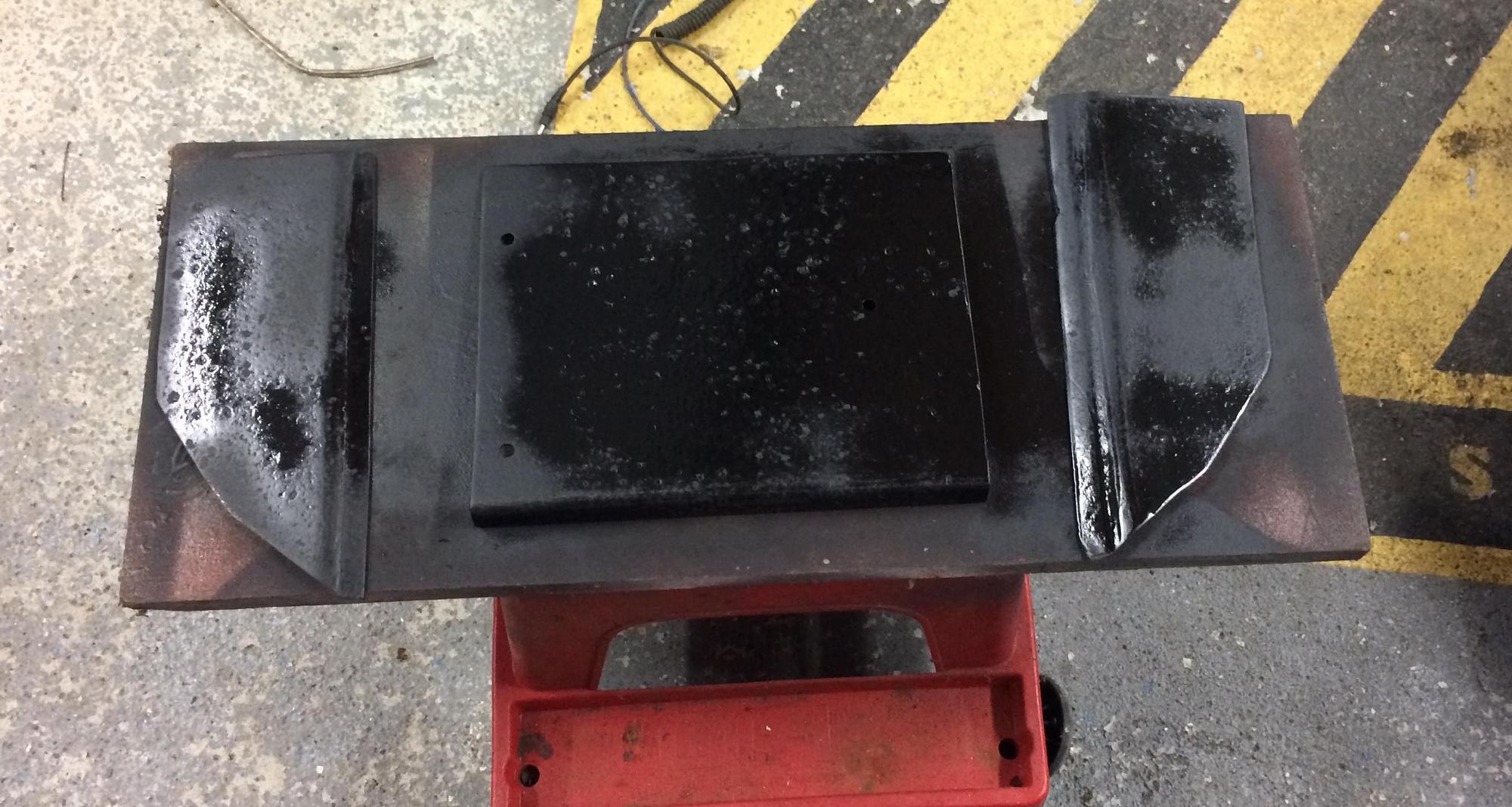

had some more fun with the blasting cabinet...
cleaned off the battery box, the retainer for the battery tray which grabs onto one of the cross tubes.. and the swing arm for the back tire...
figured since they painted it originally with some rusty red colored primer id do the same thing.. Painted it with Red Oxide Primer..

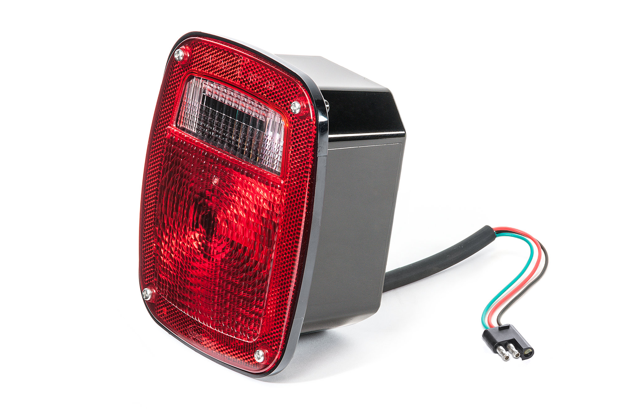

I have the front two supports, but neither of the rear supports. They look like it would be simple to fabricate but I guess until I get to that point I won't know for sure. You used supports from a styleside?
Regarding the tail lights, I was figuring something like this. More rectangular whereas the trailer lights are more square. These cost $20 and said for Jeep CJ but look pretty similar to me.

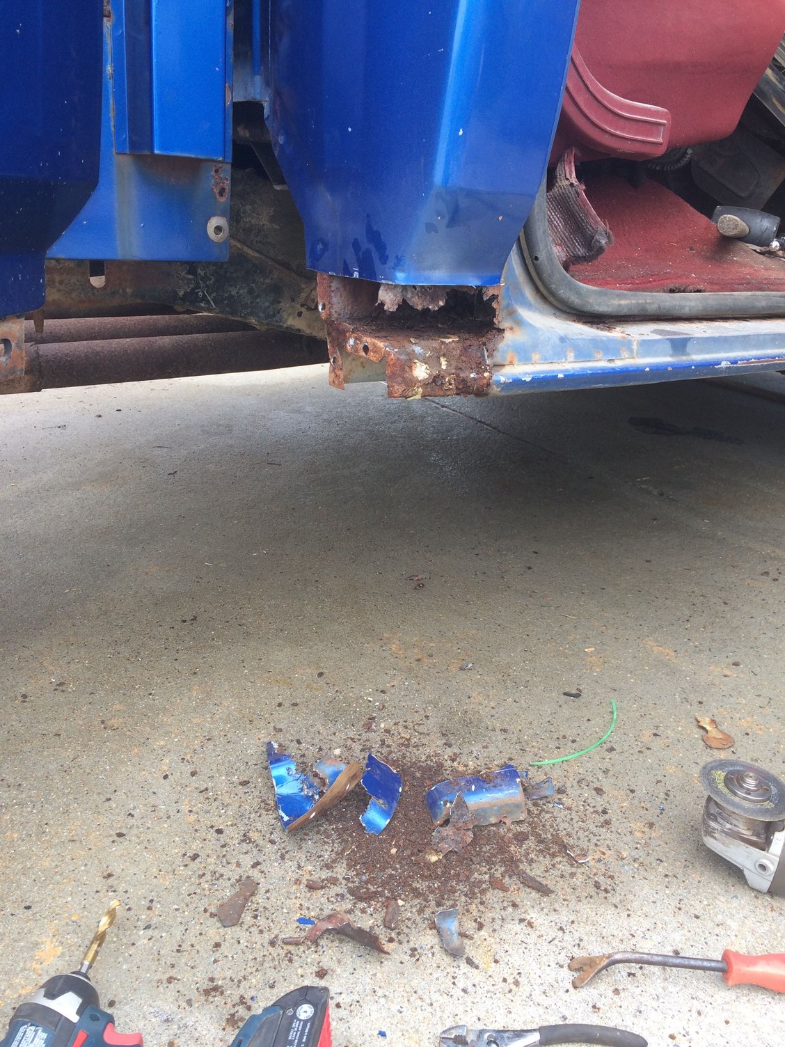

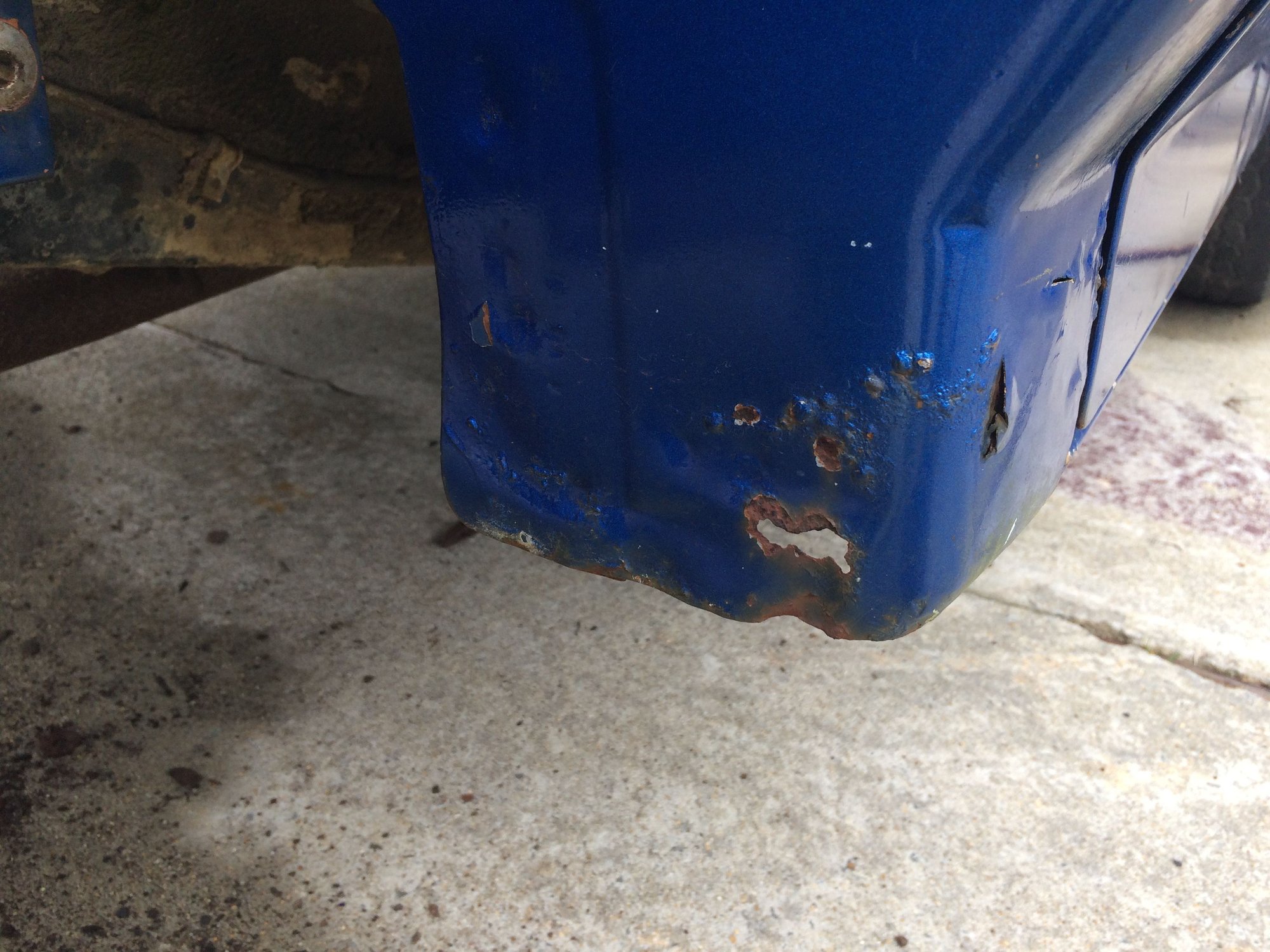

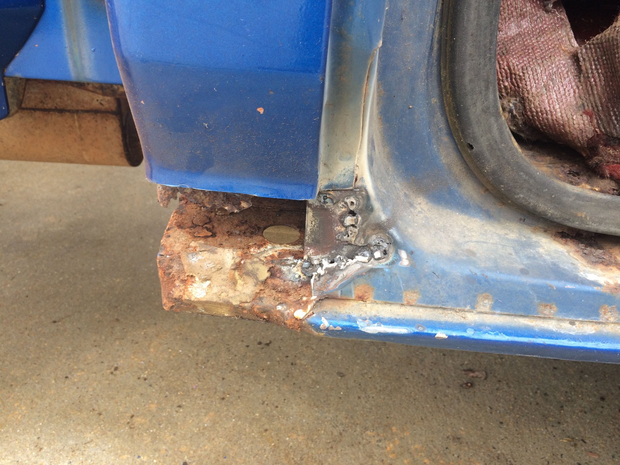

Lately it seems it's either been cold or rainy. Haven't had much opportunity to get out and work on this blue project, but I finally found some time to tackle the cab corner on the passenger side. Now I need to go the drivers side, which is a bit worse. I'll also have to address rust in the door sill on both sides.
Seems to be a common problem with these trucks, rust in the cab corners.

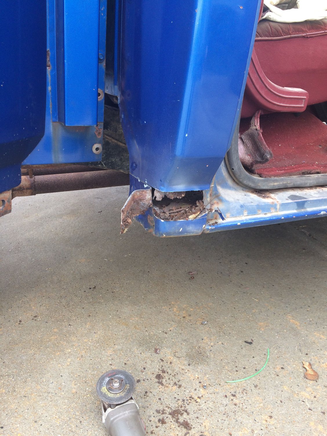

I figured the best way to start was just to cut it open and go from there.
I found a couple of layers of metal bonded together with what seemed to be un-hardened bondo. Perhaps a poorly done previous repair?
Lot of crap came out!

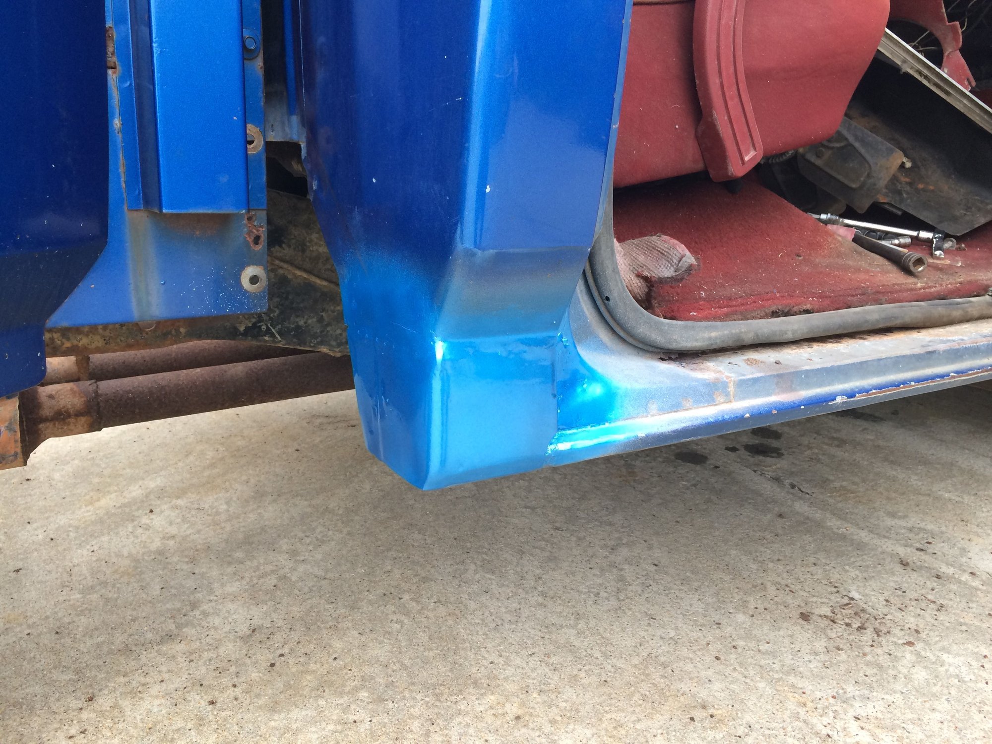

I had to make a little patch to go in the corner so that I'd have something to weld my new corner to.
Well I never claimed to be a great welder!
Grinder cleaned it up quite a bit.

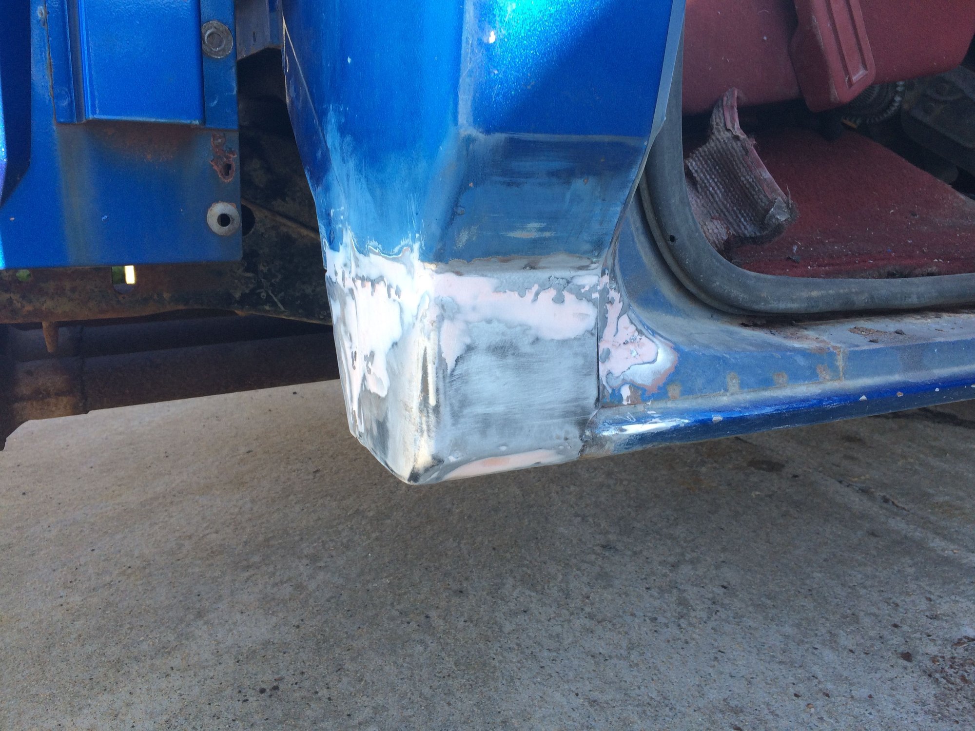

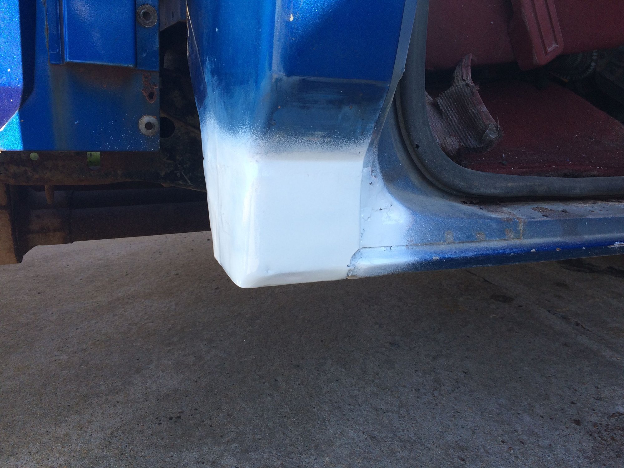

A coat of bondo and a little sanding, doesn't look half bad!
Coat of gray primer.
The paint is not a great match, but the truck will have to be repainted anyway, so this should do for now.

Its a good start.
When looking at the pictures it looked like that was patched before because of the other layer behind it.
Also what you call soft bondo might of been panel bond / glue.
You can see a hole in the rocker on the end. Once it is cleaned out really good and it is dry find a rubber / plastic plug to put in it.
Other wise water can come up thru it and keep everything wet and rust out again.
What type of paint is the blue?
I worry that it may not play nice with the normal auto paint come repaint time.
