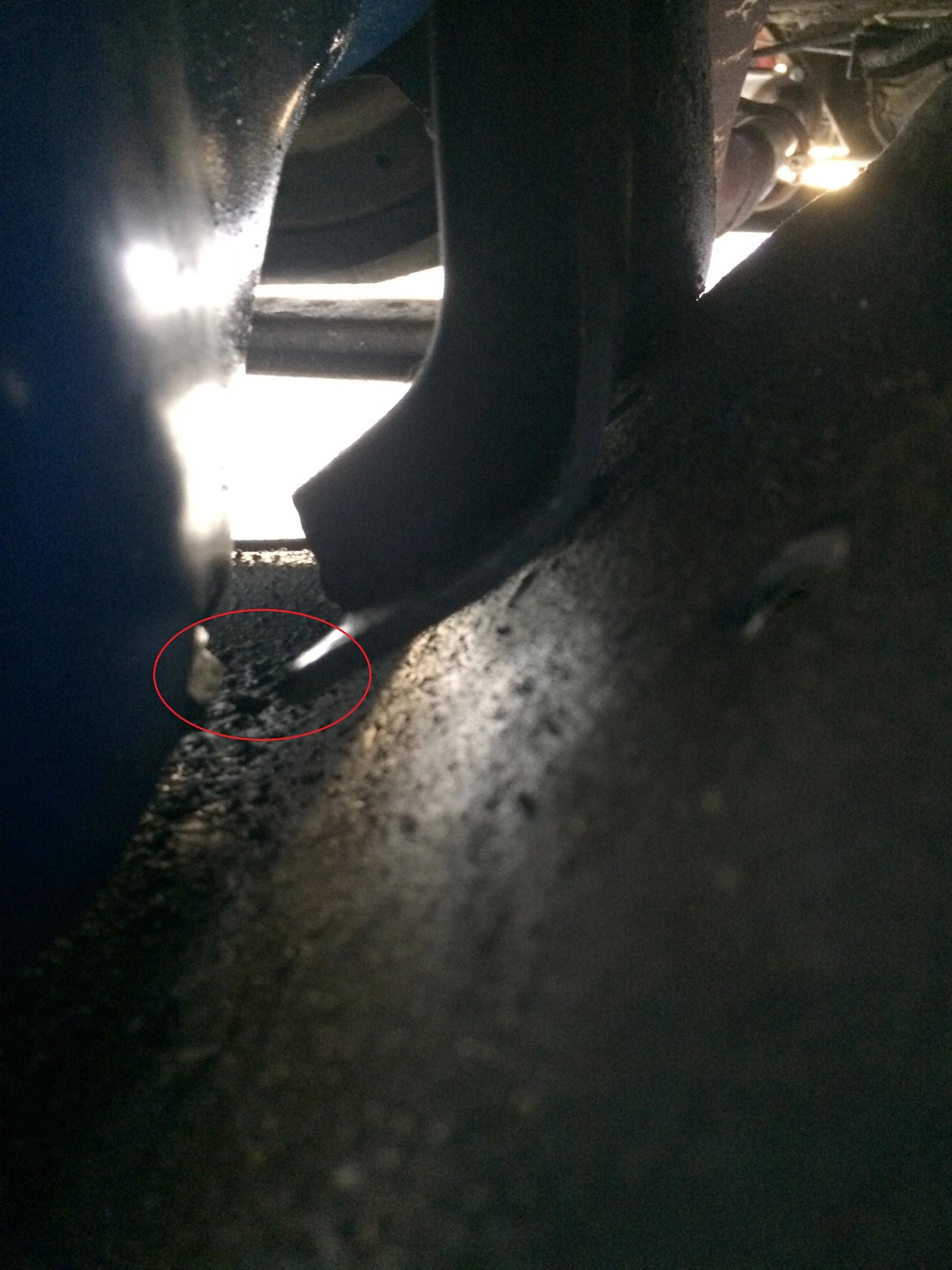

I replaced my oil pan last year, and the drain plug in the new one is in a slightly different location. Just different enough that I can't access it to remove it! Now I'm stuck and can't change my oil.
On the old pan, the drain plug was on the side, but on the new pan the plug is at a 45 angle recessed.
So hard to get a picture that explains my trouble, but the head of the plug is slightly visible, and right next to it, the motor mount tower. No enough room to get a wrench in there.
Went to change my oil by sucking it out, and knocked the vacuum thing off the fender by mistake and it cracked. So now it won't hold vacuum!
