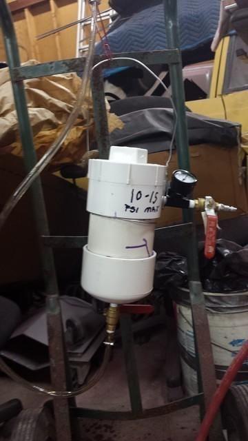

Then added a lot of weld more to the ball side. Then ground & filed back into shape. Also had to run a 9/16 nc die down the threads to clean them up and a tap in the block.
Got it back together and adjusted and worked great so on to the brakes.
Bought a new master (not rebuilt) and rebuilt booster and the swap went pretty easy but ..............
I have no pedal and yes I bench bled the master before it went in.
Had the wife help bleed the brakes, she could not tell me if the pedal would pump up or got better after each wheel bleed.
Still low pedal and mushy so Saturday morning we bleed again with motor running still low & mushy?
Someone said maybe adjust the rod between booster & master, I did check this before installing and this rebuilt is longer than the old one and what the book has listed but I make it a little longer, still no good!
I have my works show in Apex I want to take the truck to and still crappy brakes so I adjust the crap out of the rear drums to the point it will not roll down my drive, still not good but it does stop.
So we give the truck its first wash & dry, pack a few hand tools just in case. We have AARP for towing if I cant fix it.
Wife is not happy at this point but off we go first stop at the gas station to top off the tanks. The rear tank is not working the gauge and did not have the time to really look into it.
I was happy the gas went in both tanks pretty fast as it can be an issue with them & the vent in the filler hoes.
Wife did not talk much on the ride to Apex and I was ok with that as I was more into the truck.
I have a squeak that starts about 10 miles into the drive in both direction but was gone when I took the truck down the street today to return the cores and get keys cut for the truck.
Yes the truck made it back home under its own power and other than the darting left & right is not a bad riding & running truck.
I forgot to get pictures at the show sorry.
Today got a late start, took it down the street to return cores get keys cut and other than brakes it is a nice truck.
I want to pressure bleed the brake system and Auto Zone dose not lend that tool so time to make one.
I started to make one years ago with 3" PVC, some 1/4" nipples, ball valves and hose but did not have a cap for the master.
I used the cap from the old master, a screw in tire valve with the core removed.
I trimmed the gasket so it is just around the edge and in the center to pass fluid to each side.
I filled the PVC, cap in place and started to add air and forgot about the vent in the cap and sprayed fluid.
Cleaned up the cap and engine bay, mixed up a little JB Weld to seal the vent.
It needs to setup for 16 hours so I will get back to it in a few days.
Dave ----

I have a pressure bleeder at the house Dave, didn't know you needed one, I'd be glad to give you a hand. Gotta be careful at what pressure you put it to, I want to say the manual says nothing over 15 psi. I've messed with my brakes a ton to get them right.

On the bleeder thanks for the offer, I think I should be good with the one I am making now that I have the vent hole sealed.
The only thing I see wrong on using the cap from the old master is because it has the raised parts the wire clamp sits on and the fluid comes in at the top of the large one it fills up.
So when you remove the cap that fluid just spills out. I had a large towel down under the master to catch it but thinking I need to put more down for this next try.
On the 15 psi max that is what I seen posted on a few different sites using Google as I did not know.
That is why I marked it on the side of the bleeder assy. as I will forget the next time I go to use it.
It was posted if you went more than 15 psi it could hurt the system? Thinking maybe seals?

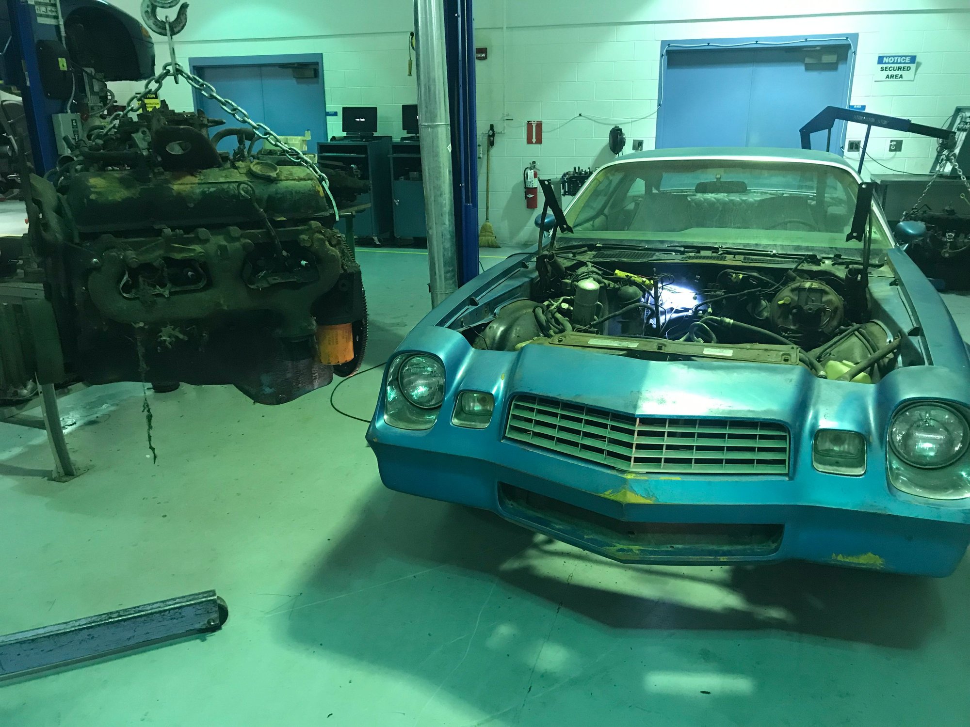

Dustin the hood came out great. Are you going to Wake Tech? Do you know Bailey Freise? Does this project car look familiar to you?
1979 Camaro Berlinetta
Yes he's my cousin, this class is painting 1 through wake tech, already took some courses on doing actual body work. My mom saw him somewhere and he told her about the camaro. I actually happened to be at lkq one day, he needed help pulling a fender.
And Dave, I think over 15 may damage seals, mine never needed over 5-10psi to flush out old fluid, I couldn't get mine to bleed out right without it.
Small world for sure. I sold him that Camaro, I'd had it in my yard for about 8 or 9 years. I've known him since he was a little kid, I worked with his dad for a long time at Verizon. They're redoing the motor in his shop class at Wake Tech.
