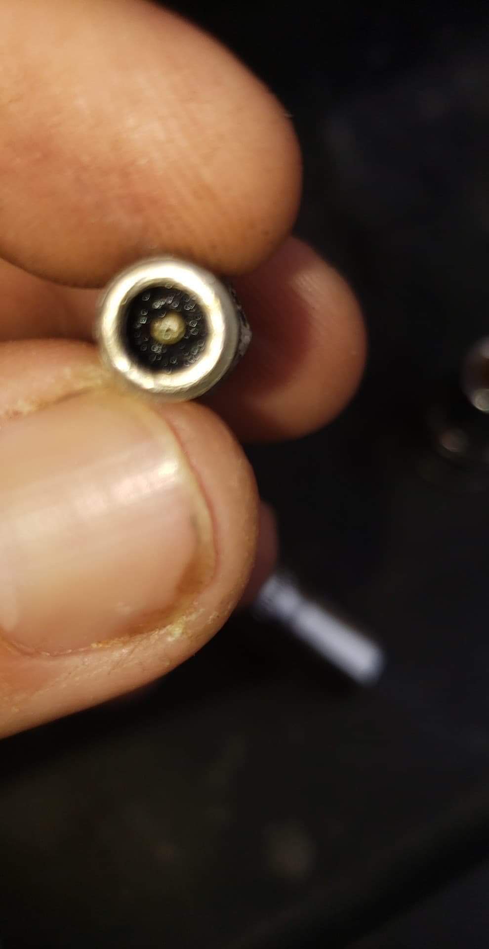

I drove my F150 to work friday, then to my grandma's birthday dinner. At which point I thought I smelt gas, so I got it home and Saturday morning found that the Schrader/pressure release valve on the fuel rail was seeping. So I started trying to track one down but no one had one, ford dealer and o'Reilly were the only ones who could find it and it would of been mid week before I got it from either.
So I pulled off and got to look and it was full of dirt/grease build up. I'm assuming when the guys did the intake swap they used it to bleed pressure and some of that dirt fell into it. Anyways I cleaned it out and reinstalled it and been driving it around with no leaks.

Sometimes things don't like to be disturbed. Depress those and you gotta fiddle with them to get them to seal. Seen it plenty on older tractor valve stems.

Once I cleaned it up and messed with it a bit it sealed up.

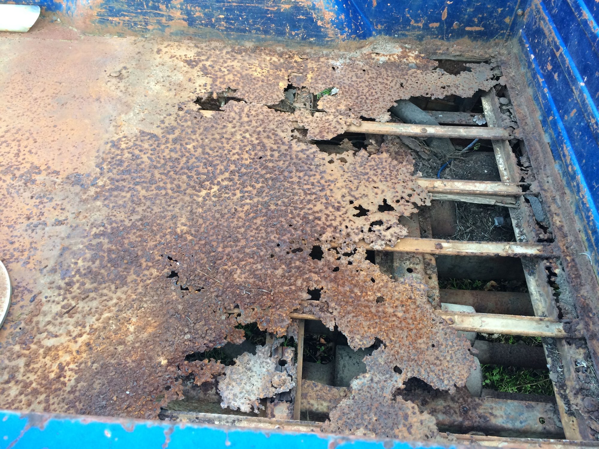

So I picked up a project today. I was thinking an easy flip, get it running good and get everything working, then turn around & sell it. But it's worse than I anticipated in regards to rust and rattiness, plus I think I ruined the transmission by towing it in neutral instead of dropping the driveshaft, so I'm sure I will wind up taking a beating on it in the long run! It's a 1983 F-100 with a 1969 era 351w motor. Motor will crank & fire when you put gas in the carb but it won't run. So either fuel issues or carb issues there. Bed floor is gone, but nothing that a sheet of diamond plate from Dillon Metal Supply in Raleigh can't fix. Knock on wood...
I am playing catch up on this thread.
You know on the Flare Sides they used ply wood for the floor and metal strips to get thelook of planks.
The bed uses 2 ply wood sheets, 1 for the outer edges and the other for down the center.
If you do a search in the 80-86 truck area for wood bed measurements you should find how to cut the wood.
The biggest issues is the cross members and the front & rear sills rot but you can get them just so $$$$
Now the side bed walls are a different story. No one makes the sides and the lip that sits on the wood rot away so you will need to fix that.
You can get after market front wall and tail gates if you need them.
You can also get most of the cab sheet metal like I had to get from http://tabcoparts.com/ good thick metal and fit was pretty good too.
On the trany how far did you tow it? Take it is a C6 in the truck?
How is the frame? Rear cab mounts cross member, rear spring hanger areas?
I am a sucker for Flare Sides LOL

Dave, yes C6 tranny is what the previous owner said. I towed it probably 15 miles before it started acting up. I immediately dropped the driveshaft at that point but it was too late. I guess I'll have my buddy go through it for me. I didn't realize that they came with plywood, I would not have expected that in the 80's! I see the slats are in bad shape, most of them are rusted away near the front. Someone before me welded in some angle iron to support the floor near the cab but the sides look pretty bad (inner sides that is). I was thinking to repair it with diamond plate but now that I know it was originally plywood, I'm thinking about going back that way.

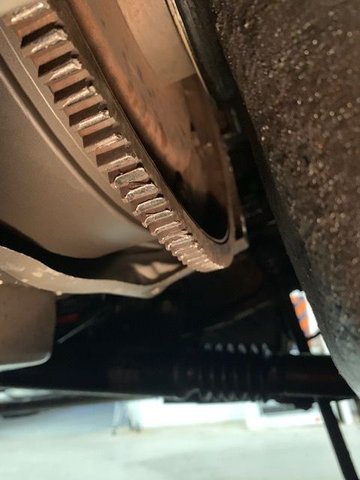

teeth not too badly worn
some noticeable wear on the fwd edge
about a dozen worn teeth.
starter no longer able to 'grab' and crank past this point. always hangs-up and grinds. no bueno.

Dang that is chewed up!

thats a "good" way to not start your engine... too bad we cant still hand crank engines to get them going..
