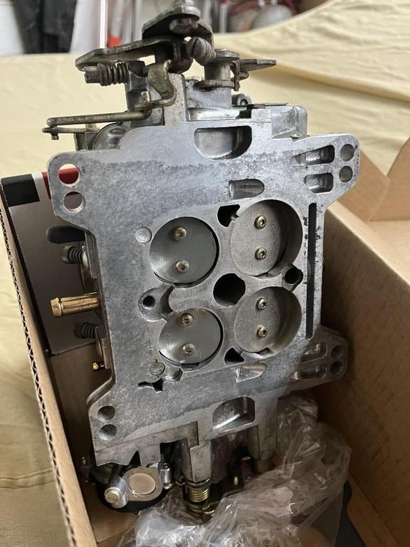

Well I don't mean that I thought the newish Edelbrock is bad, but Wayne (maybe, not 100% sure who?) said they had a screw on the underside that you could remove to get more airflow at idle, which is something you might do if you had installed it on a big motor. And since it was originally on Mike's 455 engine, maybe that previous modification had been made? None of us know including Mike who did not install it himself. I had taken a picture of the underside of the carb before we put it on but I didn't know that I should be looking for anything specific. But I agree with you that we should make every possible effort to verify no vacuum leaks
I don't know what I'm looking for, but maybe there is a bleed screw in one of those holes.

On the carbs and that screw I know Holleys you can do that with don't of others but easy enough to pull carb and check.
