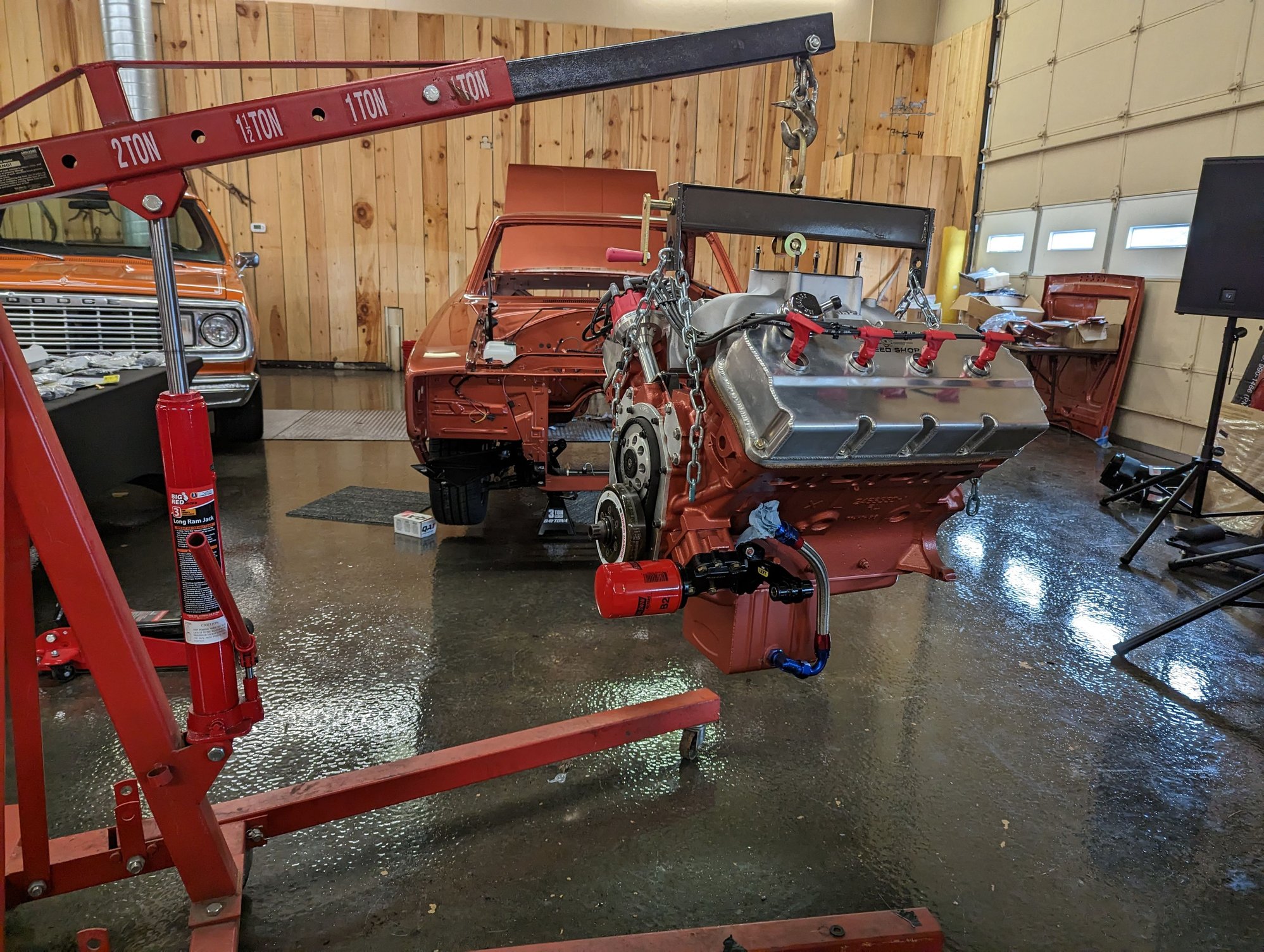

Merry Christmas guys. I haven't posted what I've been up to for yall while my 300 has been in the process of a DIY rebuild and the floor pans get fit. Christmas presents have been in the cab for the last 2 months though so I haven't gotten to that.
Instead, I've been helping a friend out with his fitting of his 426 Hemi into his custom Dodge RT that a custom shop job that went bad. Let me tell you those things are BIG. wow. Working with only an inch or two ALL around. Good times though. Looking forward to getting back into my garage once it warms up in the new year.

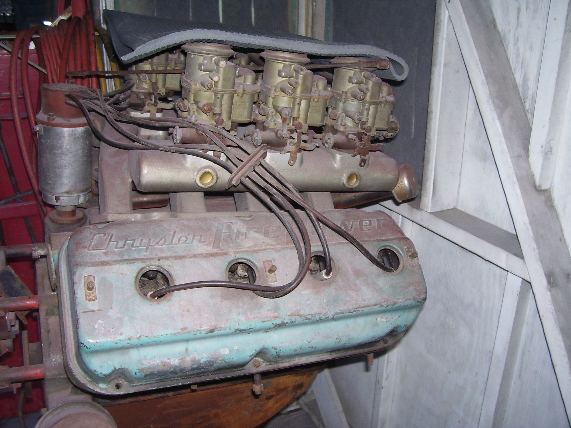

I see the Hemi has a Vortex magneto - needs no power to make spark.
Just spin it and it makes spark. Some of or off road team members ran them.
I dont know if that older Hemi is the same as the one they are putting in the RT?
Then you have the new ones they put in the Chargers.

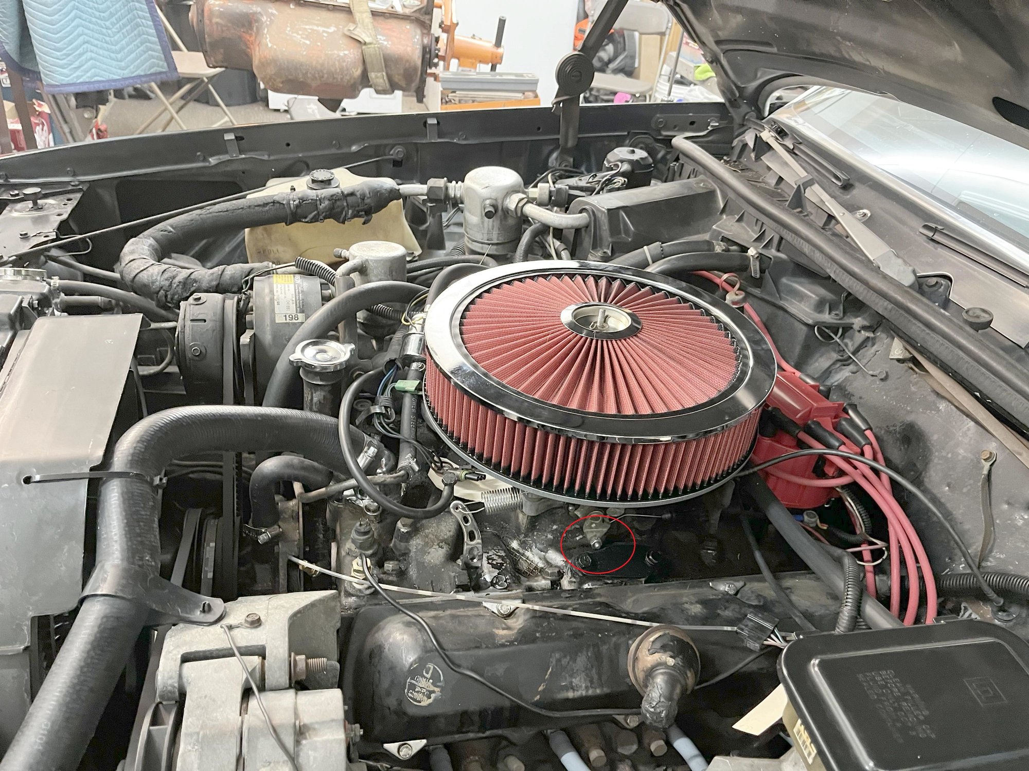

So let me catch you up on some of the efforts that was going on Andre's before the holidays. You remember how bad his Cutlass was running that day in my driveway, where it was idling high, would not settle down, but we could never find any vacuum leak?

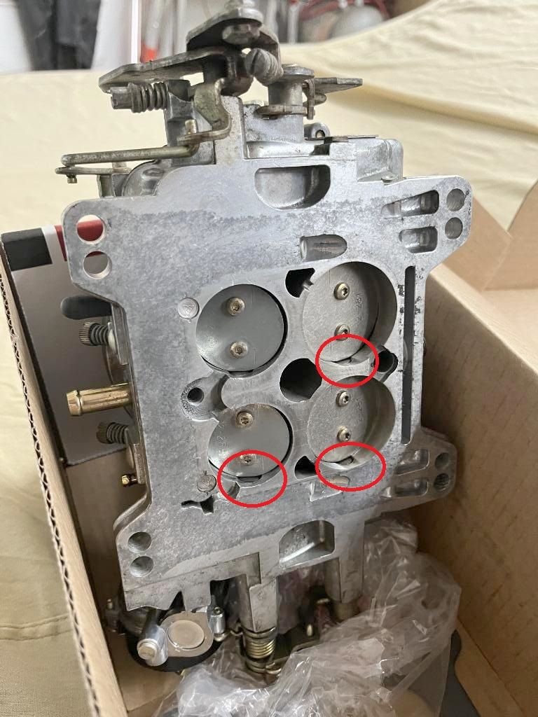

Well Mike gifted him an Edelbrock 500 carb, apparently he had purchased it for his own car but soon realized that a 500 cfm carb will not properly feed his 455 engine, so he upgraded to a 750 cfm and put this one back in the box. It's the perfect size for Andre's 307 and is a nice upgrade over the 35 year old quadrajet.
So the first thing I was try to label everything, because in addition to the carb swap Andre wanted to try & delete all the emissions stuff and unnecessary sensors and wires. But to my dismay I found that Andre had already tackled some of this himself, in his very caveman sort of way. He even hacked off the wiring for the cruise control, which he said worked fine, he just didn't see himself as ever needing it or using it, so CHOP - it's gone. And all the open wires just hiding inside the corrugated wire loom hopefully not touching anything else.
I deleted his EGR for him, just removed it and created a flat plate out of 1/4 inch steel. Wayne said we should not need a spacer to mount the square bore Edelbrock to the spread bore Quadrajet manifold, but it looked kinda sketch to me and I had a square-to-spread adapter in my carburetor parts box, so we used it. We would have needed it anyway because the carburetor mount is so low that the throttle arm would be touching the base of the intake and not be able to move. The EGR plate I made was too close to the TV cable attachment for the trans and was touching, so we had to clearance it with a dremel. See picture.
After clearancing this with a dremel, we got full movement on the arm with the throttle valve cable attached.
At the same time as the carburetor replacement, we did a distributor swap as well. The original one did not have a vacuum advance and was controlled by the early computer, which appeared to not be operational anymore (when you turn the key on, there are 8 dashboard lights that should come on to tell you the computer is working, and none of them come on except the ALT light which is likely wired independent of the computer). The carburetor was what they called a "feedback carburetor" and the computer got information about the throttle position and other things from 2 connectors going to the carb. So bottom line, the original distributor would not work correctly with this setup, so Andre ordered a "ready to run HEI" that came with 8mm plug wires as well, so the ignition system would be brand new. Doing a distributor swap on a GM really makes you appreciate a Ford, as reaching that crap in the back of the motor by the firewall is a real pain, and honestly I could only get the socket on the hold-down by feel, not by sight. I think if I could really get up on the fender I could probably see but I was about to give Andre a heart attack every time my belt touched the fender, so I made sure to stay back.
It fired up on the first try, so kudos to us for getting everything hooked up correctly. Generally speaking I would not like to swap 2 things at once, but in this case we didn't seem to have much choice. I could not find the timing pointer on his engine at all, and a google search turned up a tip that most GM engines of this era had a plastic timing pointer and over the years a lot of them get brittle and break off so I can only assume this must be the case with his motor as well. So we did the timing by trial and error, slowly moved it to where it had the fastest idle, then reduced it by about 100 rpm. Went for a test drive and had some pinging under acceleration, so we came back and reduced it a little bit more and it seemed to be a sweet spot where the engine started easily and ran well under all the conditions we put it through.
But the carburetor is another matter. Even with the idle adjustment all the way out, so far out you can fit a flat tip screwdriver blade between the adjustment screw and the arm, it still idles too fast. This was a problem on the old Q-Jet as well so it got me to thinking that there must be a vacuum leak somewhere. I disconnected all vacuum lines on the manifold & carb and put caps over them to seal them, tried again and got the same result. Wayne put a rag in his hand and held it stuffed over the air horn of the carb and the engine sputtered to die out, so he said that indicates the air is coming through the carb, not through a vacuum leak. I was thinking even if the air is getting in somewhere else, if you choke off the carb and rob it of fuel you will have the same result, so I am not 100% sure his method is correct, but since I can't hear or find any leak I will assume for now that's the case. He said sometimes on those small Edelbrocks they will modify them to let more air through, but I don't know how to tell if that is the case. I did happen to take a pic of the bottom of the carb before install and in looking at it afterwards, I noticed these "channels" for lack of a better word in each of the throttle bores, that look like the throttle blades even when fully closed will not be able to seal. It looks like it was made that way and I don't know if it is something to be worried about or not. One thing for sure, working on this has reaffirmed my preference as a "Holley guy" over Edelbrock. See picture, I've the circled the ones most visible.
I guess it's right but it sure looks strange. Edelbrock 500 cfm
Another problem we encountered, the shift points on the transmission are not right. The correct way to set the TV cable is to press a detent button on the cable housing which lets it slide in or out, then pull the throttle all the way to fully open. At that point release the detent, and the trans cable will be pulled fully out whenever the carburetor is at WOT. But the trans will shift ok from 1-2 then shifts late from 2-3, and would not upshift 3-4 unless we were going about 60-65. At idle, there is a LOT of slack in the cable, so I know its not getting any signal from the throttle to the trans until you are about half throttle. I know in dealing with the Ford AOD, the geometry was way off and I think that is the case here as well. I found a bracket that says "TV Geometry corrector for Edelbrock with TH200R4 and TH700R4 transmissions", so I told Andre to order that. It only cost $16 and seems well worth it if it will solve that problem. Meanwhile, the trans clunks pretty hard when you put it in gear. I think that is probably due to the idle speed (the lowest we can get is about 1050 rpm), so I think if we can figure that out and get the car to idle at 700 or so, it will go into D more smoothly.
If you have any ideas or suggestions, or want to come tinker with it, we can try for Sat or Sun, I know Andre will appreciate it, and I will appreciate any assistance also. Wayne was good but it was obvious he was not back to feeling 100% yet. Another set of eyes might be exactly what is needed.

I dont know if Vortex is still around or not but is mostly a race only item because of the size, see how tall it is?
And not many places have a cap & rotor if you would need one.
Unlike the normal dist. that needs battery power to work and if the batter is low the spark is weak.
The Vortex is a magneto, think lawn mower, no battery to run.
For the street now with all the different "HEI" systems out there is another reason you dont see many.
