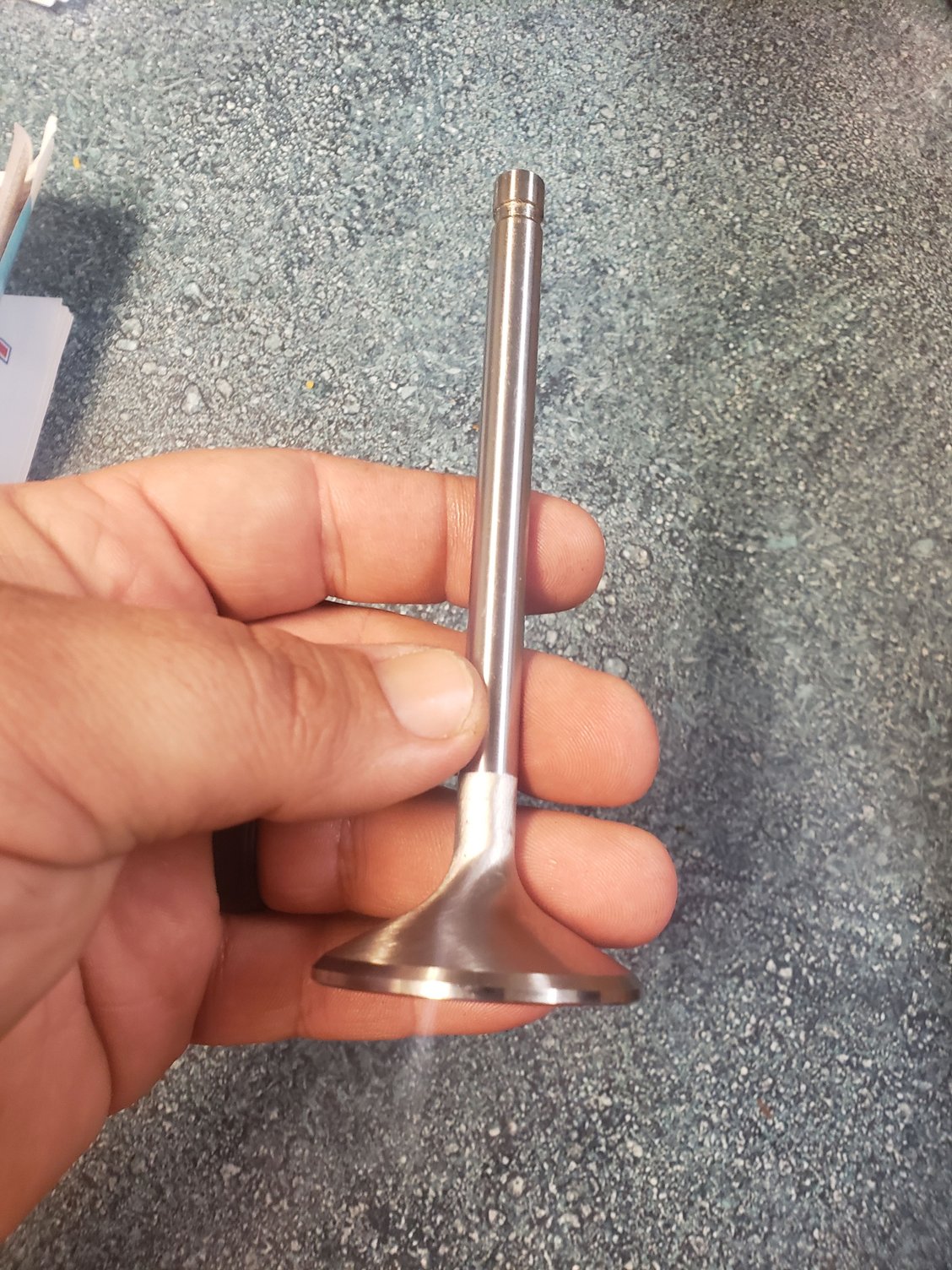

Then decided to clean up the valves. (this particular one is from the side that was "open" for 30 sum years... )
much better now...
