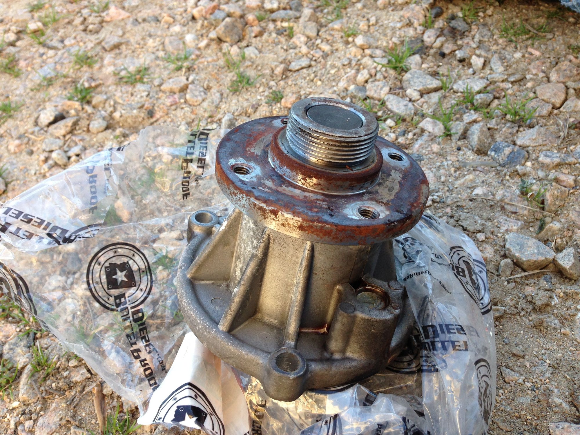

After an hr of using the air hammer on that stupid an clutch nut it finally popped loose... just held the trigger for an hr.. and still had to shove something in the pulley holes as it was just turning the pulley even with the belt still on...

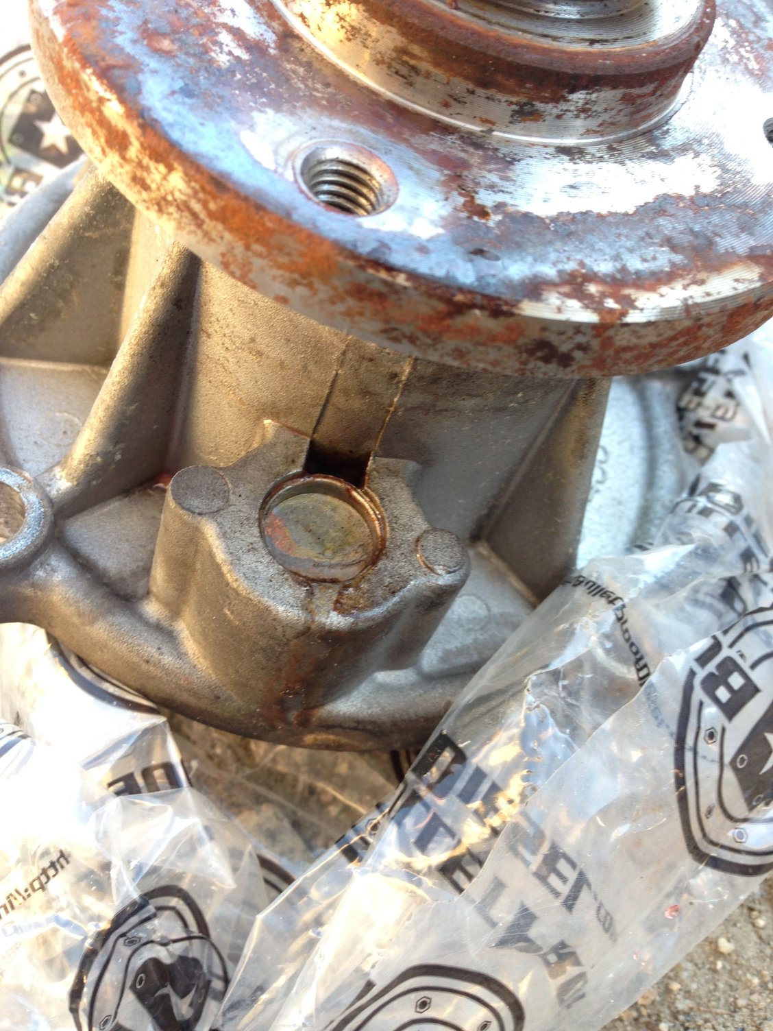

old nasty pump off
it was apparently leaking from the little freeze plug hole judging by the trail...

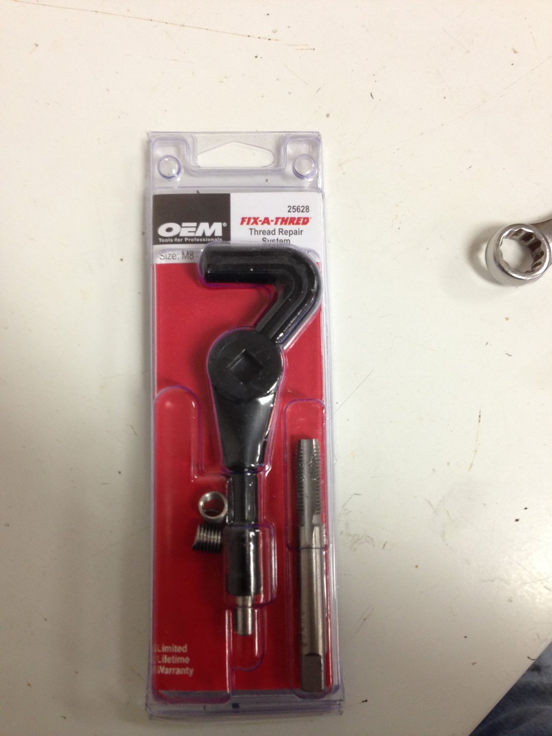

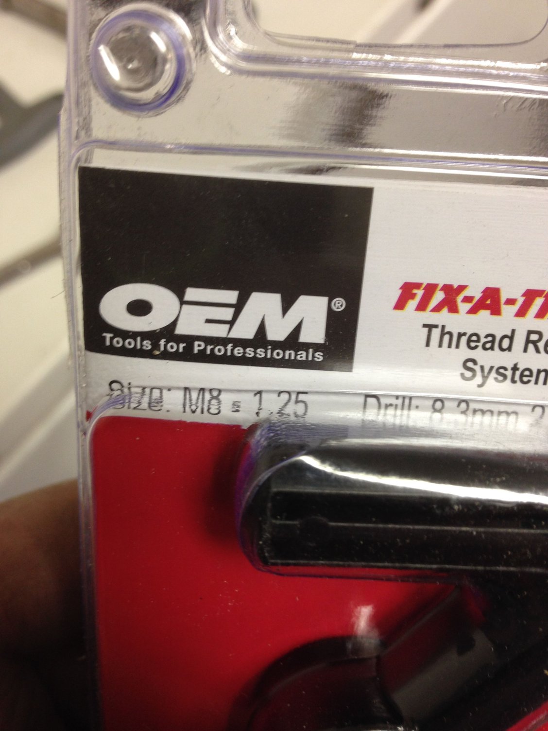

the reason for the "fun" of putting the new one in.. went to tighten the waterpump to mounting plate bolts and one of them decided to rip the threads out of the hole.. GRRRR... so had to go buy a new "thread kit" since i didnt have one in that size.. only size i had was the m6x1's which is for the valve cover bolt holes and ones for doing spark plug threads.. (yes that is supposed to be spark plug.. not glow plug)...
incase and of yall 6.0 diesel owners (7.3 probably uses the same one but dunno) ever have to do those bolt holes... heres the size...
