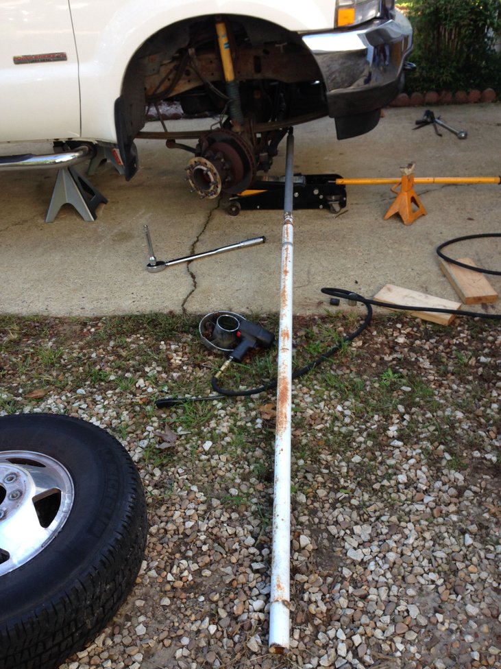

Jezebel has a 1 year run engine and was the last of the pushrods before both lines went to OHC.. V8's went OHC in 96... v6's went OHC in 05... but for 04 they were the only year to get the 3.9 v6.. before you had the 3.8 and after you had 4.0... shes also the 40th anniversary year but didnt get the 40th anniversary package... the only upgrade she really has in her is the radio.. rest was all standard equipment.. but ive played with her a little to make her my own... shes peppy enough to tick off a few v8 owners with how well i keep up with them even though shes not boosted with turbos/supercharges/NOS or any tuners... lol
one of those tie rods will be really expensive... lol Steering box go with Redheads... theyre great got one on Lil Dually real smooth... they fix the drawbacks in the factory units and beef them up.. https://redheadsteeringgears.com/... just make sure you do the bleeding procedures... i did the first half then let it sit over night before turning the engine over... youll need new o-rings too
trouble?? somewhat... axle moved a little when the trackbar was out so it didnt line up when trying to put the bolts back in... but the bolts themselfs are the "fun" part... youll want some 3/4" tools... especially for the Tq wrench... both the bolts that hold the track bar in are torqued to 406 ft-lbs.. in that pic i had a 3/4" breaker bar that had 24" handle with a 3 foot pipe on the end of its handle and a 6 foot pipe on the end of the 3 foot pipe to get the torque...

dang I hear ya, there’s actually a lady in the mustang club with my dad that has a V6 Saleen that’s real. Hell I didn’t even know you could get those. That’s good info on the new steering box I’ll check it out. I’m not worried about the bolts, if need be I’ll put the big rig 1” tire gun on it and I’ve got a 5’ lug nut torque wrench. LoL.

i couldnt get a gun on mine... ive got a 3/4" impact thats supposed to have 1000ft/lbs of torque behind it... but couldnt get it in there to do it... but did try with my 1/2" impact and universals to bust them loose when i started... its got 700ft/lbs of nut busting torque... it wouldnt even budge them bolts when they were tight... but did fine for zipping them in and out...
