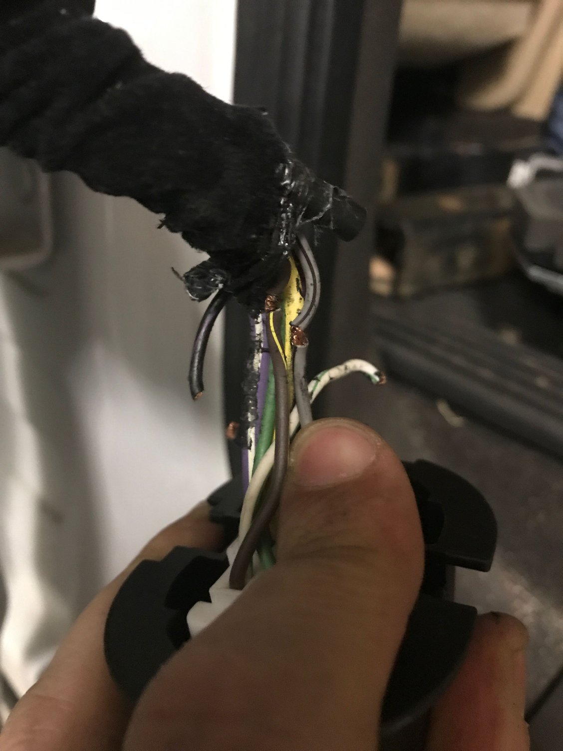

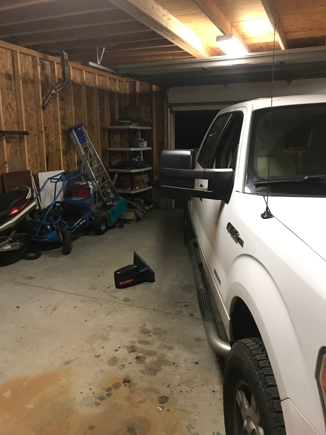

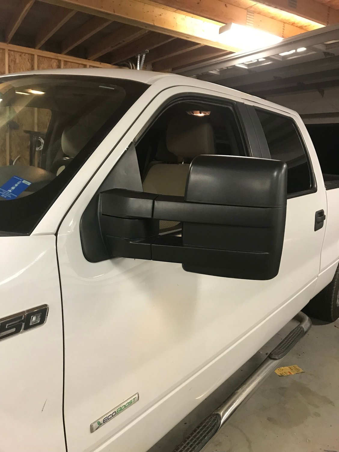

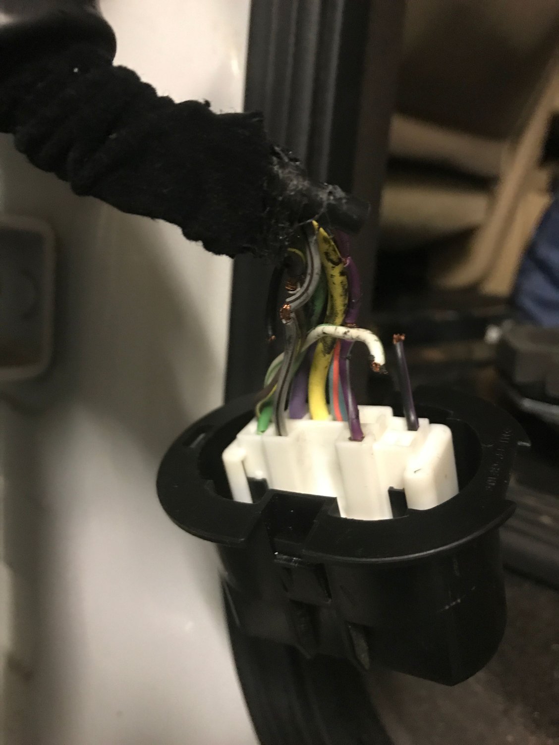

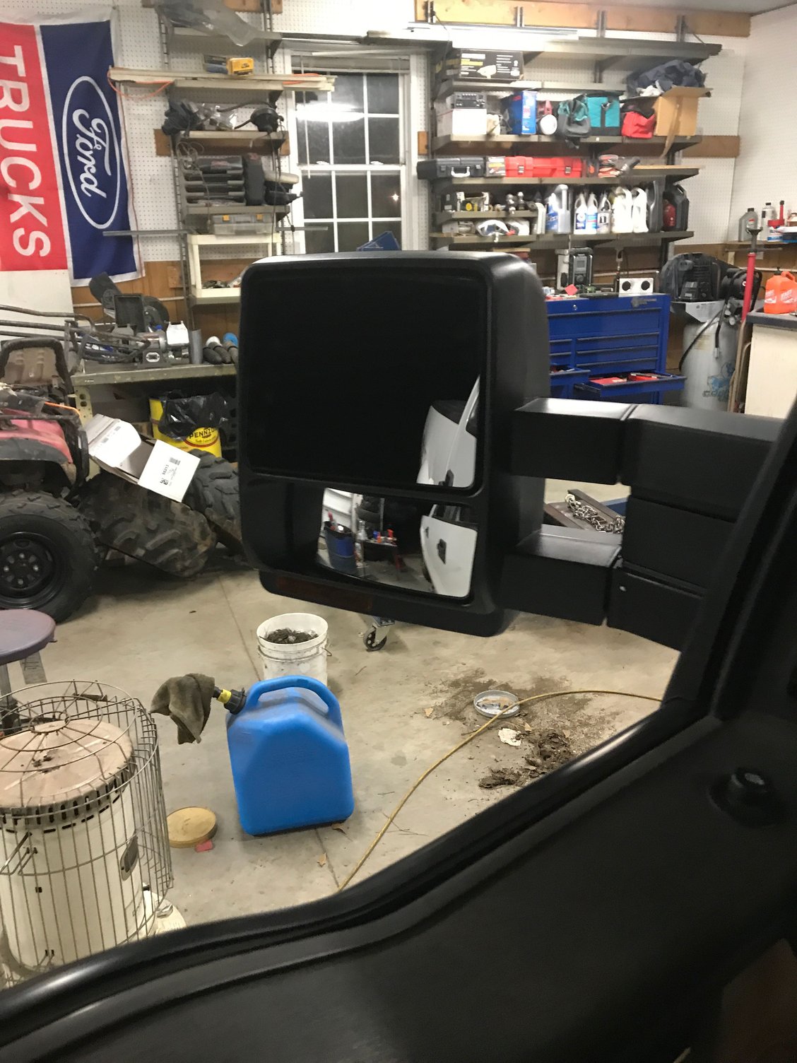

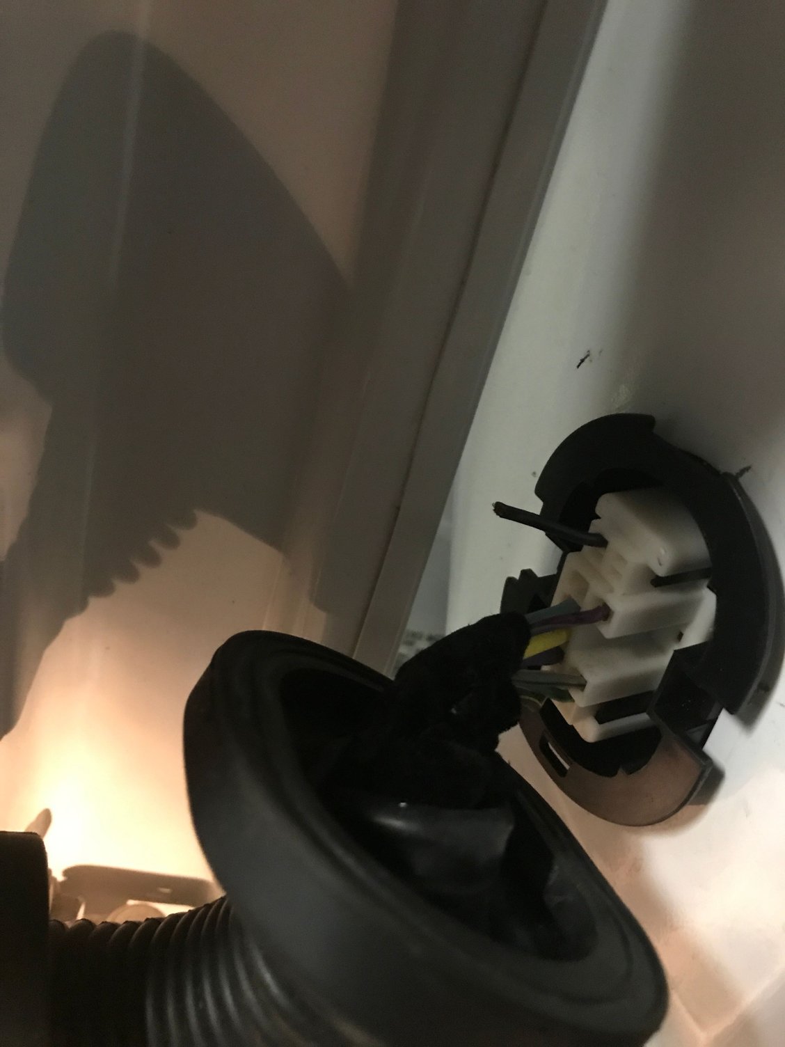

In preparation of bringing home a new toy, and not at all because my neck has been bothering me when I turn my head, I decided to do a easy upgrade to the little truck.
Also, since the interior lights being on bothered me, as well as the warning, I decided I wanted to see if the assumption that the left door harness was bad was correct. It was.

looks like someone yanked on the harness real good

It’s the rear door accordion. When it was intermittent, it was my guess. After checking the forum, I was 99% sure. When it got to the point where I couldn’t ever get it to work, I decided to pull it. That was about 2 or 3 weeks ago. Finally got around to doing it tonight. I patched it. Maybe it will hold, maybe it won’t. If not I’ll just order a replacement harness.

I had a similar issue on my f250 in speaker wiring. I ended up running new 14 gauge wire from the kick panel all the way to the speaker. Been good for 7 years now.

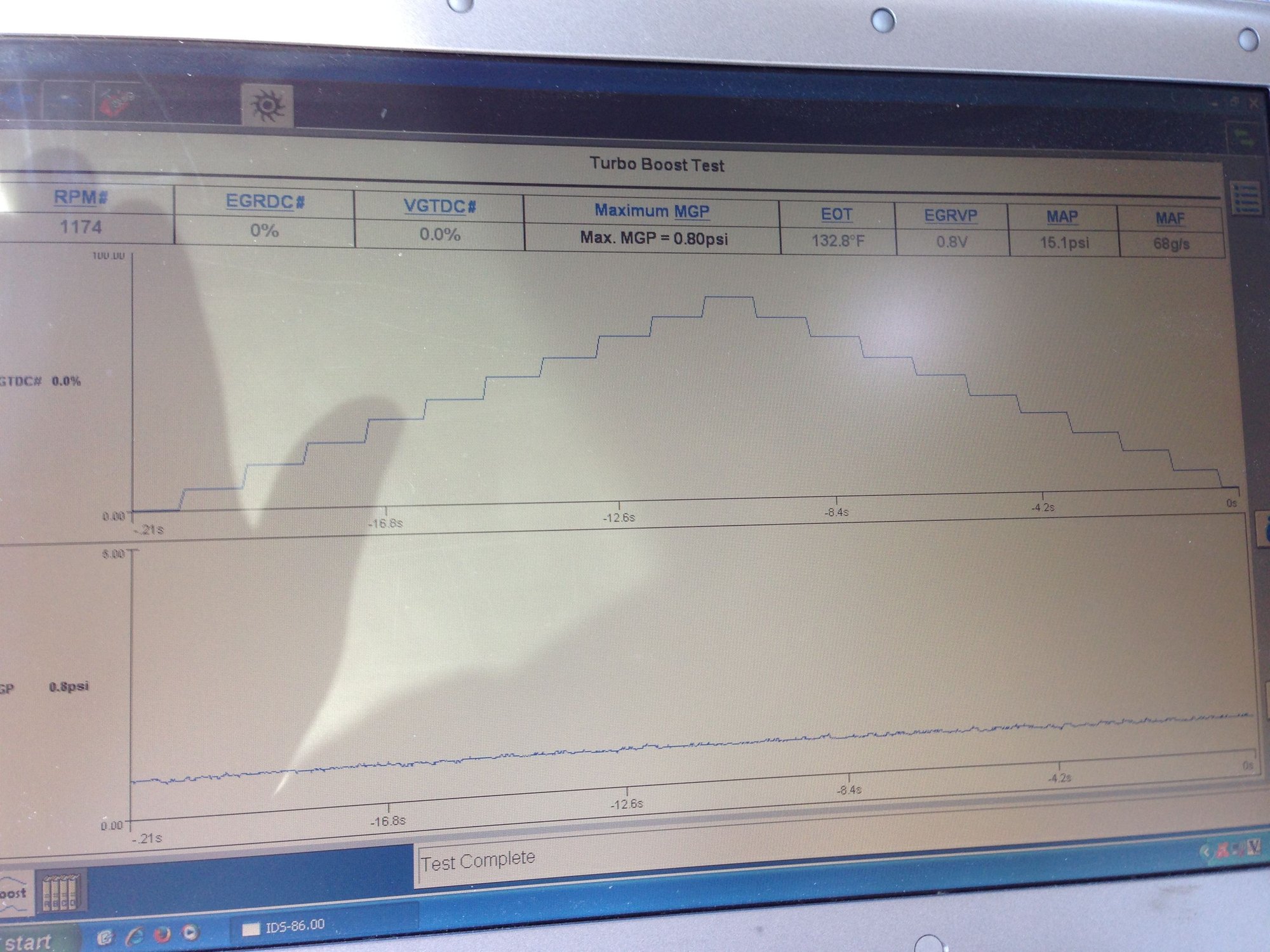

Test drive wasnt as happy as i was hoping yesterday... truck had no power behind it.... thought i had either a struck turbo or forgot a rag in the intake plumbing..
Didnt find a forgotten rag in the intake piping. But the IDS found this
For those that dont know. This is the vane ossilation test. The bottom line should mirror the top line.

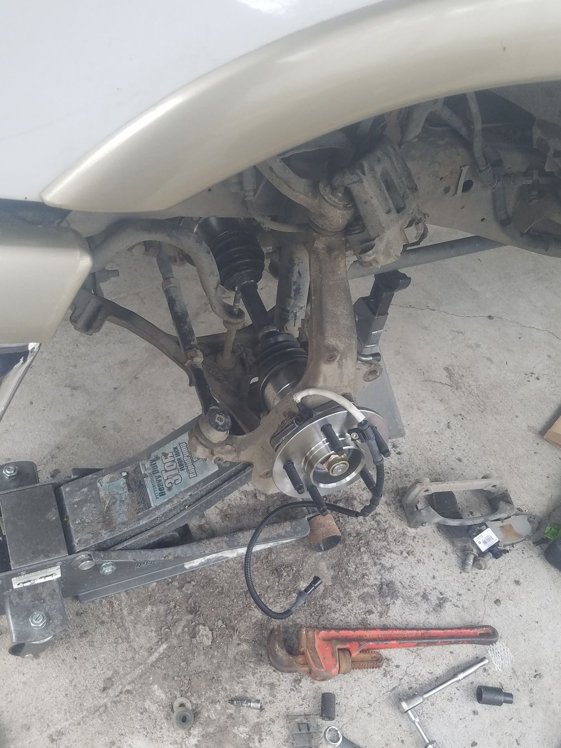

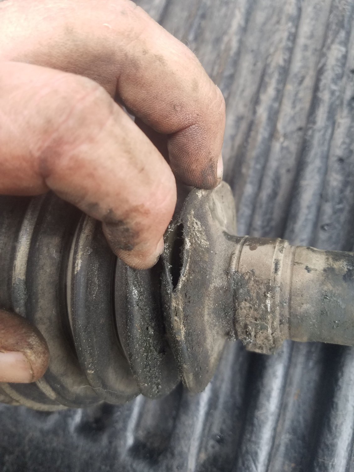

Well I've had a slight and random "pop" in the front end but couldn't ever find anything loose. So Saturday I jacked up the front of my truck and found that it had a little wheel bearing play on the driver side hub. So ran a few earns yesterday and pickup a hub knowing I'd be off work early today. Get home and get it jacked up and notice a good bit of grease in the wheel well that wasn't there Saturday. Get it all apart and find this...
Also find that it only has free play in one direction and if you force it one of the other directions it would pop. So guess that solves my random pop issue...
anyways got her back together with a brand new CV shaft and Wheel bearing.
