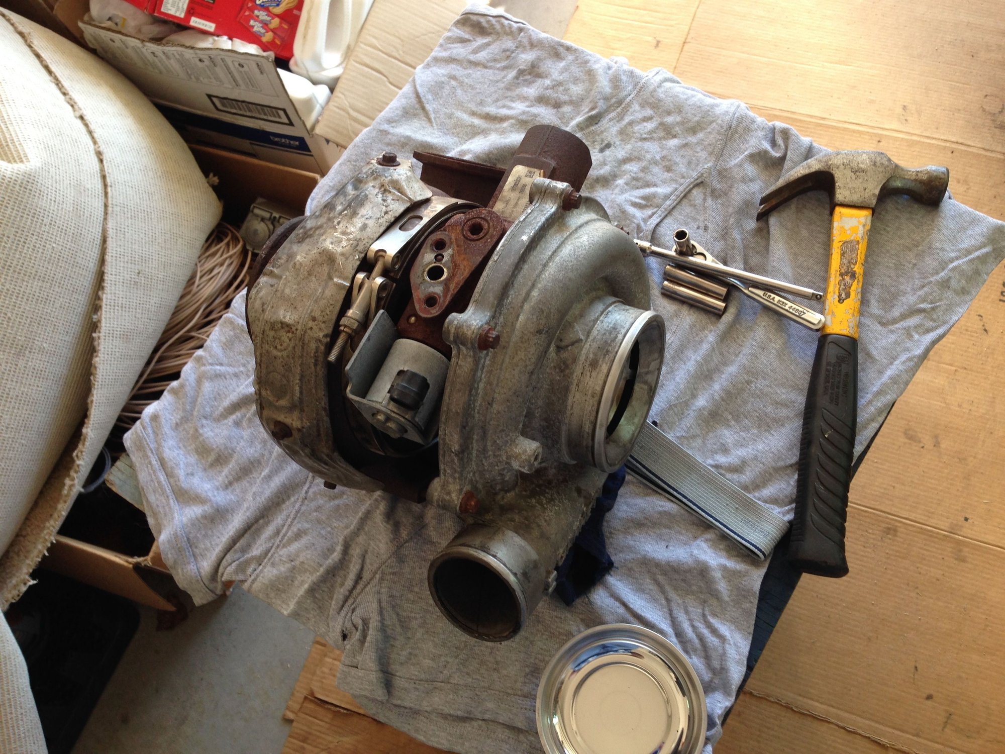

Got the turbo out today hoping for a quick clean and fix and reinstall...

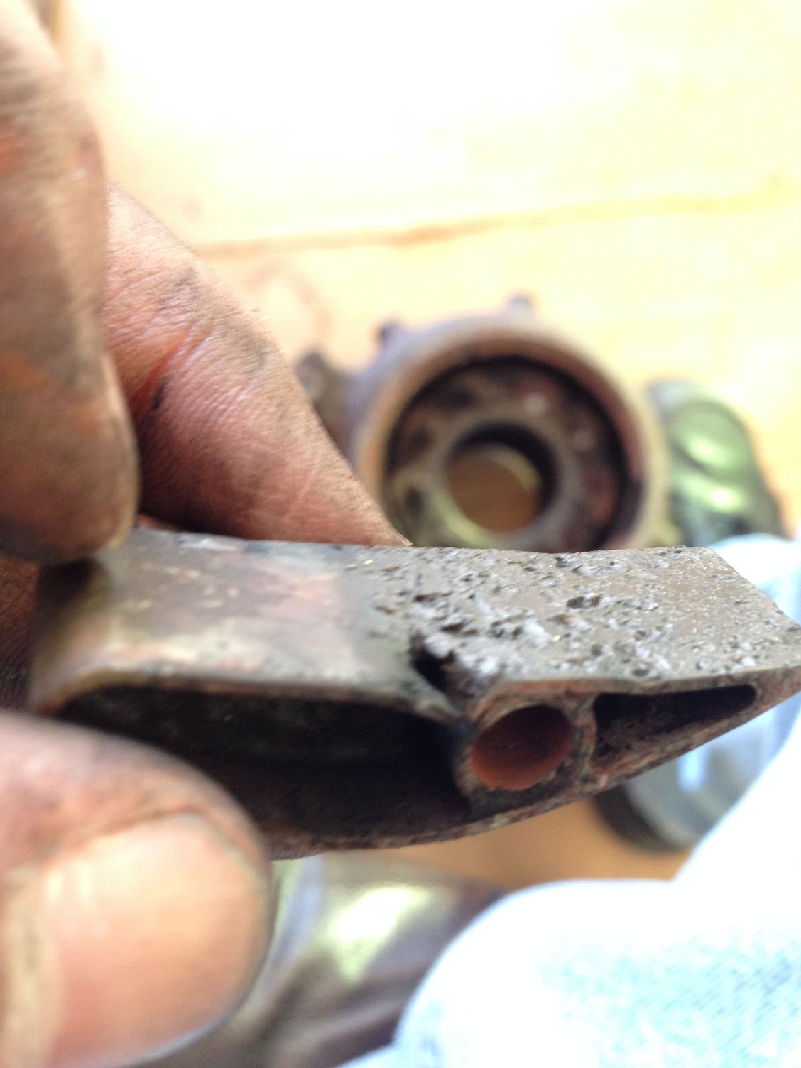

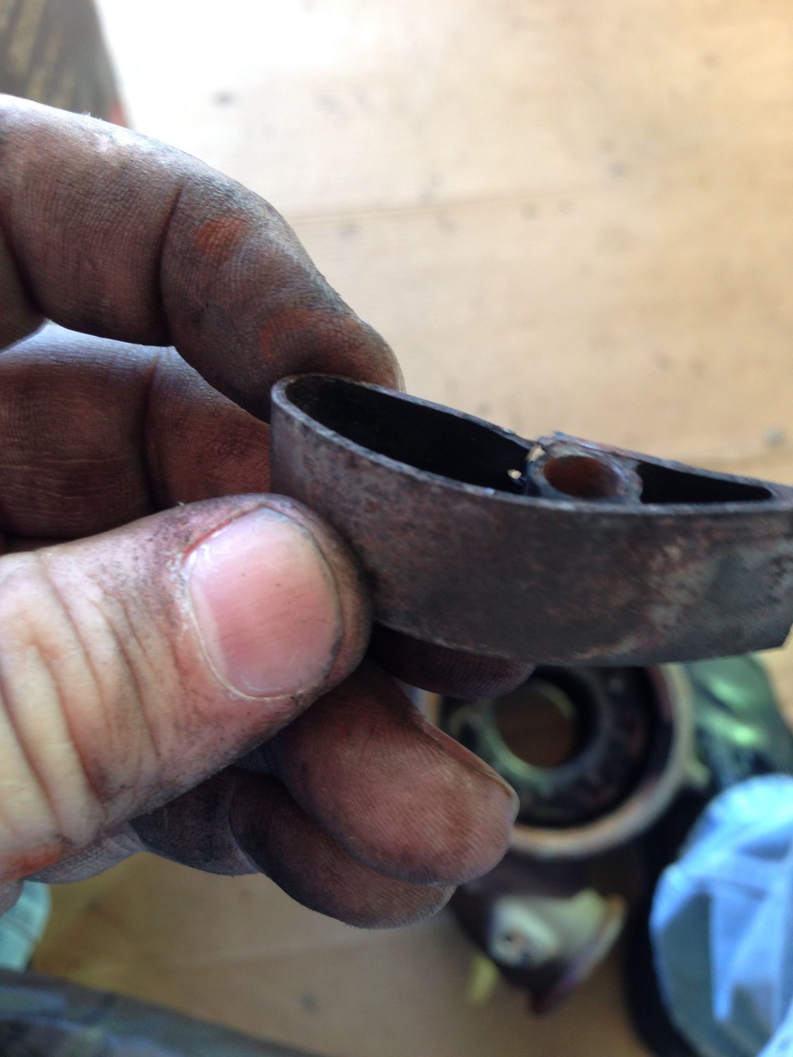

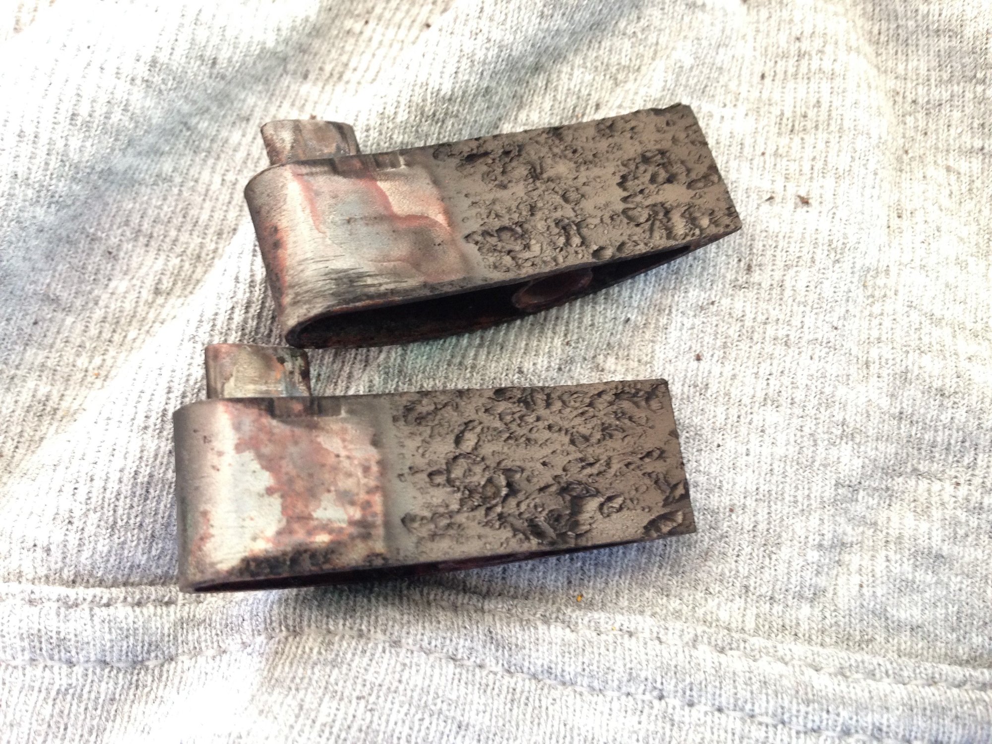

but the turbo apparently got cooked... what i thought was frozen in the wide open position was frozen with the vanes fully closed... the exhaust side of the compressor shaft (btw what do yall call that side?? i know the other sides the compression wheel/chamber but whats the fancy name for the exhaust side of the housing??) i can tell you last time i had the turbo apart the wheel didnt look like that...
vanes look like someone was hitting them with a oxy torch.. ended up breaking one of the stems too trying to get them off... they were pretty warped and tight...
one of them even has a hole in it...
i see light....
the unison ring was really stuck on there pretty good too... took a chisel and a bigger hammer to get it to pop off... (ntm had to use a hammer to get the housing apart to start with)... trying the actuator pin by hand after i spent 10 mins with the hammer and chisel to the unison ring off it moved pretty freely...
