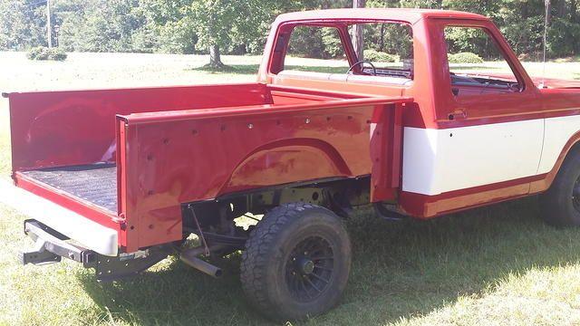

Added Peel & Seal to the doors to make them sound less tinny when closing and for the speakers to sound better.
I gathered the painted bolts & nuts for the bed sides and got them installed and all tight.
It took me a lot longer than I though it would. I do have some touching up to do to them but not bad.
I than finished prepping the fenders and the 2 gas filler doors for white paint.
Yes we have white paint on the rear fenders and gas doors.
I don't know how I am going to paint the red yet. If they are on the stands I have then some of the edges may not get paint so going to have to figure that out.
As for red paint I need I think 2 more qt's to do the fenders, running boards, bolts / nuts & tail gate.
I will try and pick that up first thing in the morning so I get the red done but ..........

Done yesterday:
We got the last of the paint on the truck!
Started at 4am and lights off at 8:30 yep a long day again.
The tail gate needed a lot more prepping than I remember it needing.
After wet sanding down pretty close to bare metal I had to give it a few heavy coats of primer.
Then more wet sanding till ready for paint. Also wet sanded the 2 running boards.
The fenders got taped up then dry sanded, all final sanding was with 600 grit paper even on the cab.

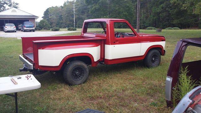

This morning before unwrapping
Just 2 bolts holding it on, breakfast was getting cold!

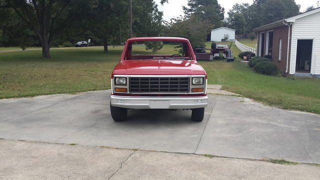

After I got the fenders held on with a few bolt I was able to get it in my garage to fit the running boards, fender & running board braces and the rest of the fender bolts and got them all tight.
In fitting the rear fender brace on the left side I can see why the factory may not wanted to run the rear tank on flare sides. The brace kind of run thru where the filler is. I was able to push the hose over but if I have issues filling that tank I may need to remove it.
Fitted up the 2 fuel fillers & doors. I did not order enough rubber bumpers for the doors but the 1 I did order would fall thru the holes for it in the fuller box.
I had 2 larger bumpers I ordered but did not know what they were for, found out later, and used them on the front door but the door still hits the bolts?
I will order 4 more of them bumpers, 2 for the other fuel door and 2 for what they are for. I also need 1 more "unleaded" sticker for the 2nd fuel door.
Mounted the tail gate and the chains. Was not bad once I figured how I was going to do this and not hurt the fresh paint on anything. It was when mounting the chains I found where them bigger rubber bumpers went ...... Yep the handles of the chains to keep from hitting the painted tail gate!
I also glued in the 2 rubber strips in the tail gate sides to keep the gate tight to the body and moving making noise.
When doing all this I was going thru my parts bins looking for parts I could put on but was really looking for the rear tail light harness for either truck.
I found the full harness from the flare side, I am using the parts truck harness for the options it had and I am running.
The flare side harness did not have a tail light harness. Someone cut the plug off the frame harness and added wires to reach the cheap boat lights that were mounted up high out back, so that harness when back in the parts bin.
I did find the 2 broken flare side tail lights my brother sent and he did cut the truck side harness so I have the needed plugs to put in the new lights when I get the 2nd one this week.
I also pulled off the brackets, prepped and painted and installed on the truck with the 1 new tail light I have.
Mounted the new front side marker lights, installed new 194 bulbs & 1157 in the front turn lights but I need to pull the head light doors & grille to repair & paint yet.
I also cleaned up the grounds for the lights at each fender and the hood ground and got them in place.
The rear lic. plate bracket I marked and drilled for the plate light and got the light & bracket
mounted up.
I did find the parts truck tail light harness in a bin I did not placed with the others and it was the only thing in it for the trucks. I did not look it over just yet but did see it has the Tee for the trailer light harness so I don't need to splice into the trucks harness.
Oh I took down my paint booth, plastic I had on the walls and over stuff in the other 2 bays so no more painting!
Dave ----

Forgot I installed the battery hold down & fresh air flex to the air filter
Dave ----

Tailgate came out nice Dave you got the truck looking good!
