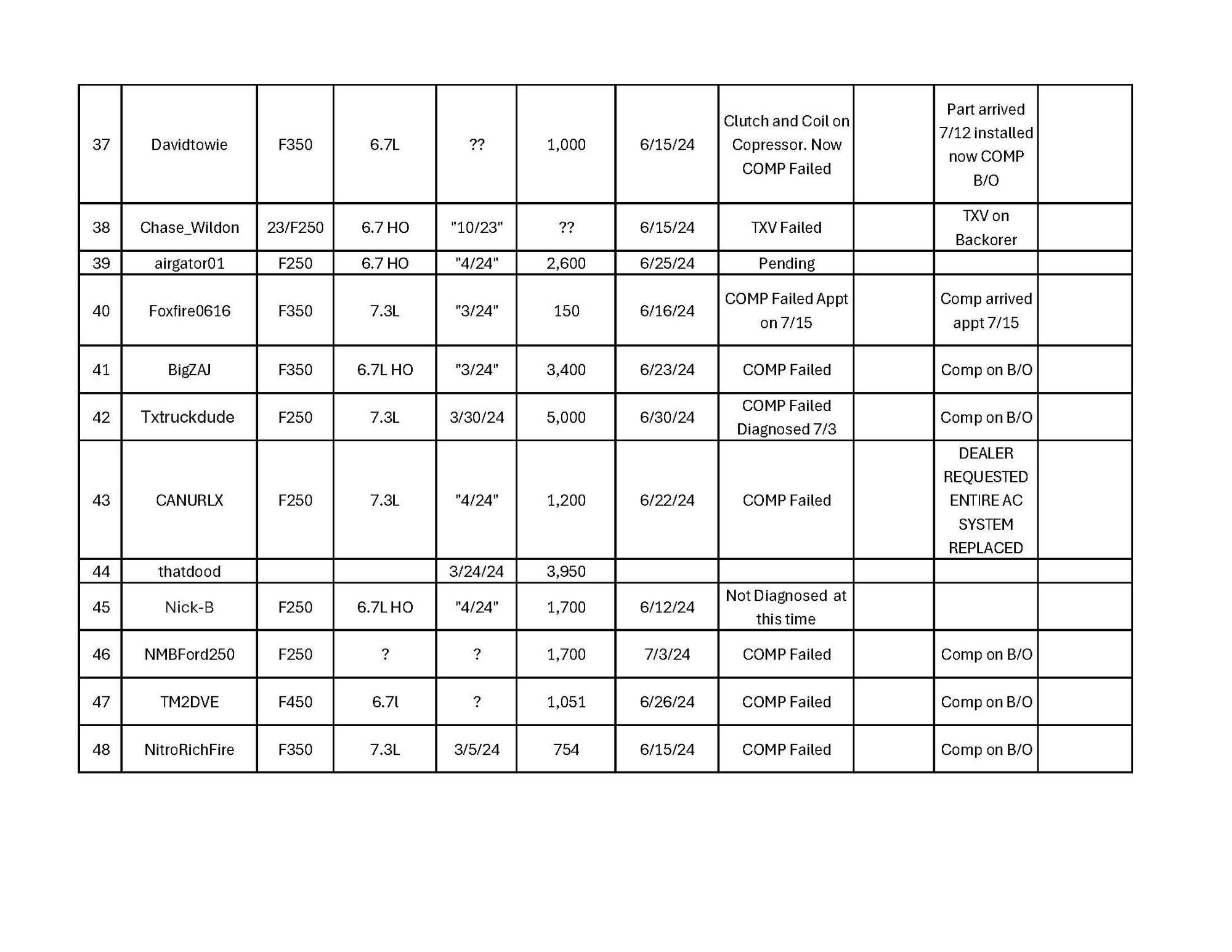

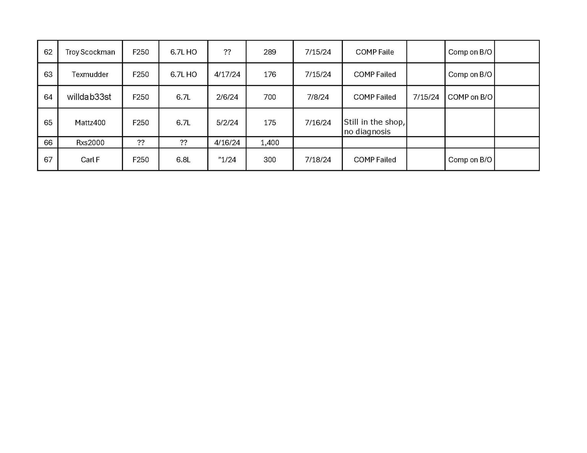

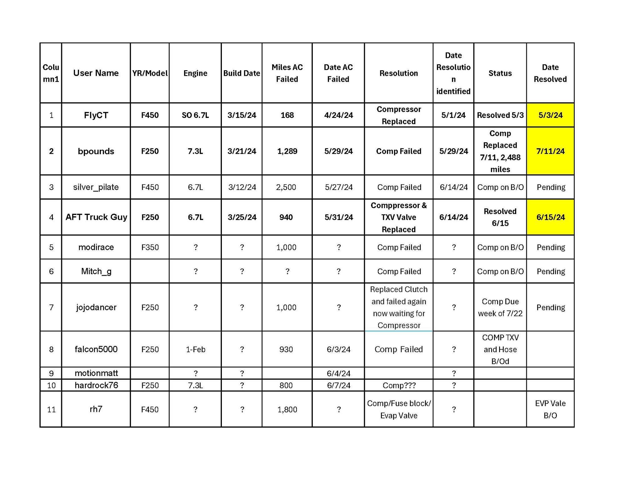

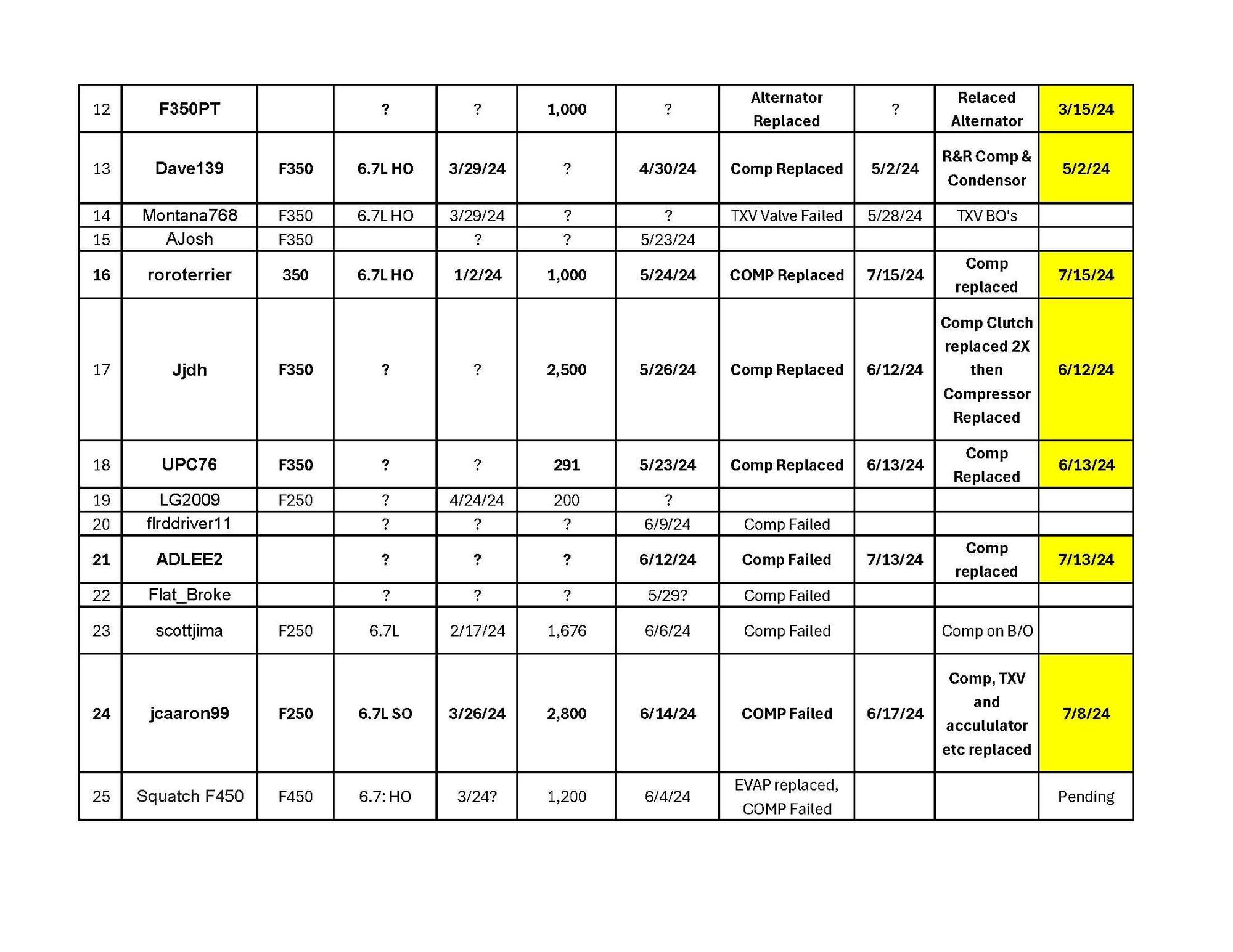

Originally Posted by Flyct
THE LIST IS GROWING.
COMPRESSORS ARE STARTING TO ARRIVE!
UPDATED 718/24
As of 7/18/24 we are up to 67 reported AC Failures only on this Forum. And 14 of the 67 have been reported as repaired.
If you had a 2024 Super Duty delivered with early AC Failure please report details here. That way we can track the problem
I’ll put a spreadsheet together and will update it on this posting as members report. Some were pulled from other threads and postings on this forum
Post the following:
  • Model, Trim & Engine
  • Manufacture Date
  • Odometer miles & Date when it failed
  • fix date and resolution
Received my truck back today. Build date was 3/24. I was told by the service manager that Ford released 3,000 compressors for these repairs. Who knows if that is true. I read here on the thread that the number was 1500 released.

*UPDATE to #65
Truck was finally diagnosed on 7/19/2024 with faulty AC Compressor. Dealer advised parts would be 1 to 2 weeks before they came in.
Now that I have the truck back please update the build date to 5/24 according to the door sticker.

After 7 weeks on back order, I dropped my truck off this past Monday for my new compressor. On Wednesdy I was told the tech found metal shavings in the lines. Now the lines on on back order. WTF? Point is order double of everything just to make sure you're covered (:
