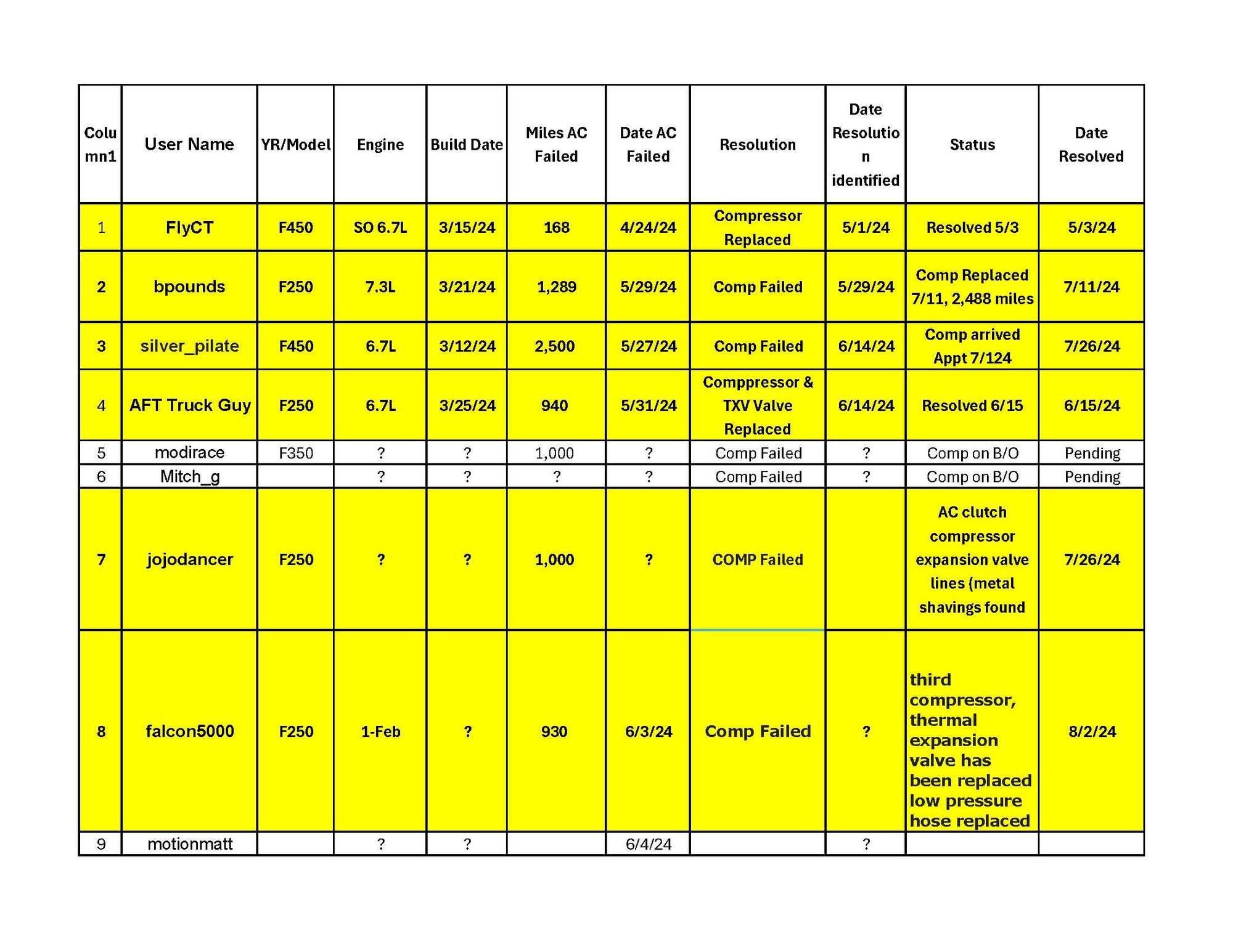

8/18/24 IT'S BEEN OVER 2 MONTHS SINCE I STARTED THIS LIST.
I am going to no longer update the list since it seems that dealers are receiving parts more quickly now.

Not sure if I should post. Not yet resolved. Waiting for a compressor. Please clarify how you would like to proceed. Good idea for a thread BTW.
Post all info and for resolution state compressor back ordered date. I'll input what I can and I'll post a running spreadsheet on the first posting as I update it.
