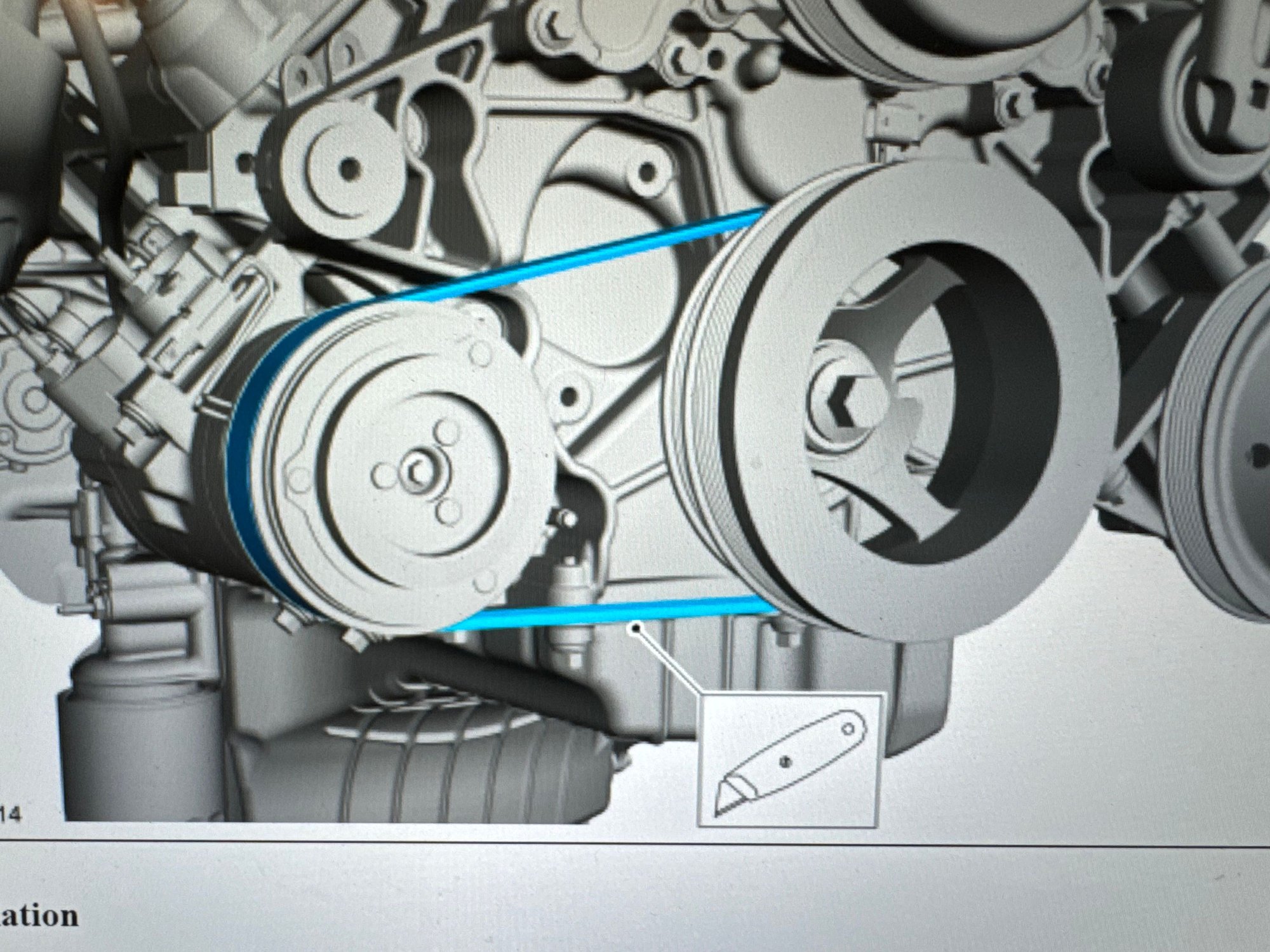

Guys check this out. After 3 months of waiting with no A/C, they ordered the compressor. I never heard anything back so I called to check and guess what? The part had been sitting there for a week! I asked why didn't you guys call me when the part came in? They said they were basically backfilled and super busy and I get that. They gave me an appointment of a week away which was this morning to bring my truck in and they would replace the compressor and I would get the truck back today. Great right?
Well, I just got a phone call from the tech and he said that Ford changed the procedure and now they have to cut off the old belt that goes on the compressor and replace the belt also, WHICH BY THE WAY, they do not have! Didn't you know that, so why didn't you order the belt? Now they have to order a new belt also, and guess what? I have to wait until that new belt comes in which could be another week to 3 weeks. This is a friggin nightmare that never seems to end!
I'm honestly thinking about submitting a complaint and going for the Lemon Law. A truck at this price point that doesn't work and has made me suffer through the 3 hottest months of the year with no A/C is useless. So the f*** what, if they get it fixed in September or October, I've suffered for 3-4 months! The product did not meet the standards guaranteed at the time of purchase.

So after talking with the lead tech at the Ford Truck shop, this is the first time Ford has asked them to CUT the belt rather than just replace it. We think it is because Ford has identified that the belt was the actual cause of the compressors failing. The original belt was adjustable, but this particular belt was a stretchy belt which is not. He seems to think that the belt is too tight, which BY THE WAY explains the loud whining noise that I was complaining about and that other people have been hearing in their trucks. Basically the belt may be too tight and pulling the pulley of the compressor sideways, creating the whining noise and causing the compressor to fail.
Hope this information helps you guys!

Now this is interesting! That would be pretty crazy if all these failures were actually due to a too tight belt. Could well be.

I'm not buying that for a buck. So if this is true, we should see a new belt in the parts diagram. I also think Ford would be issuing a TSB to replace all of the existing belts.

Well the tech did say that Ford just changed the procedure to repair this issue as of Wednesday. My repair was scheduled for Thursday but he could not complete it because Ford mandated that he CUT the old belt and replace it. If you don't think this is a contributing factor, why do you think Ford is telling the techs this?

I just bought a 7.3L last week and I'm holding my breath on this issue. I also bought a service manual for the truck and there are 2 belts on the 7.3. The belt that drives the compressor is the only thing that inner belt drives and there is no tensioner on it. The procedure says to cut the belt with a box cutter to get it off. You then slide the new belt on and wrap it around the compressor then slide as much as you can over the crank pully and then use a tie wrap to hold it in place on the crank pully. You then turn the motor by hand to slip the rest of the belt over the pully. It's a short belt so maybe it doesn't stretch much over time. I can't believe you can't adjust the tension with some bolts on the compressor.
