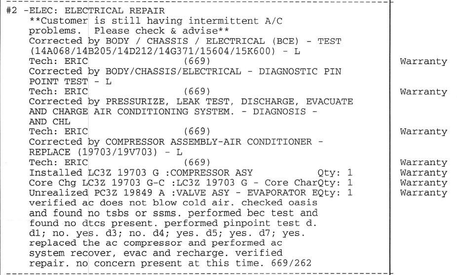

Line 26 A/C repaired.
I got my truck back 7/16/24. A/C is blowing colder than new. Expansion Valve, Compressor,Evaporator, v-belt, and Tube assembly replaced. System was flushed. We will see if it holds up. Line 26 in spreadsheet.

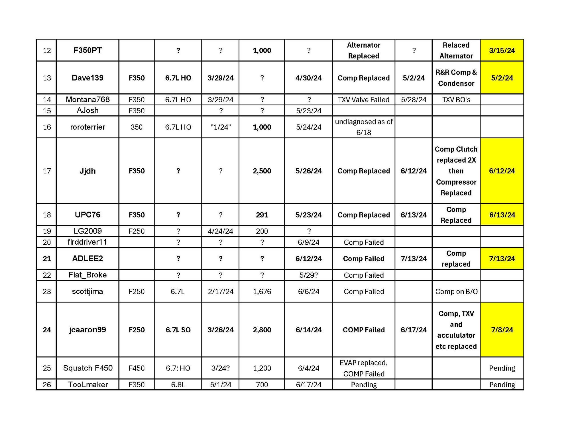

Line 16 on spreadsheet.
Fix Date: 06/15/2024
Please update my exact build date to 01/02/2024
I wasn't able to give the exact date originally because truck was in shop and I didn't have access to it.
I received a new compressor and it was installed last week and I picked truck up Monday. I've driven it for 2 days without any issues. So far so good and appears to be fixed.
I'd been closely monitoring my temperatures during this entire fiasco and temps from vents with the new compressor as still exactly the same as they where when the bad compressor was working. My thermometer shows 40 but the tech was reading in the 30's. Probably just a calibration issue with my cheapo thermometer. But, it's icy cold, so I have no complaints. All this was just to say, I'm not seeing any issues post compressor replacement and everything is working as expected.
I do notice it gets cold much faster. AC is ice cold almost from the start. Before, it would blow hot air for longer than seemed reasonable. Remote starting gets the thing cool quickly where, before, sometimes it would be cool and sometimes not. Basically, the intermittent nature of the failure would make remote starting / pre conditioning a crap shoot. The vent temps would also slightly elevate at stop lights. That has gone away as well. Cold air is remaining consistent while drive and while stopped at lights.
All good stuff.

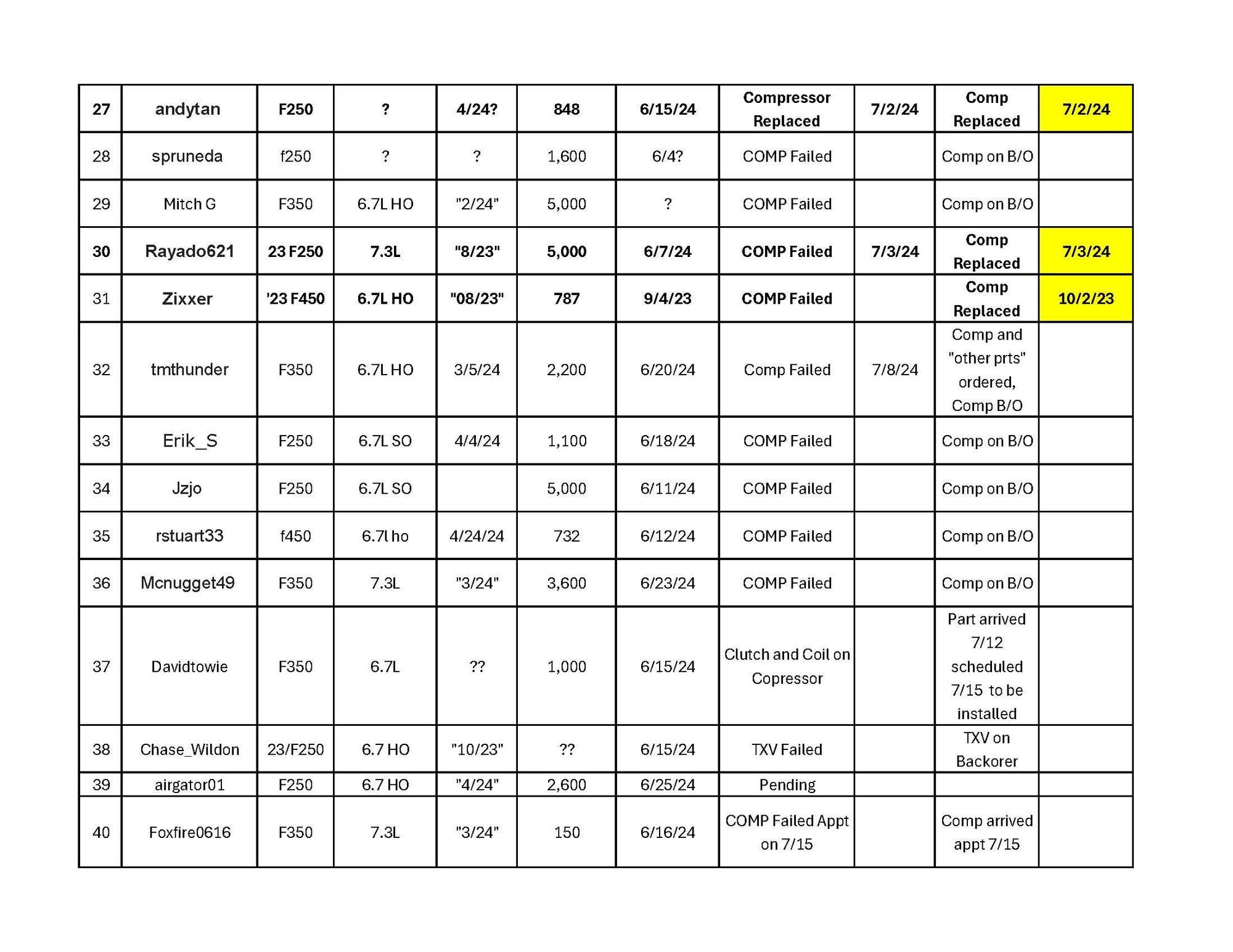

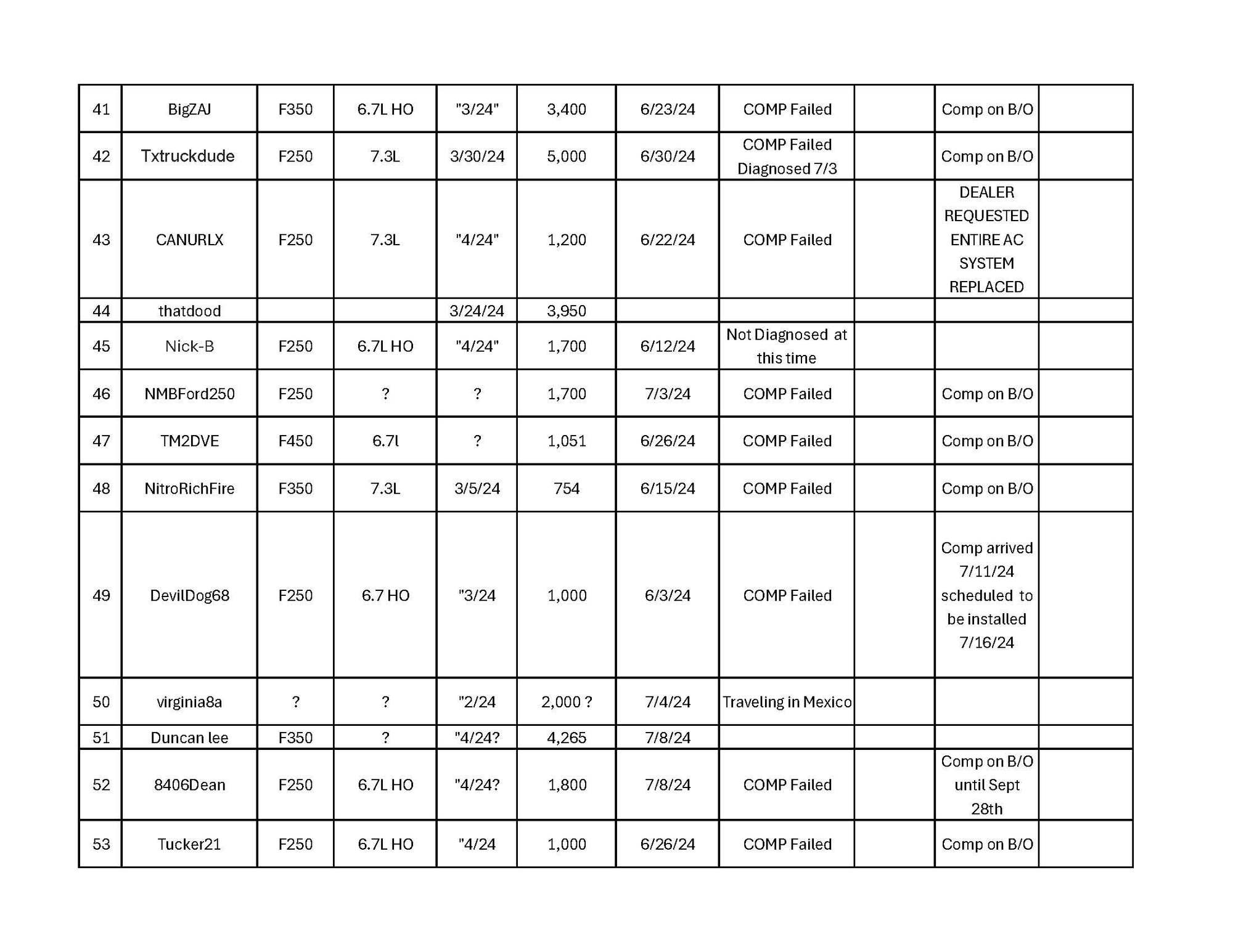

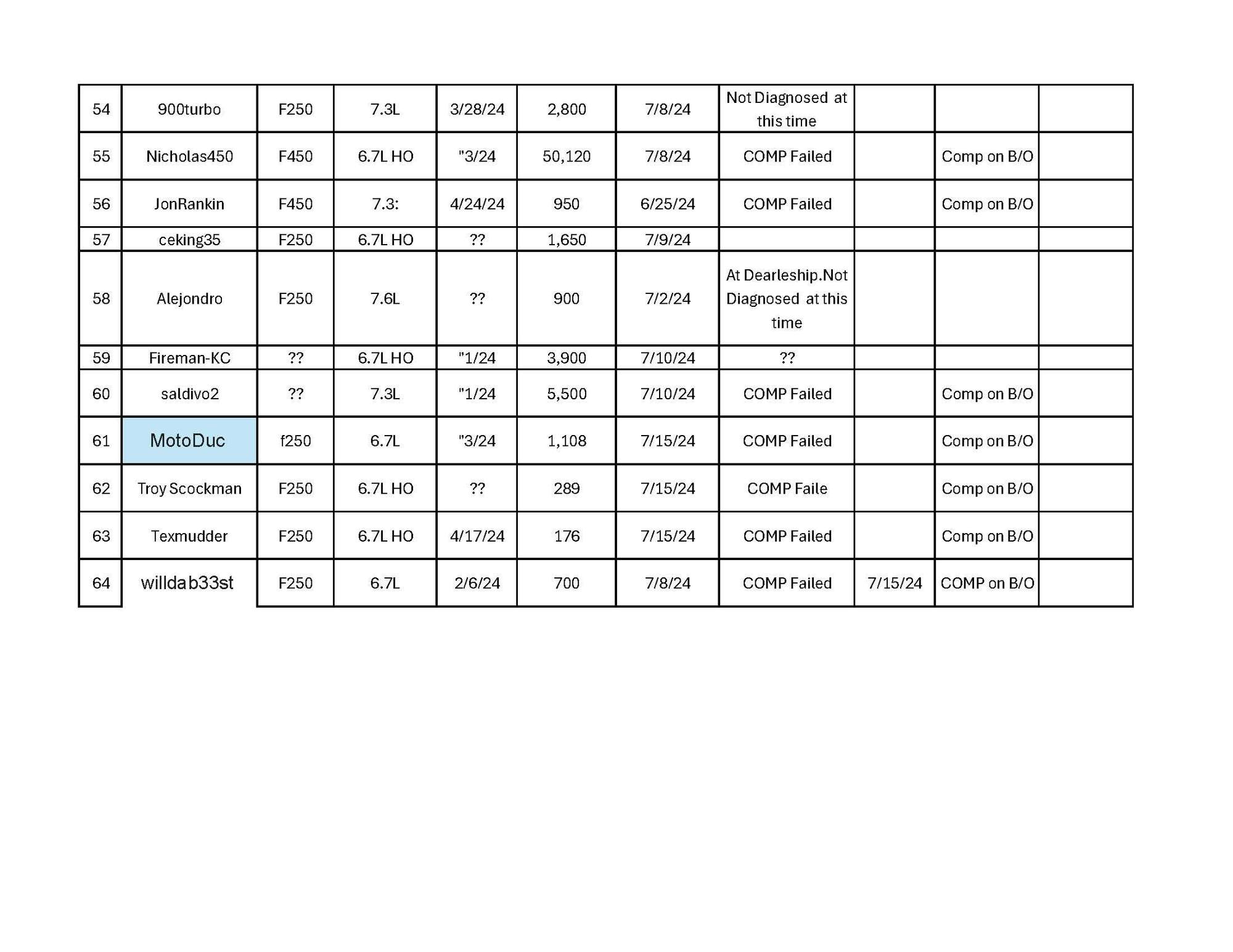

As of 7/16/24 we are up to 64 reported AC Failures only on this Forum. And 12 of the 64 have been reported as repaired.
If you had a 2024 Super Duty delivered with early AC Failure please report details here. That way we can track the problem
I’ll put a spreadsheet together and will update it on this posting as members report. Some were pulled from other threads and postings on this forum
Post the following:
  • Model, Trim & Engine
  • Manufacture Date
  • Odometer miles & Date when it failed

It is a wonder that Ford does not issue a stop sale on any further sales or deliveries of Super Duties built with this compressor, given the consistency of compressor failure at low mileage.
It seems like it isn't a matter of if an AC Compressor in a 2024 Super Duty built during a certain time period will fail... it is simply a matter of when.
And the "when" could depend on how much or how frequently the AC Compressor is run. Many fail within the first month of ownership. Some fail sooner than others. Why is that?
One of the data points that would be useful on the spreadsheet is location, as that would help us correlate if the variance in mileage to failure (between 300 miles to 5,000 miles) could be linked to amount of use of AC, which could be correlated to the climate the truck is operated in.
The question location data might answer is:
Do AC compressor failures in Florida happen earlier (in the 300 mile range) than AC compressor failures in Canada (in the 3,000 mile range)?

We don't know what the failure rate is as a ratio. We have less than a hundred reported here, and Ford was building 20,000 or more SD per month. Some reported here are new members who only came here because they googled their issue. I think it is a small percentage, far from a when not if situation. Too many of course, but not most.
