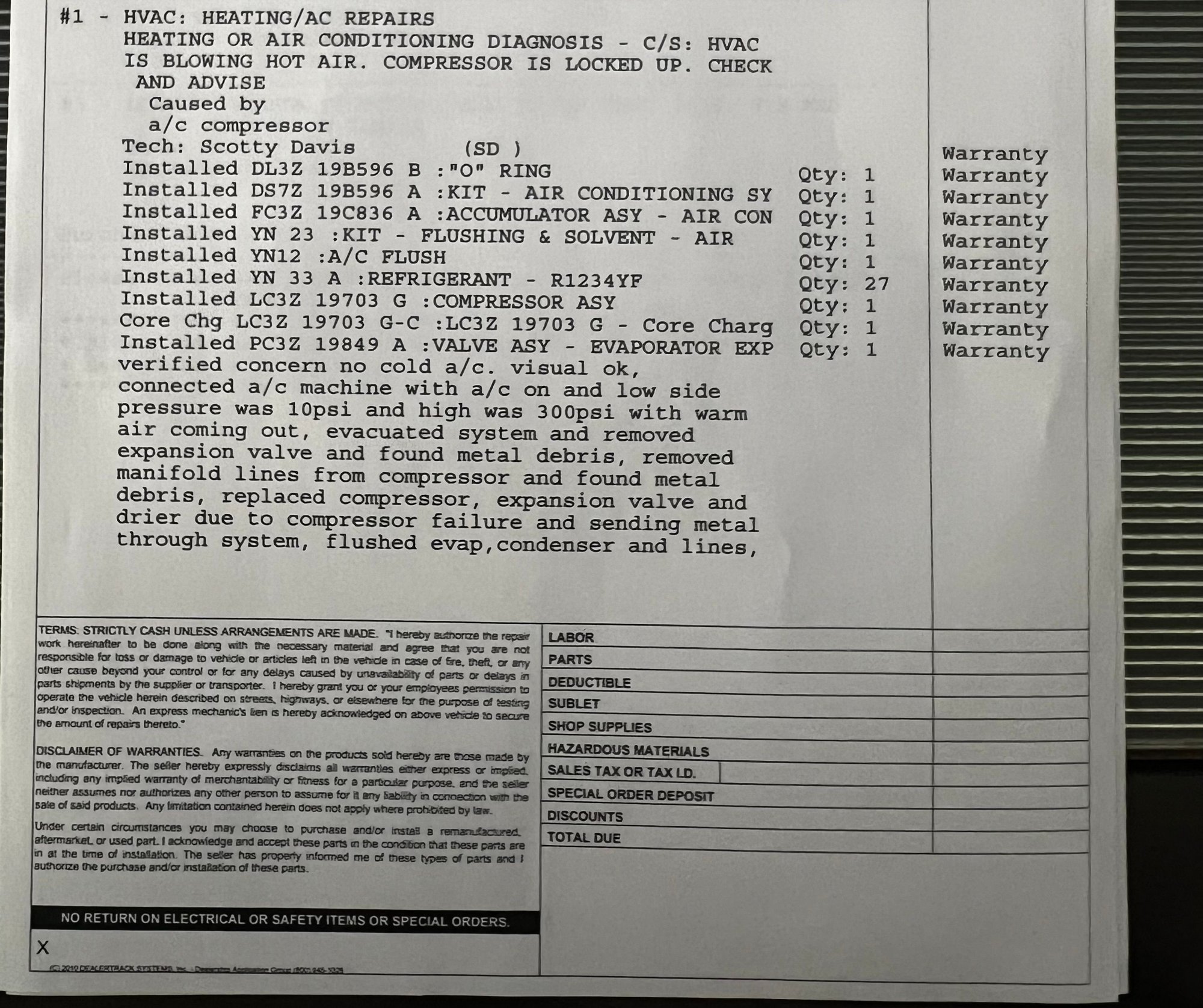

Yeah im calling BS on this one. Just had my 2024 F350 Platinum with 4200 miles on it, returned from the dealership with the AC fixed. They found my compressor seized. It did take approx 3 weeks from the time I called LHM Ford in Mesa AZ about the issue to the actual repair taking place. No mention of a belt issue, the same belt was used after the AC system was repaired which required:
Compressor
Desiccant bag in condenser replaced
TXV Valve replaced
Flushed AC system Evac & recharged
I believe some smaller dealerships are having to wait longer because they just don't have the pull as a larger dealership.

Update #65
Repairs completed on 8/16/24. Below is a list of what they did. So far AC is working well. Only driven about 50 miles so far.

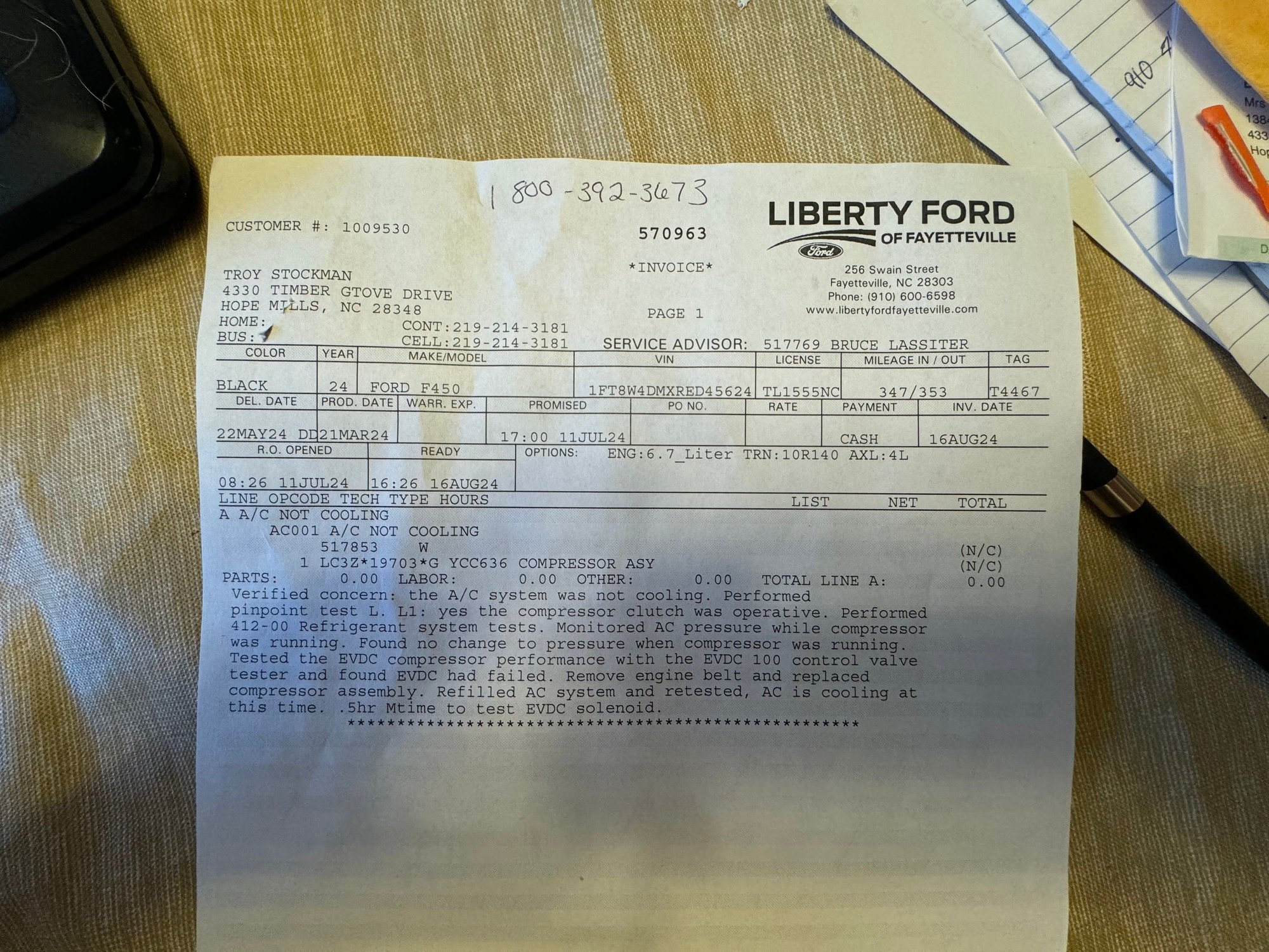

Ford F450 Compensation
So I am one of many who had the AC compressor on their new 2024 F450 Limited go out with only 347 miles on it. I dropped it off 11 July and wasn't able to pick it up until 16 August. I was offers no, loaner vehicle, I had to cancel a family vacation, due to having no vehicle to pull my 5th wheel, after getting my truck back, the dealer gave me the customer support number for ford direct. I called the number, explained my frustration only to be hung up on. Next I went to Fords sight and expressed my issues with them via chat. I was told it is the responsibility of the dealerships to take care of everything, which to me says they do not stand behind their product. The dealer didn't order trucks knowing they would break down nearly immediately. Now I am just trying to figure out what my options are. Any help
is appreciated.
