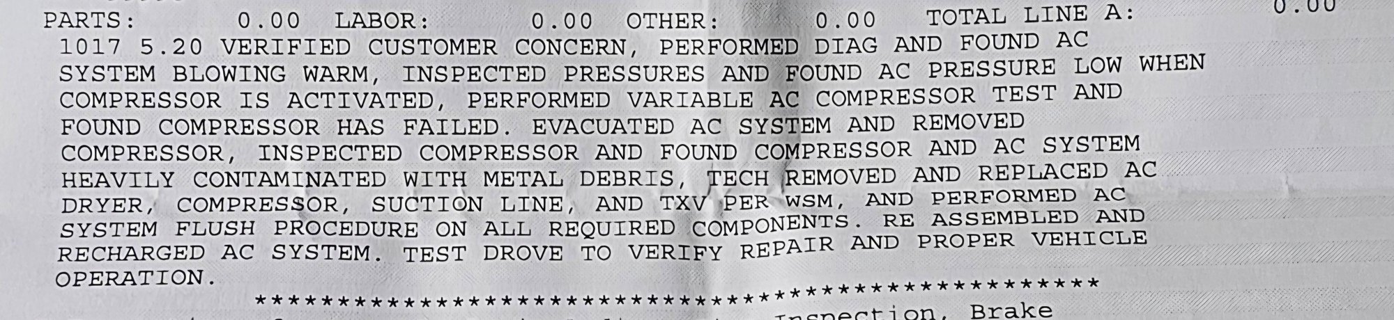

@bpounds
Congratulations on your repair.
Can you please post your service work order, so that members who are similarly affected can compare work orders to see what is common, and note what is different, between repairs by various dealers to fix the issue?
For example, it would be instructive to compare your work order with the work order posted by jcaaron99 upthread in Post #151.

Originally Posted by Y2KW57
@bpounds
Sure, here it is. Just the compressor and the other two parts are just the seals for hose connections. I was happy to see that the tech confirmed he had checked for debris and found none. I just have to take his word for it and hope he is right. Happy with how my dealer handled it all. I had the work done at the dealer whom I purchased from, and they are not the closest one to home. I think that gets you a little bit of good will compared to another dealer.

Here is my my service invoice.
The last digit number for the compressor is different because mine is on a Diesel.
The o-ting part numbers are the same.
