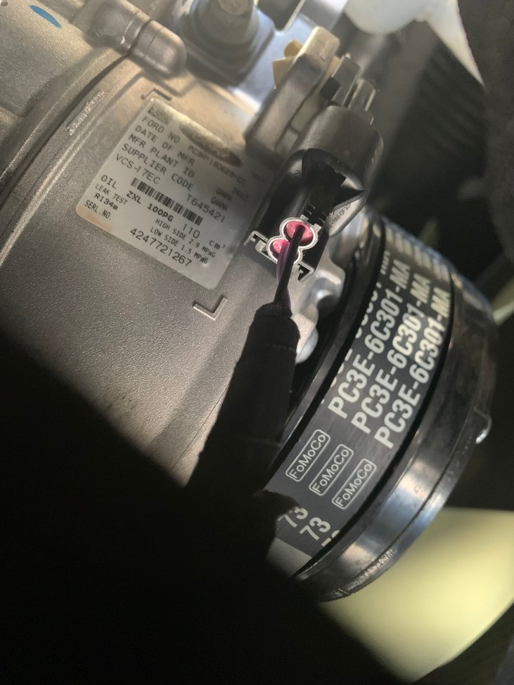

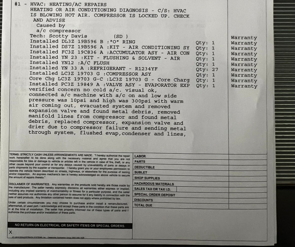

I'm curious IF or why YN 33 A : Refrigerant R1234YF was utilized, per the Repair Order posted by @Mattz400 on August 17, 2024 in Post #335 of this thread:
I would like to see the tag on the AC compressor itself in this instance, which identifies the refrigerant called for.
Some users reported that their 2024 Model Year A/C system still uses R134a, not the newer R1234, as shown above.
It may be necessary to use a creeper to slide underneath the truck to see the label on the A/C compressor, as @*TooLmaker* did when he took this photo below, as originally posted on June 22, 2024 in Post #51 of this thread:
I wish more members with this problem would post a photo of this label... and a clearer one at that, so that the SUPPLIER CODE and MFR PLANT ID was legible.
Multiple photos from many different persons similarly affected might help this community identify if the SUPPLIER CODE and MFR PLANT ID of their REPLACEMENT compressor matches the SUPPLIER CODE and MFR PLANT ID of the FAILED compressor.
And we can still use more verification of which refrigerant is utilized... since we now have conflicting information from dealership service records (R1234), versus the label shown on the above sample compressor (R134a), where both vehicles are 2024 Super Duties.

I will try and get a pic this evening. Good eye on the refrigerant. I hadn’t even noticed the change in type.

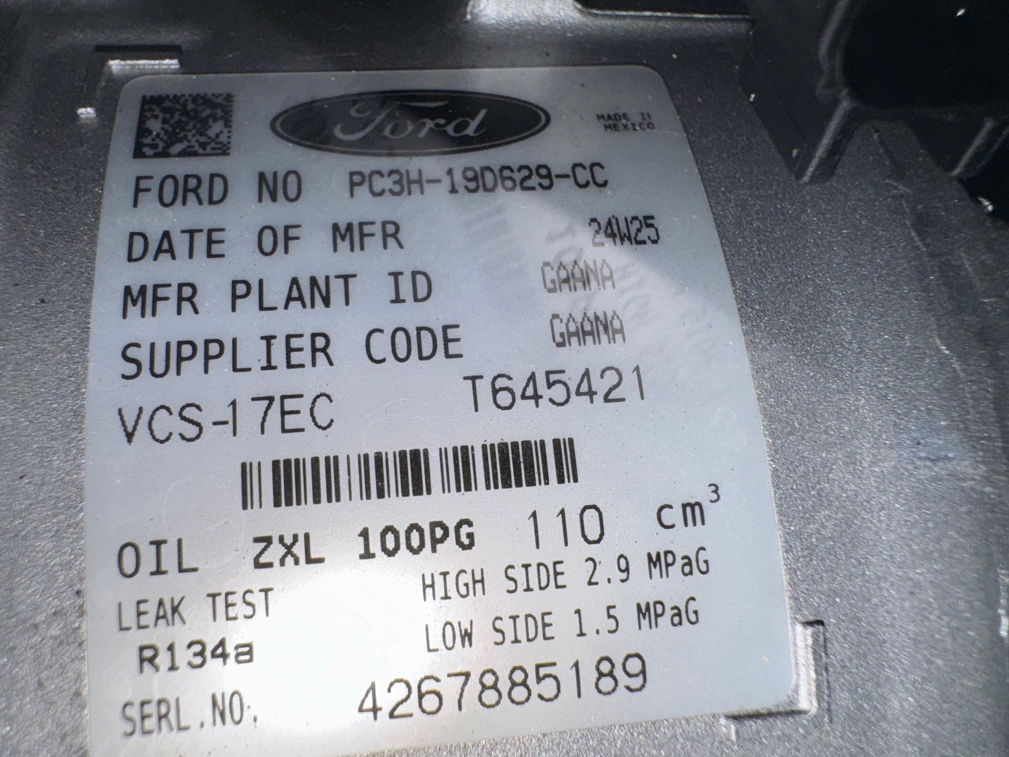

I'll add my compressor label to the mix even though I haven't had an issue yet. My compressor was built on week 25 of 2024 so that week started June 17th. My truck was assembled on July 8th. I'll certainly update if I do have an issue but maybe earlier compressor builds will post their date and we can narrow down the bad date range.

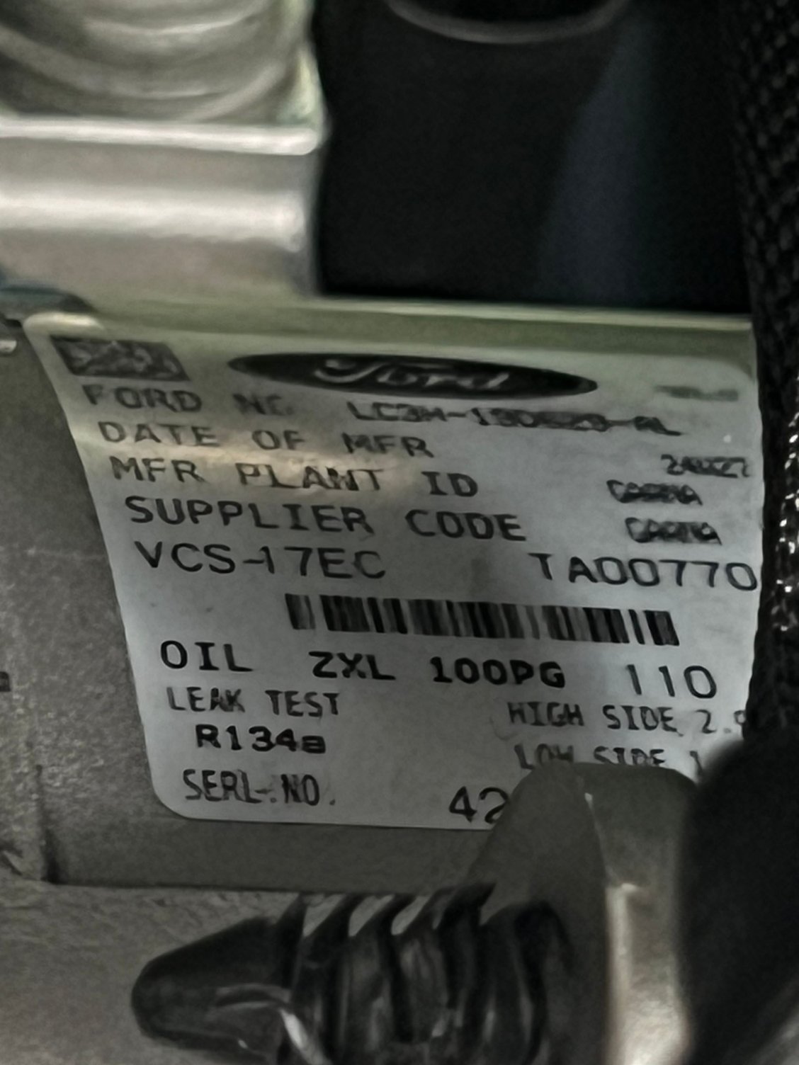

I am not having any issue with my A/C but here is a picture of mine from a 2024 F250 with manufacture date of Feb. 2024

Thanks for posting that. One thing I notice is the part # at the top of the label has different revisions. Yours ends in -AL and mine in -CC. If I'm not mistaken I think that might show changes to the compressor. Not sure if it makes any difference but mine is on a 7.3L.

Originally Posted by Mattz400
@Mattz400
Please let us know what your servicing dealer says
after you present them with the photo of your compressor label
(showing R134a) that they themselves installed,
and also present them with the Repair Order
(showing R1234) that they themselves prepared and submitted to Ford.
Your dealer also used kit YN 33, appropriate for R1234,
whereas everyone else's repair order showed kit YN 23,
which is the correct kit to use for R134a.
Curious what your dealer will do.
