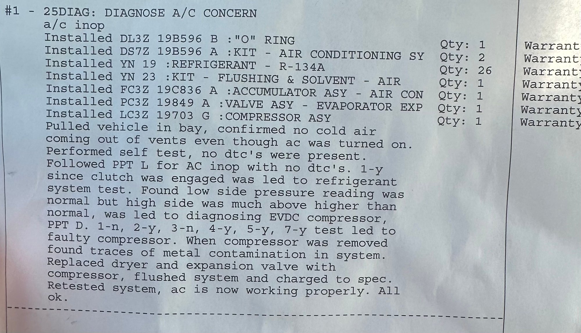

Originally Posted by Flyct
@jcaaron99 if able can you post a picture of your service invoice showing which parts were replaced?
here is the repair sheet
Old Jul 10, 2024 | 10:05 AM
  #152
5picker's Avatar
5picker
Joined: Apr 2024
Posts: 186
Likes: 123
From: SW PA
Originally Posted by jcaaron99
Update:
My truck has now been fixed. Compressor replaced, metal in the system, replaced evaporator etc as well. Took it to dealer and had diagnosed on 6/17 repaired 7/8.
I see nothing in your repair sheet that indicates a replacement of the evaporator. (or the condenser)
They replaced the evaporator expansion valve the dryer, the accumulator and the compressor and flushed the rest of the system.
