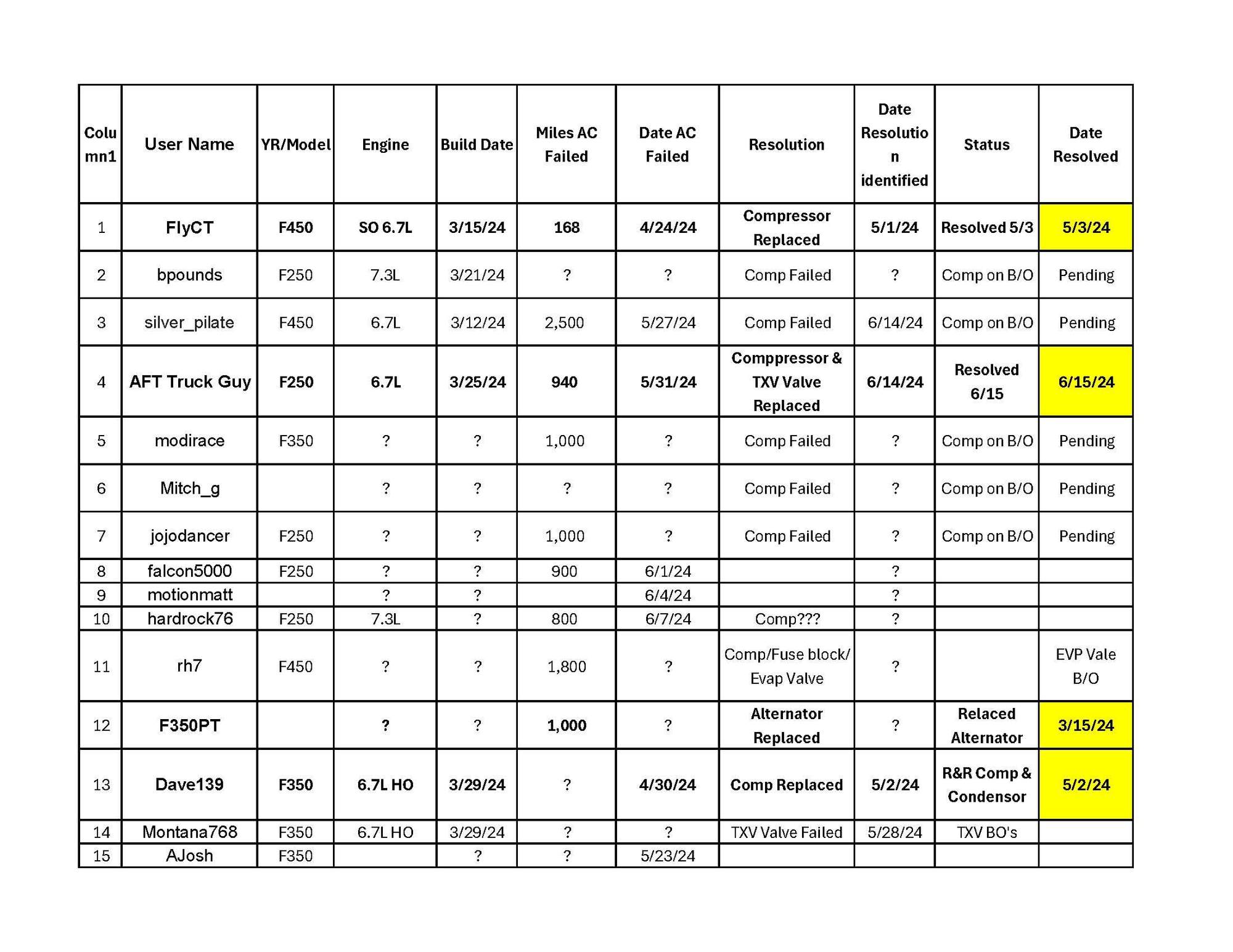

[QUOTE=Flyct;21255719]THE LIST IS GROWING.
UPDATED 6/20/24
As of 6/20/24 we are up to 31 reported AC Failures only on this Forum. And only 7 of the 31 have been reported as repaired.
If you had a 2024 Super Duty delivered with early AC Failure please report details here. That way we can track the problem
I’ll put a spreadsheet together and will update it on this posting as members report. Some were pulled from other threads and postings on this forum
Post the following:
  • Model, Trim & Engine
  • Manufacture Date
  • Odometer miles & Date when it failed
  • fix date and resolution
I’ll start
2024 F-450 Platinum SO Diesel
3/15/24 manufacture date
168 Odometer miles and 4/23/24 when AC failed
Compressor replaced 5/3/24

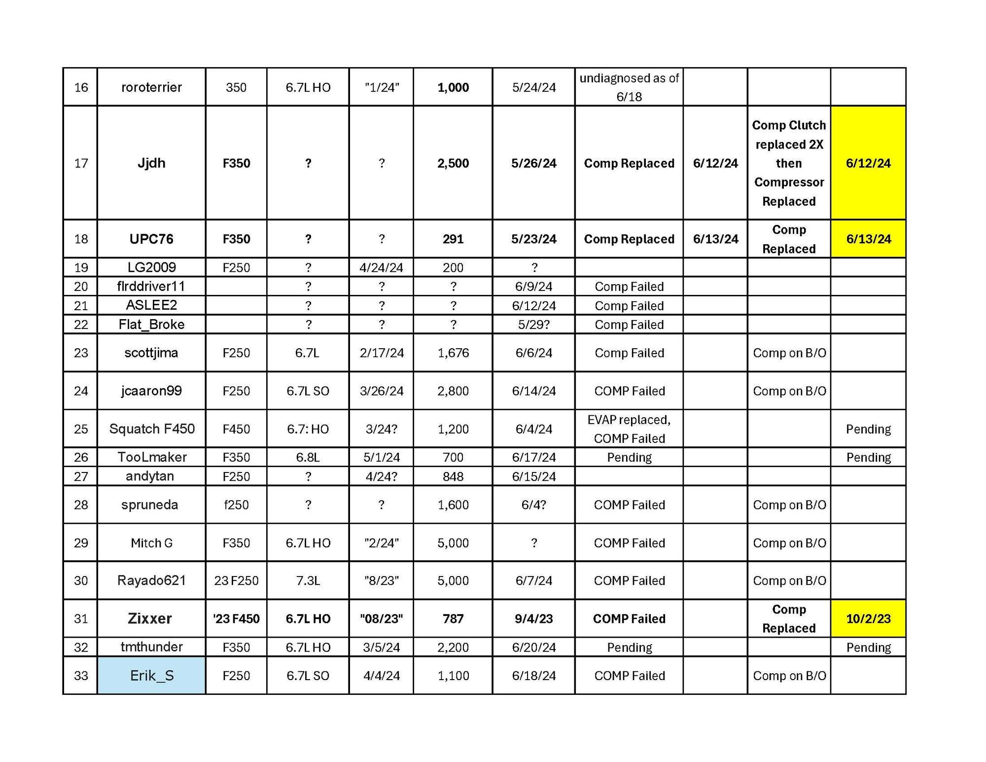

F-250 Lariat 6.7 SO
build date 4-4-24
Purchase date: 5-29-24
COMP failure date: 6-18-24 at 1,100 miles
Status: Back order
UPDATED 6/20/24
I see some engine type slots in the spreadsheet are blank (?) but there's certainly a bigger number of 6.7s on the list than others. Do they use a different compressor?
Not all entries were provided with engine, model etc. I put entered all the info I could find.
Good question about compressors being same or /different on each engine.
My 6.7L 2024 took a COMP Part Number LC3Z-19703-G on the repair invoice.
My 6.7L SO

Well sadly I join the group today.....
2024 F350 Platinum Tremor 6.7HO
Build was first week of March 24' took delivery 1APR24
2200 miles on the clock north on 95 in 95+ degree temps this afternoon it started blowing hot air and the cooled seat was also blowing warm air.
Contacted my sales guy to let him know as it was after hours. Will call the service department tomorrow morning. Best part is I was in the service department today showing them the loud noise from my wireless charging pad. Less than an hour later A/C was gone....
Brian

EVERYIONE:
PLEASE POST AND UPDATE WHEN WHEN EITHER DIAGNOSED OR REPAIRED. I WILL UPDATE THE SPREADSHEET THE INFO.
THANKS
Flyct "Jerry"
UPDATED 6/20/24
As of 6/20/24 we are up to 33 reported AC Failures only on this Forum. And only 7 of the 33 have been reported as repaired.
Post the following:
  • Manufacture Date
I’ll start
2024 Lariat 6.7 SO F250
AC failed at around 5k miles on 6/11/24
same symptoms as everyone else. Dealer said system passed all tests. Took it back 2 miles later.
compressor on back order. No ETA on delivery date.
Pissed
