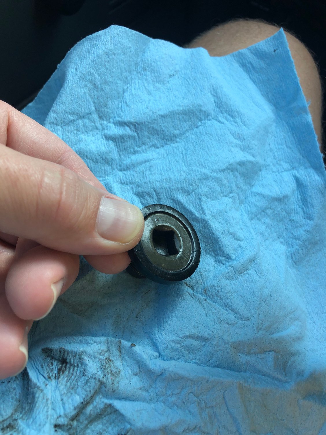

Appreciate the words of encouragement. We were supposed to use the rig for a camping trip first weekend of August so it hit a bit hard realizing that, after all this work, that wouldn't be happening. Today made some calls and a, local performance diesel shop recommended an experienced rebuilder. Didn't speak long but what he said sounds good at 4k complete cost, and can fit us in soon. Feeling a little more hopeful today.
@KubotaOrange76 thanks a bunch for the offer! PM sent.
@RacinJasonWV given the size of the shard I'm thinking part of a retainer ring. Who knows how long it's been in there, though I wouldn't be surprised if it's recent since the truck went from having less than stock power to more than stock. Currently using a Hydra with the PHP tunes. I'd love to try and rebuild the thing myself but lacking a shop and some of the more specialized tools prevents me from taking that route.

@PriusLover , I too am sorry to hear of your new issues. Unfortunately, that is how things usually progress when buying a 20-yo used truck. You fix one thing only to find the next weakest link. Don’t feel bad. You’ve probably headed of months of issues with the work you have already done. I went the more traditional route when I bought my truck and took care of issues as they arose for the next 3 years. Mind you these were issues that affected the basic functioning of the truck, not go fast bits.

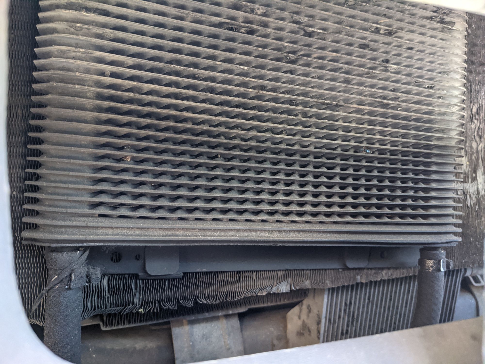

Is the local shop replacing the cooler as well, they probably should even if it is new. I am pretty sure that is the recommended course of action when the 4R100 is showing debris in the pan as yours is.
They didn't ask about it. The stock cooler on the truck was bypassed by the prev owner. Because it's an E99 and doesn't have the OTW cooler in the radiator, this is all the cooling the transmission had evidently:
So in addition a transmission I'll need a OTA cooler, new radiator with the OTW cooler, and the lines to plumb it all up.
Recommendations for the cooler and rad? Non-Ford units reliable? For the 6.0 cooler it seems the aftermarket versions might not have the turbulators? For the lines I found this:
