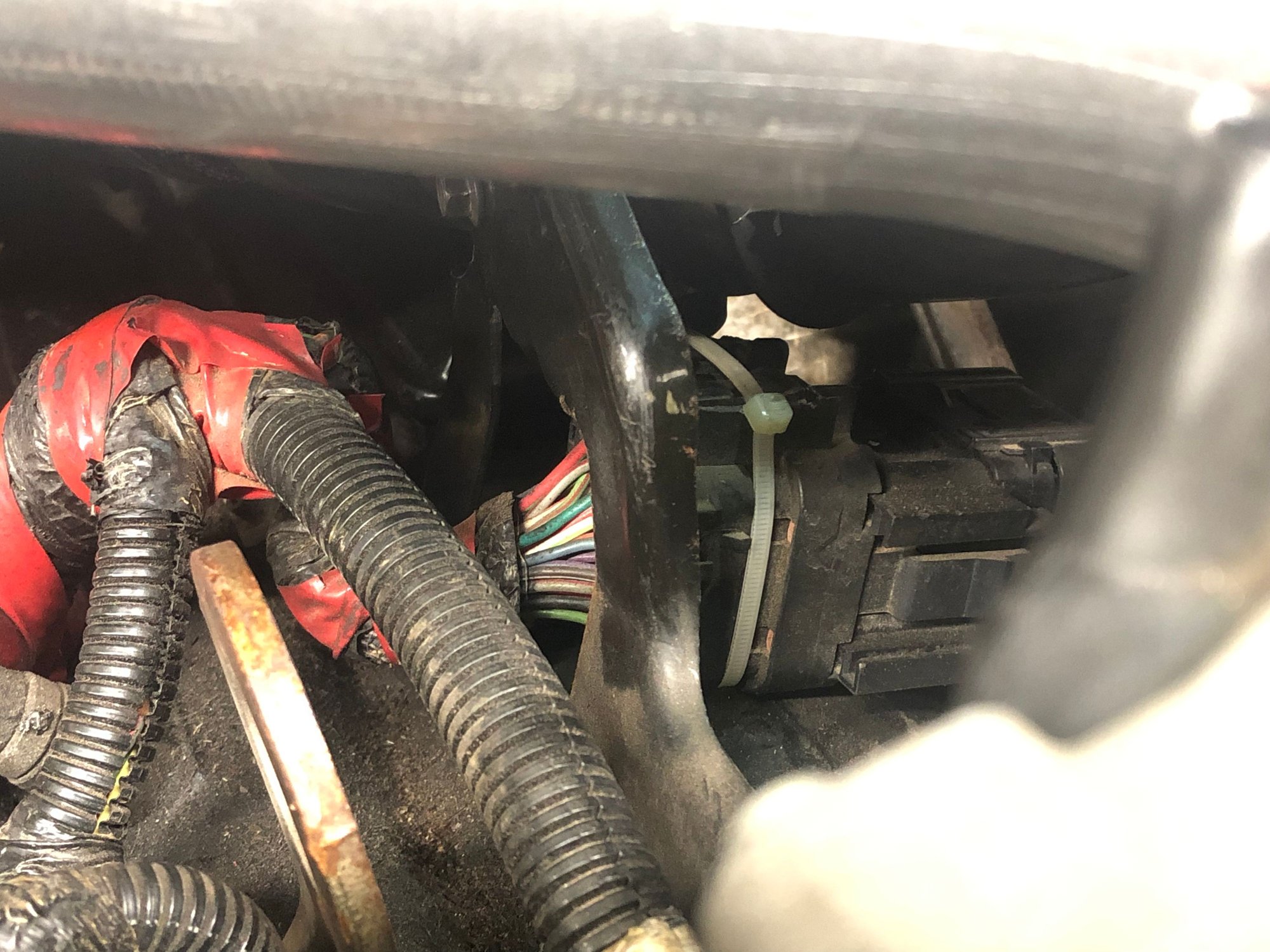

So those splices aren't stock? Must have been a PO modification.

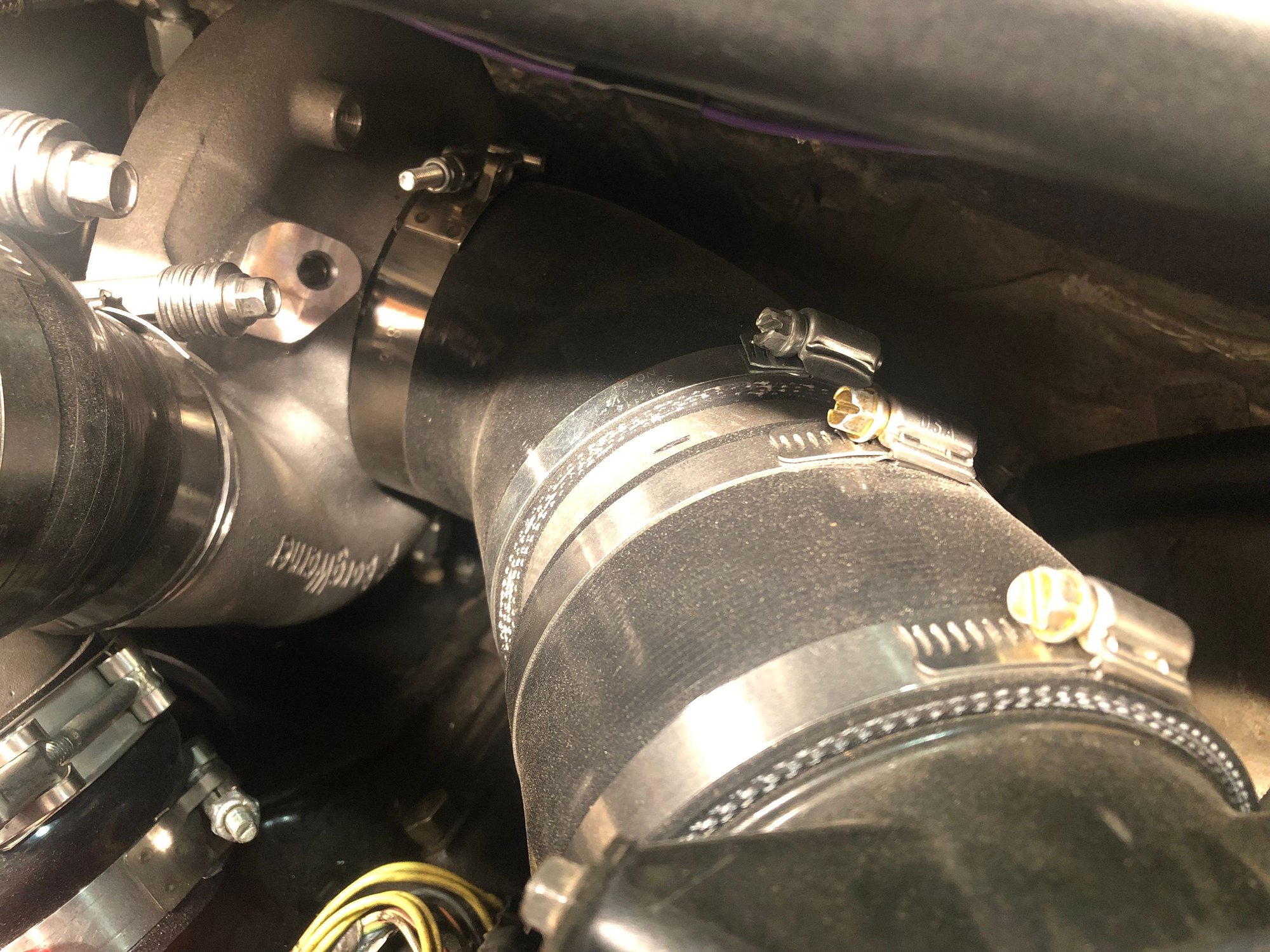

I'd like to hear it fire up too but a succession of issues seem to be delaying that from happening. Here's the latest:

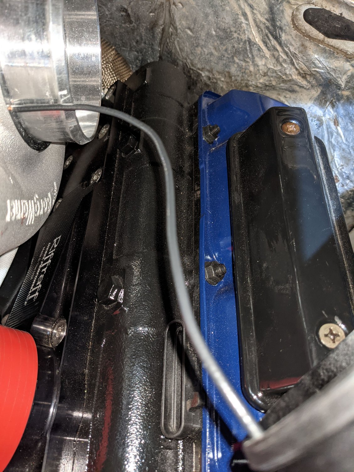

The trimmed 45 degree boot idea that @ESwift and @RacinJasonWV doesn't seem to be working here. No idea why. Perhaps the Irate mount has the turbo in a slightly different position?
This wire shows the ideal path. Seems like a 90 degree and a 45? I'm not sure if I should try and get some pipe bends welded up or if using angled boots would still suffice.

It requires a twist of the CCV tube bracket. Use a crescent wrench to twist it just enough to line up.

Ah I see. I must have missed that part when looking things over.
I did some mock ups and I think I can make it work without bending the bracket by using a 90° aluminum elbow and 45 degree boot. To me that'd yield a better flow in to the turbo since the air is not coming at the intake at an angle.

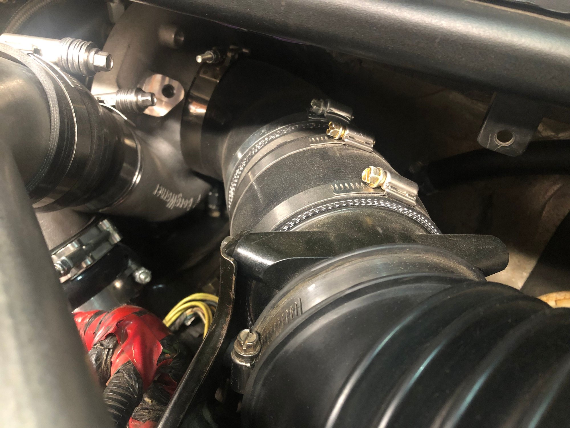

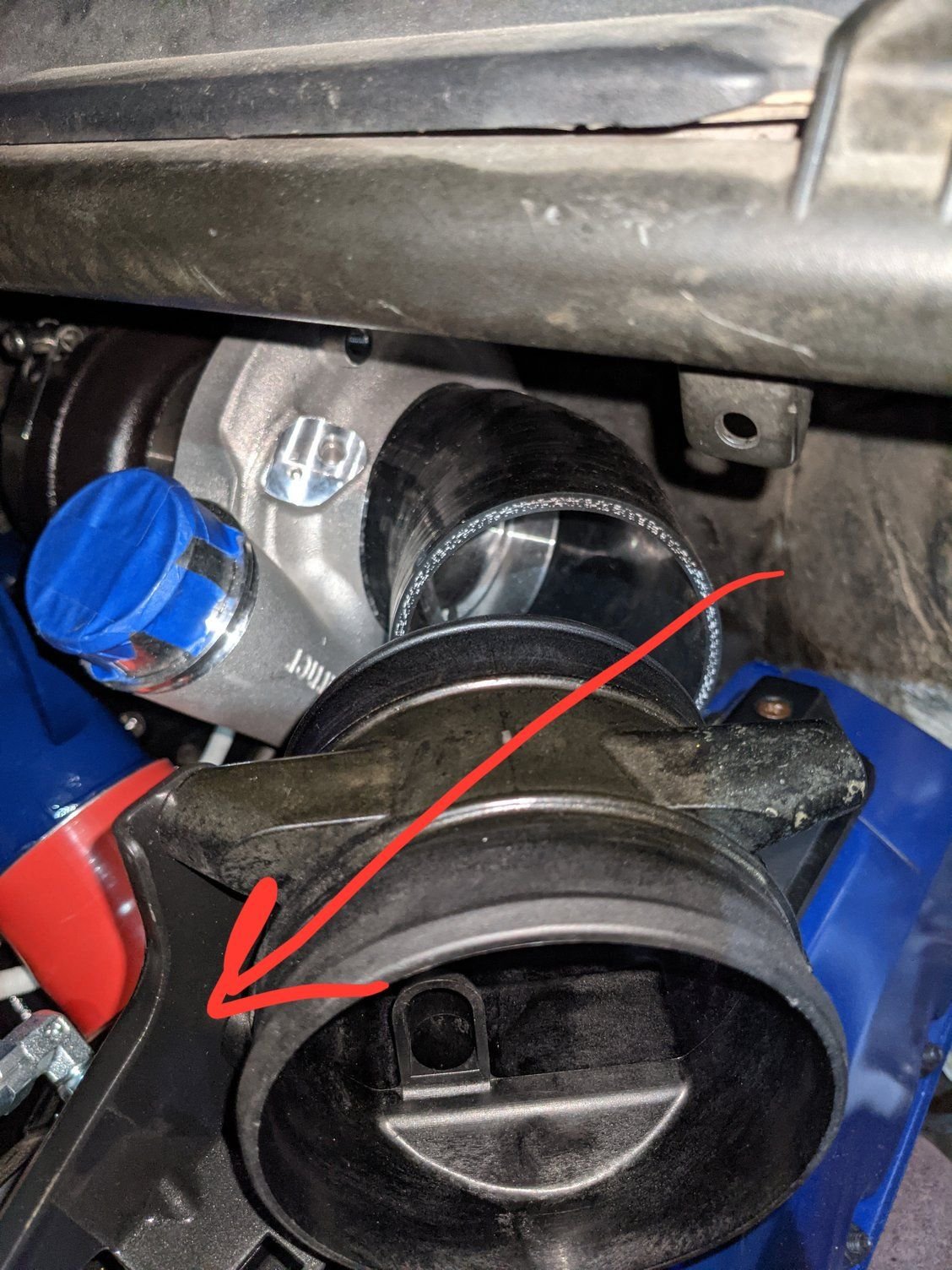

Popped a few photos for you for reference.

@PriusLover , do you have to have that factory transition piece that bolts to the bracket? If not, get rid of it and create a much straighter tube from the airbox to the turbo. This will also give you more room to position the hot side CAC tube away from the back of the alternator.
No emperical data to support this but my left over physics knowledge tells me the hood in there serves a function wrt flow characteristics and/or regulating the amount gasses admitted in to the tube, and that it'd be ideal to retain it if I can. It would have cost Intl/Ford less to just have a hole, but they spent the money on extra plastic and mold complexity to make it.

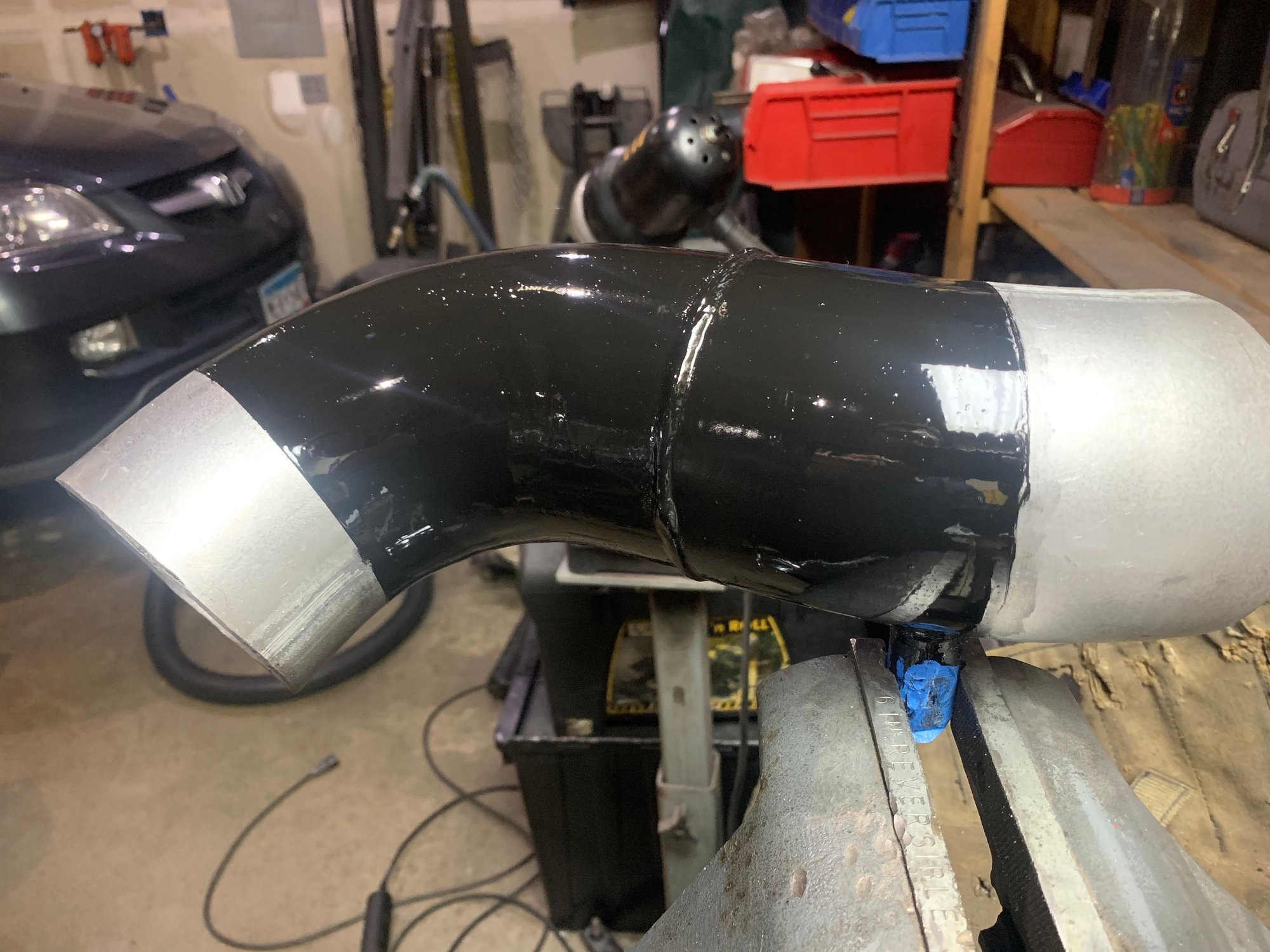

Understood. FWIW I have a simple side tube in my intake for the CCV that is flush on the inside. I have not seen any higher oil consumption than before.
That stub held in the vice is the CCV tube.

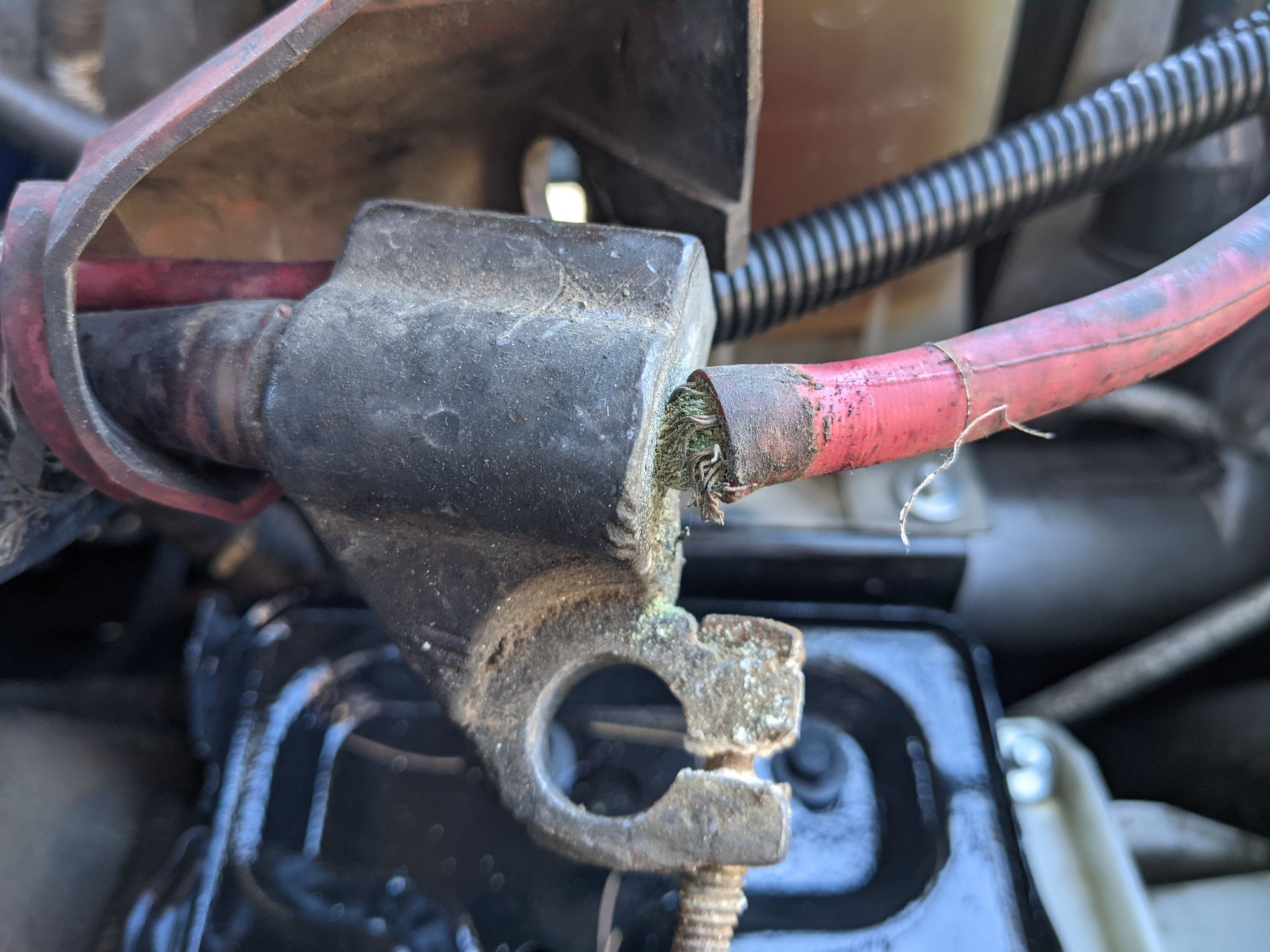

Started replacing the battery terminals but found that the lug sizes specified in another FTE thread didn't fit at all. So will have to get the correct ones (will be sure to document the ones I used).
Existing terminals look rather nasty:
Oof. I think those cables are beyond a simple terminal replacement at this point. I too resisted buying new cables and attempted to fix the terminals. It became an ongoing maintenance task with electrical gremlins popping up every 6 months or so. I eventually bit the bullet and bought this. The result:
