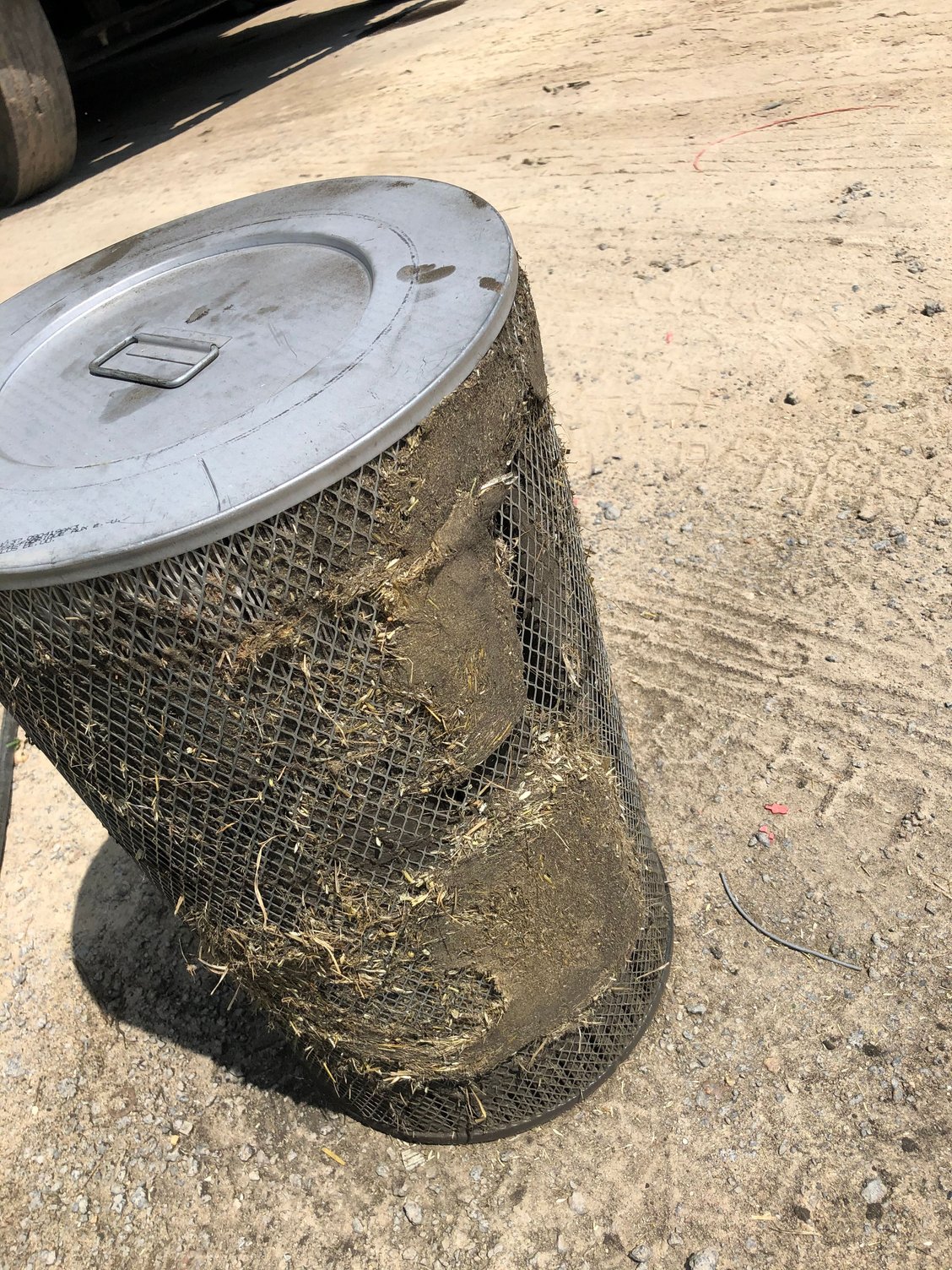

Just to throw my two cents in for the air filter discussion. I've run the AIS, 6637, and currently and S&B. My favorite has been the S&B. With the AIS, after 10-15k miles on the filter, I could pull the filter minder almost all the way on a daily tune. Hot tune would pull it all the way pretty easily. My current S&B filter looks pretty dirty after 20k miles, but I checked my compressor wheel a couple days ago and it still looks fine. Don't currently have the filter minder hooked up with the S&B but might do it in the future. Also, I never had an issue with the 6637, I just preferred the S&B because it's enclosed and it pulls air from the stock locations.
Unless the S&B starts looking like this in the next few thousand miles, I'm gonna stick with the S&B. Also, been a while since I've posted anything on here. Feels good to be back.
