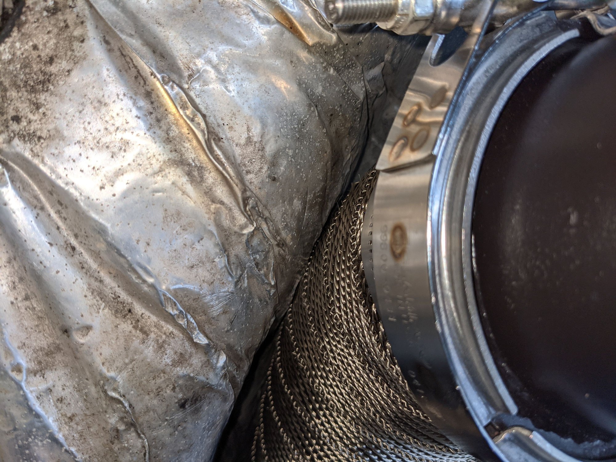

@RacinJasonWV this is as far down as I can rotate the DP while still leaving a little clearance between it and the up pipes/engine:
Even in this position it's still touching the FW a little.

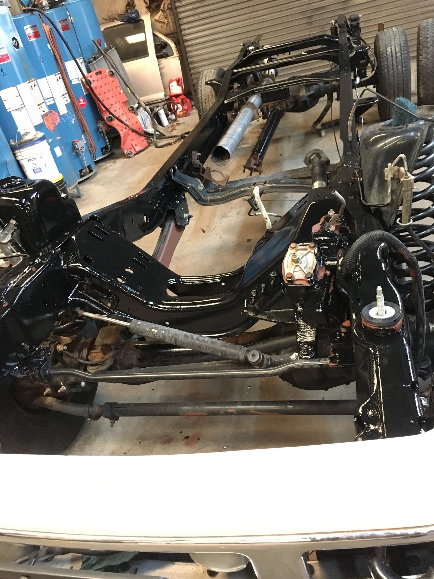

@brokestroke Ah I see what you mean now. That should be too hard as I need to dig in to the cab anyway to replace trim, vacuum out all the dust. Here's the lines on the rear passenger side:
Cab does seem slightly lower than the bed vs the driver's side.
I guess what I'll do is try what brokestroke suggested and see where that gets me. If after that I need additional clearance I'll try pulling the engine forward a little (hopefully won't be necessary).

From your pictures, it looks like you could loosen the v-band clamp at the turbine outlet and rotate your DP down a little too.

I thankfullly have the new Milwaukee mid torque so it made very quick work of the cab mount bolts. Picked up a couple thicknesses and diameters of washer (basically all they had) and jacked up the cab on the passenger side. Unfortunately the thickest washer is too thick, and the thinnest washer doesn't have enough diameter. Plus this didn't really provide much more clearance for the pipe.
I've undone the transmission and engine mount bolts... evidently this is how much adjustment I have to work with:
I suppose it might be worth a try? If that doesn't work sounds like denting the down pipe could certainly work, as inelegant of a solution as that is.
