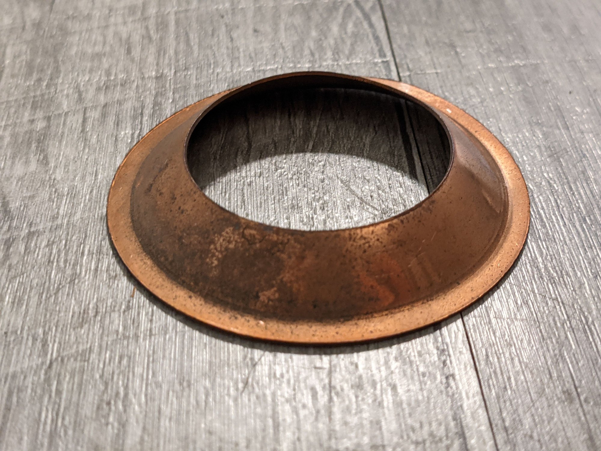

For the gasket to fail the compressed metal inner ring would have to break up, and it would have to do so while not losing the seal as, if the seal was lost, the high pressure inside the pipe would blow out any particulates to the lower pressure atmosphere. That's not a failure mode I think is likely. That being said, given that this gasket was not designed for this application, I'm mostly viewing it as a temporary fit until I can locate or fabricate a copper gasket.
For example, this is one candidate:
Old Aug 31, 2021 | 07:09 PM

Originally Posted by PriusLover
Yeah I'm assuming if there were deeper issues like bearings, cranks, cylinders, etc there'd be mechanical vibration to accompany the sound, and that it would manifest whenever the components were turning/moving.
That looks pretty decent. Where did you find that?

It's a Walker 31543. Made for a Samurai's exhaust system evidently. ID is 1.5 inches so need to open it up a little, but aside from that, it's a great fit. The question is whether the clamping force from tightening the bolts will be high enough/evenly distributed enough to compress the copper and make a seal.
