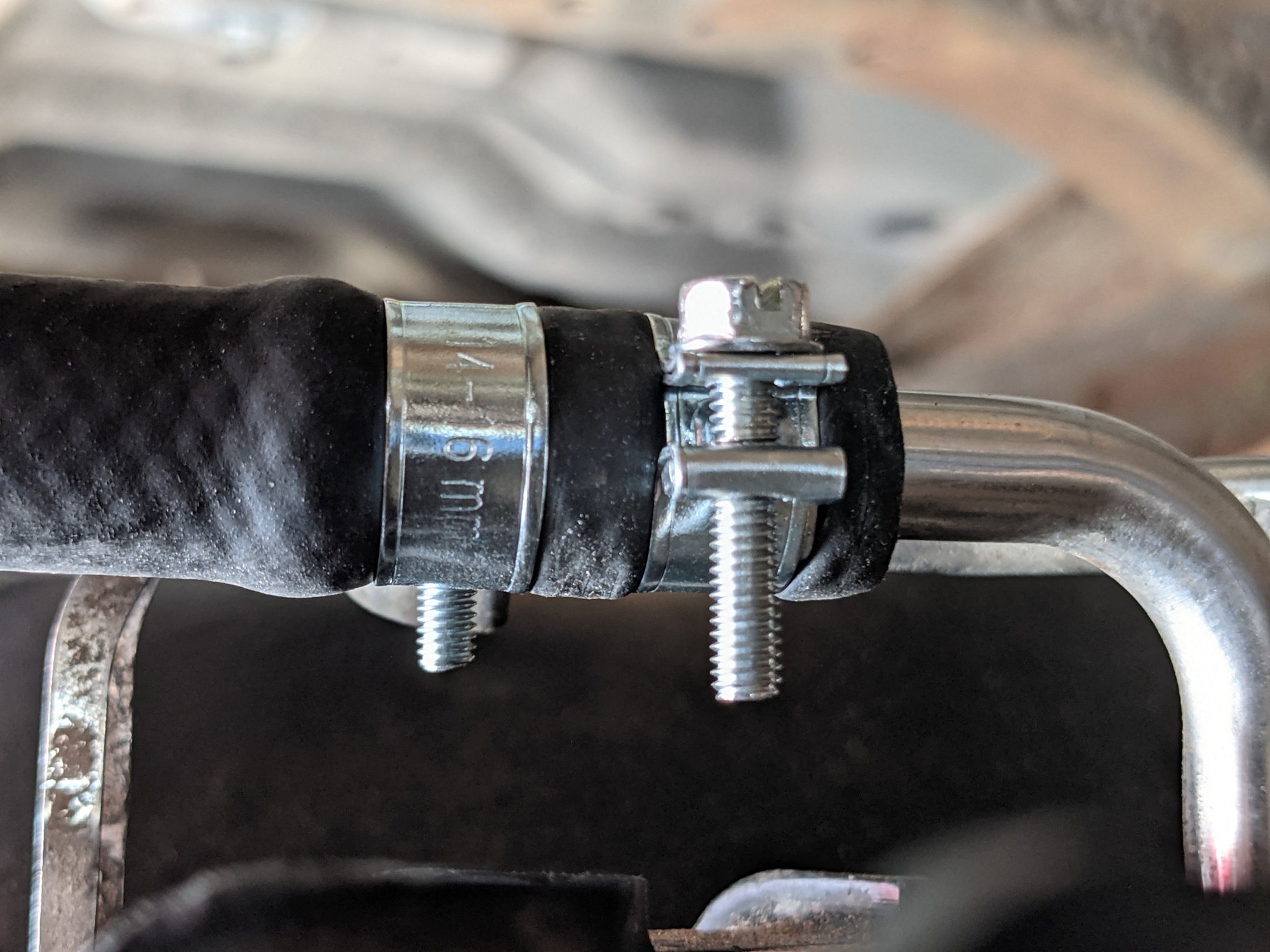

So with the hutch mod, I'm having difficulty getting the 3/8 hose clamped tight enough on the tube that exits the fuel tank:
Clamp is tightened so much it's starting to deform. Should I try and get the hose over the lip?
Surprisingly when I opened up the tank the pickup foot was completely intact. Replaced it with the aluminum elbow @SkySkiJason kindly sent me. Nice thing about alu is that, even if the elbow is slightly too long, it'll just bend to fit when you tighten the ring on the tank.
Found a bunch of small metal particles/flakes on the bottom of the tank. Pretty sure that's the source of the metal I found in the bottom of the fuel bowl. Perhaps a gas station pump giving up the ghost?
*EDIT* clamps tightened properly once the hose was shoved over the lip. No way it's getting off

That is the best way to slide the hose on. I use this detail at the pump as well. I don’t find the quick connect fittings ‘suck air’ the way the internet parrot talkers often say, so I leave them at the tank to make it easier to remove if it’s ever needed.

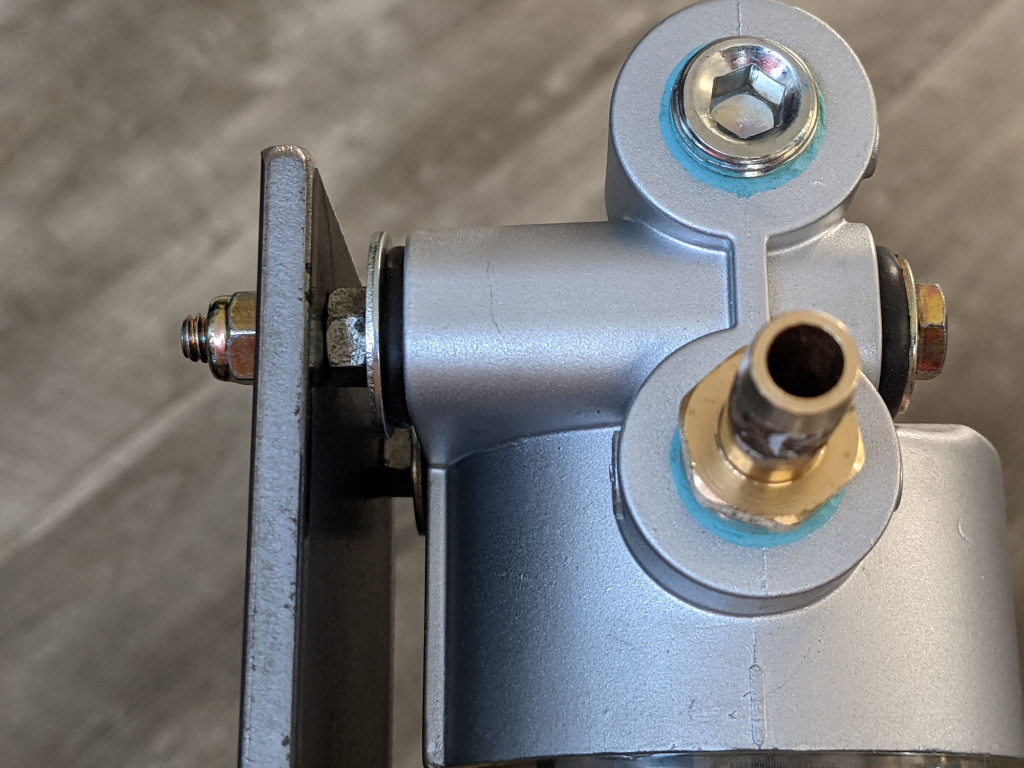

Here's what I came up with for mounting the Racor filter:
And mocked up on the frame:
Used these predrilled holes in the frame as there were no other holes available and I didn't want to potentially create a source for cracks by improperly drilling new holes.
If I hadn't the angle iron on hand, I would have bought some thicker stuff to reduce flexion. Angle and plate plate are secured with 3/8 grade 8 bolts and nyloc nuts. The filter is secured with 1/4th bolts/nuts.
Rubber bushings are used on both sides of the filter to help with vibration.
Use one nut on the bolt to compress the bushings, and a lock nut to attach the bolt to the plate.

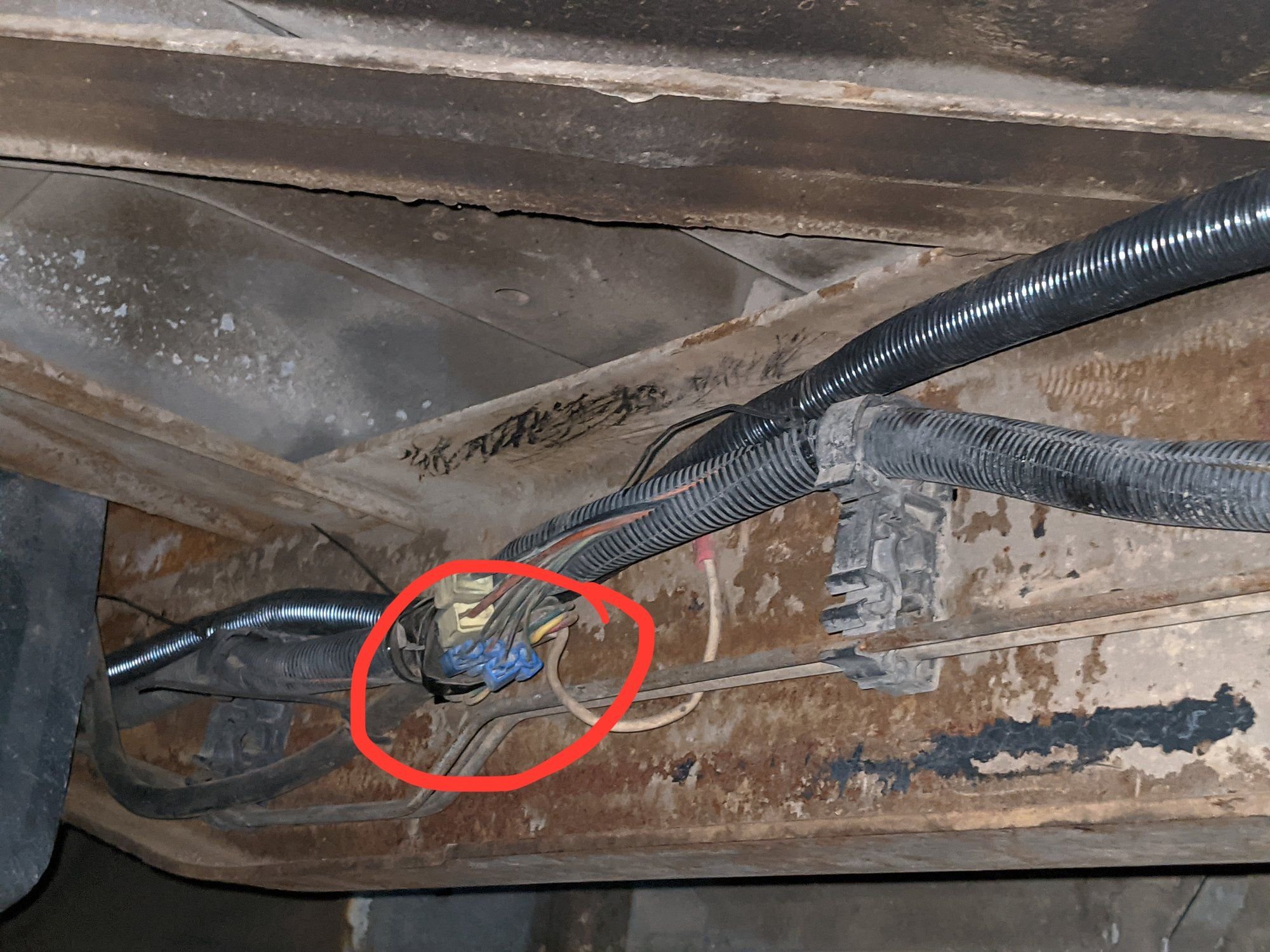

Heads up, this type of blue splice connector can sometimes cause connection issues. I’ve used them plenty of times but just wanted you to know for an easier run down if you ever have any issues.
