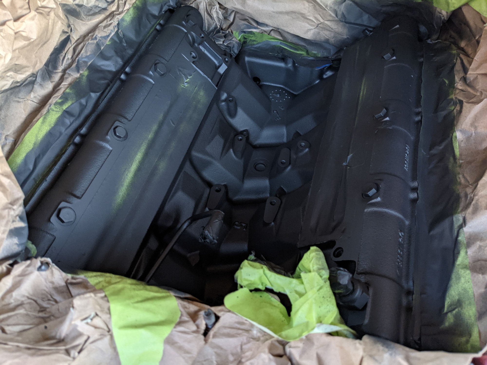

Back in truck world, I got fed up with the BBQ paint not wanting to dry properly on the engine (worked fine on the other parts), so I gave up and threw paint strip on to take everything off.
Then masked off everything save the engine iron, wiped down with acetone, and shot a couple coats of black Rust-Oleum 2X primer. Already looking good:
Per the specs it's an acrylic modified aklyd—oil based enamel that's been beefed up with acrylic, so it should be hardier than the standard can of Rust-Oleum.

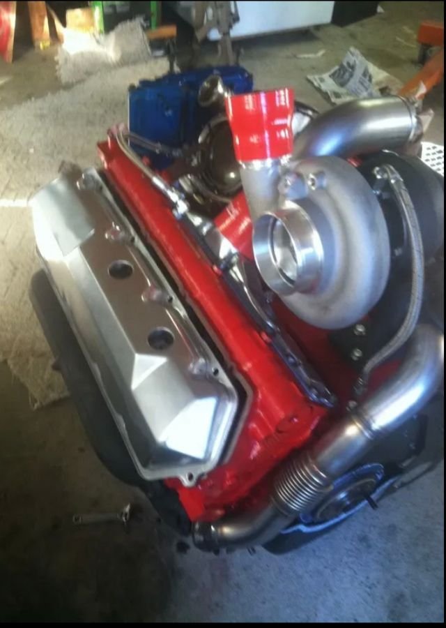

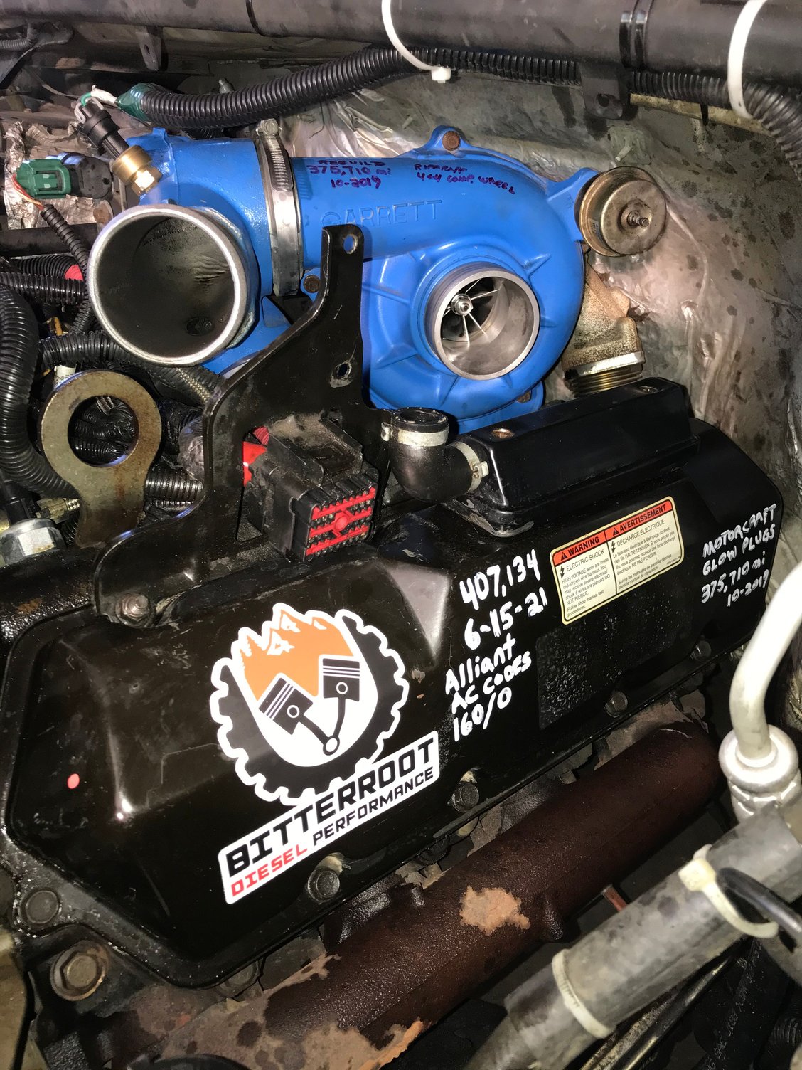

I have great success with the 2x paint. Multiple light coats will increase its endurance. Thickness counts!
It handles degreaser and p-washing very well. Your surface prep should be adequate for good adhesion.
This ‘chrome’ is powder coat, but red is 2x.
This was painted 1.5yrs and over 30k miles ago. Still looking great yesterday after replacing the crappy UDP injectors.
