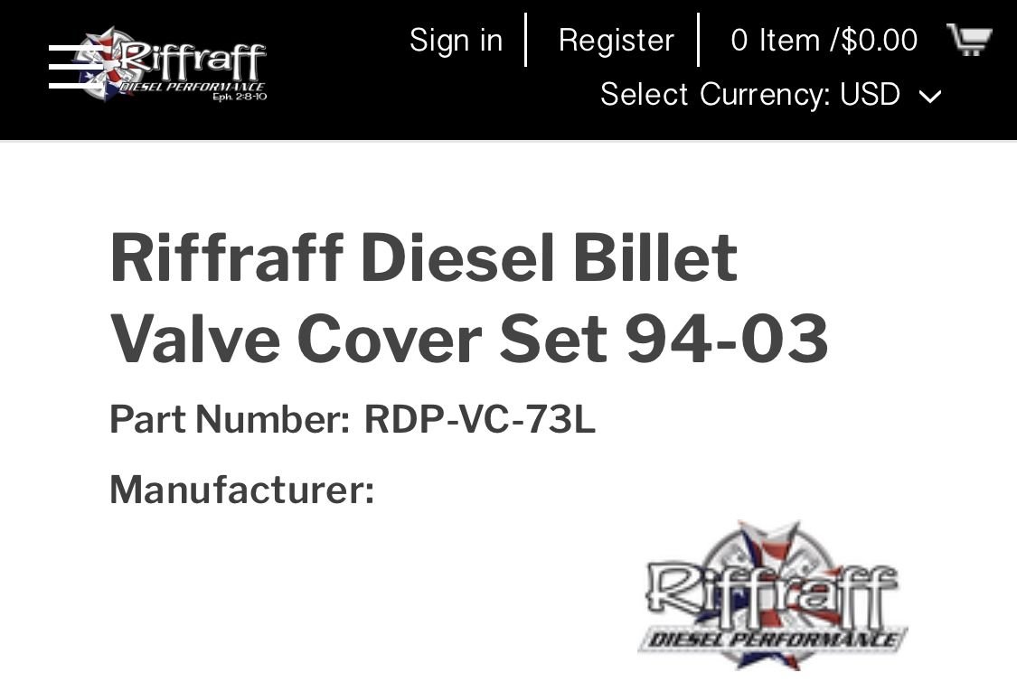

If the paint doesn’t work out, you still have a higher priced option for the valve covers.

Even if I could afford them, that's just too hard to read. Felt bad enough getting the machined plenums!

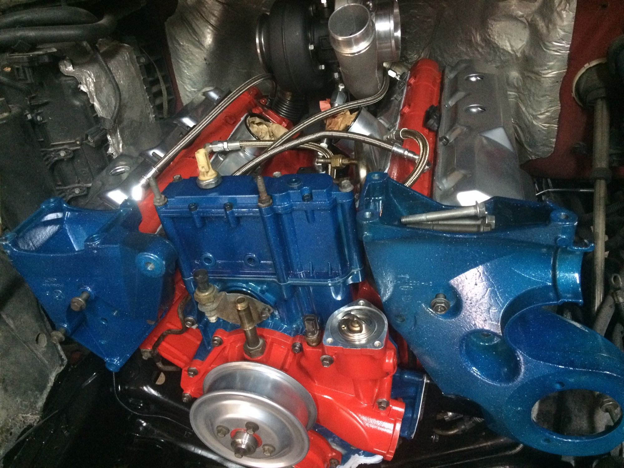

Engine paint is 99% done. Just have to go around the plenums with a small brush and get the gaps.

Also wrapped the up pipes and most of the DP with the ARTR wrap. I highly highly recommend doing this outside while wearing solid gloves, full body clothing, respirator, and goggles. This stuff sheds a *ton* of small fiberglass fibers that aren't readily visible, even if you're being gentle with it. And change your clothes right after you apply it or else you'll track it in to your house/furniture.
