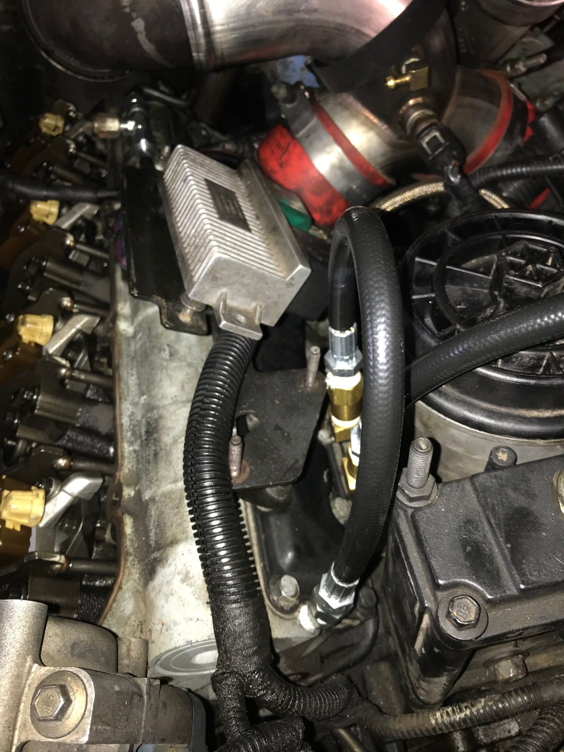

Consider running the passenger side fuel line under the turbo pedestal/base plate.
Looks like the lines leaving filter assembly may need to point more ‘up’ to clear the AIH/GP relays.

Nothing wrong with the way your passenger side fuel line swoops over the valley. Mine is the same way. Like SSJ said, you may want to run it under the pedestal.

Sous: Decided against relocating the GPR. Too many variables for a layperson like me to feel confident in doing it safely/reliably at this point.
Since I don't have an AIH relay to worry about, it's a bit easier to accommodate the GPR:
There's enough room for the hoses to clear the GPR bracket and avoid rubbing.
I initially wanted to rout the rear passenger line below the pedestal, but the 45 deg fitting makes the angle way too tight for it to duck under the low sitting pedestal without a very tight bend and rubbing on the edge of the pedestal.

Understood and you have done your due diligence in planning it looks like. I recently replaced the OEM fuel lines with the Riffraff lines and my passenger head rear line runs nearly identical to yours.
I too found routing it under the pedestal too tight of a bend and decided to go over the pedestal. Nearly 3,000 miles of towing later and it is still doing great.
Might I suggest a piece of reinforced hose between the line and the corner of the GPR bracket if you have any concerns about it.
