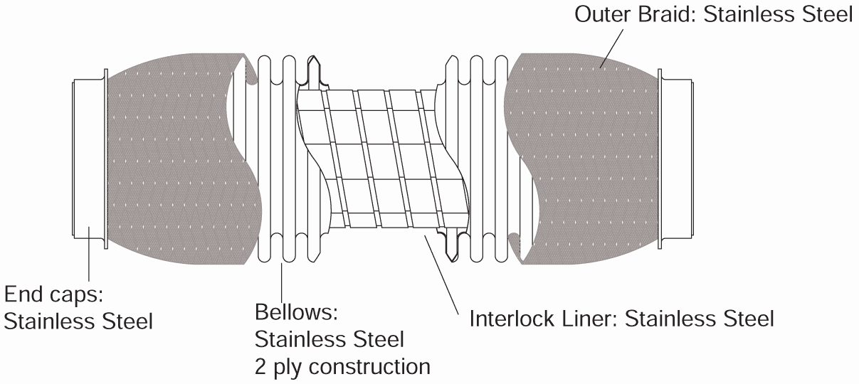

Originally Posted by PriusLover
I can't get a picture right now, but it does have an exhaust flex pipe liner on the inside like this:
Interesting.
I’m pretty sure the CSD kit had the braided outside with an accordion style inside (which I always maybe mistakenly called “bellowed”). I believe this is the same accordion style that is used in the stock turbo “bellowed” uppipes. Guess I could climb in the attic and look at those when I get home… Of so then the CSD style should have many miles on a similar flex joint.
I have no idea on the type you’re showing a photo of. Haven’t seen that kind before myself.

So this is the type of flex joint the irate (and CSD) pipes use:
These are the kind recommended by exhaust part manufacturers for pre turbo:
And almost every seller of these joints that I've come across says stuff like this:
Again, it'd *probably* be fine, but that evidently involves a level of risk, enough to warrant these kind of disclaimers and warranty exclusions.

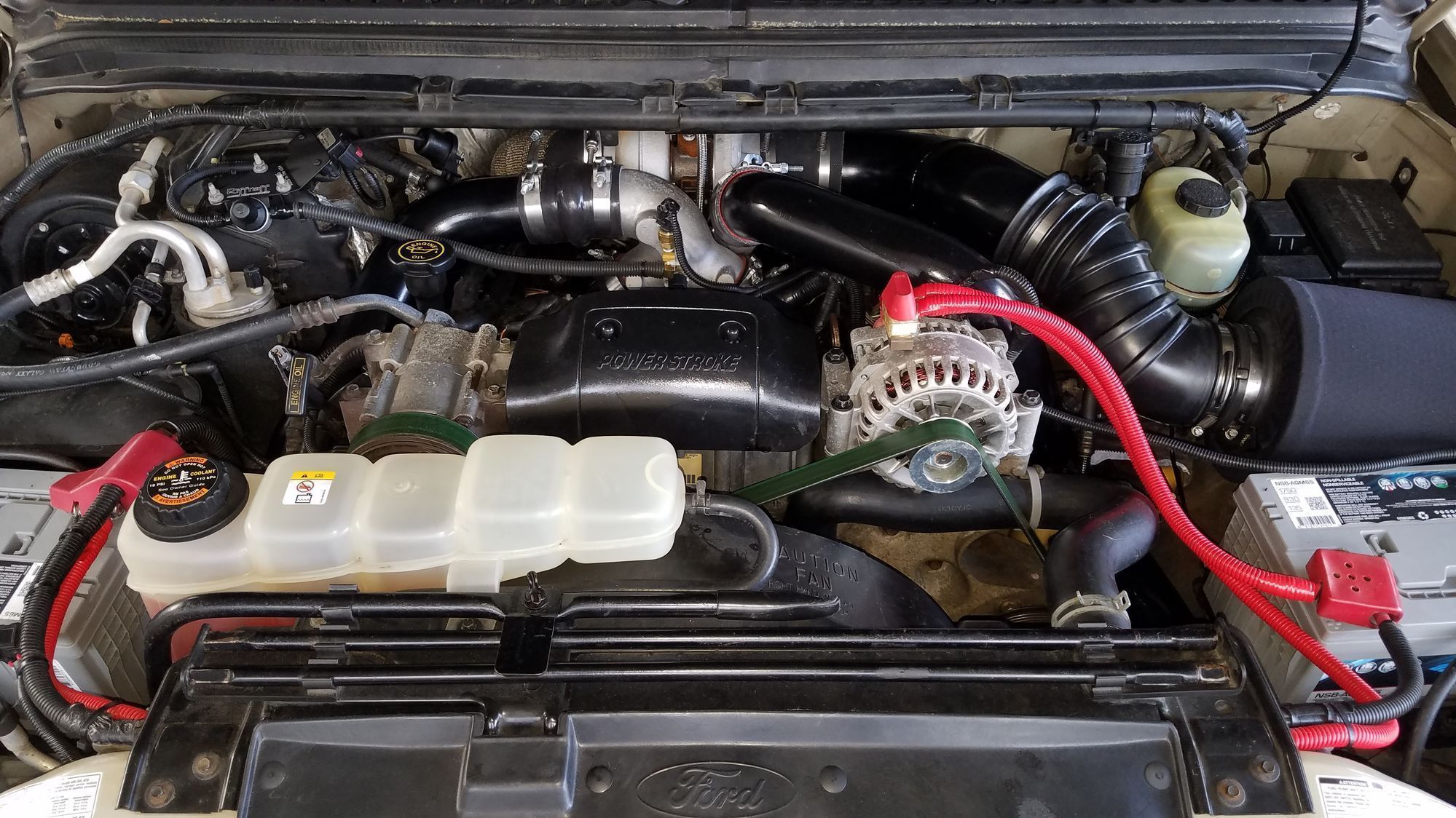

I think black paint in the engine bay looks nice. Subdued, but classy when it needs to be.
I polished up my valve covers and left them black too.
I believe dust is a protective coating....
