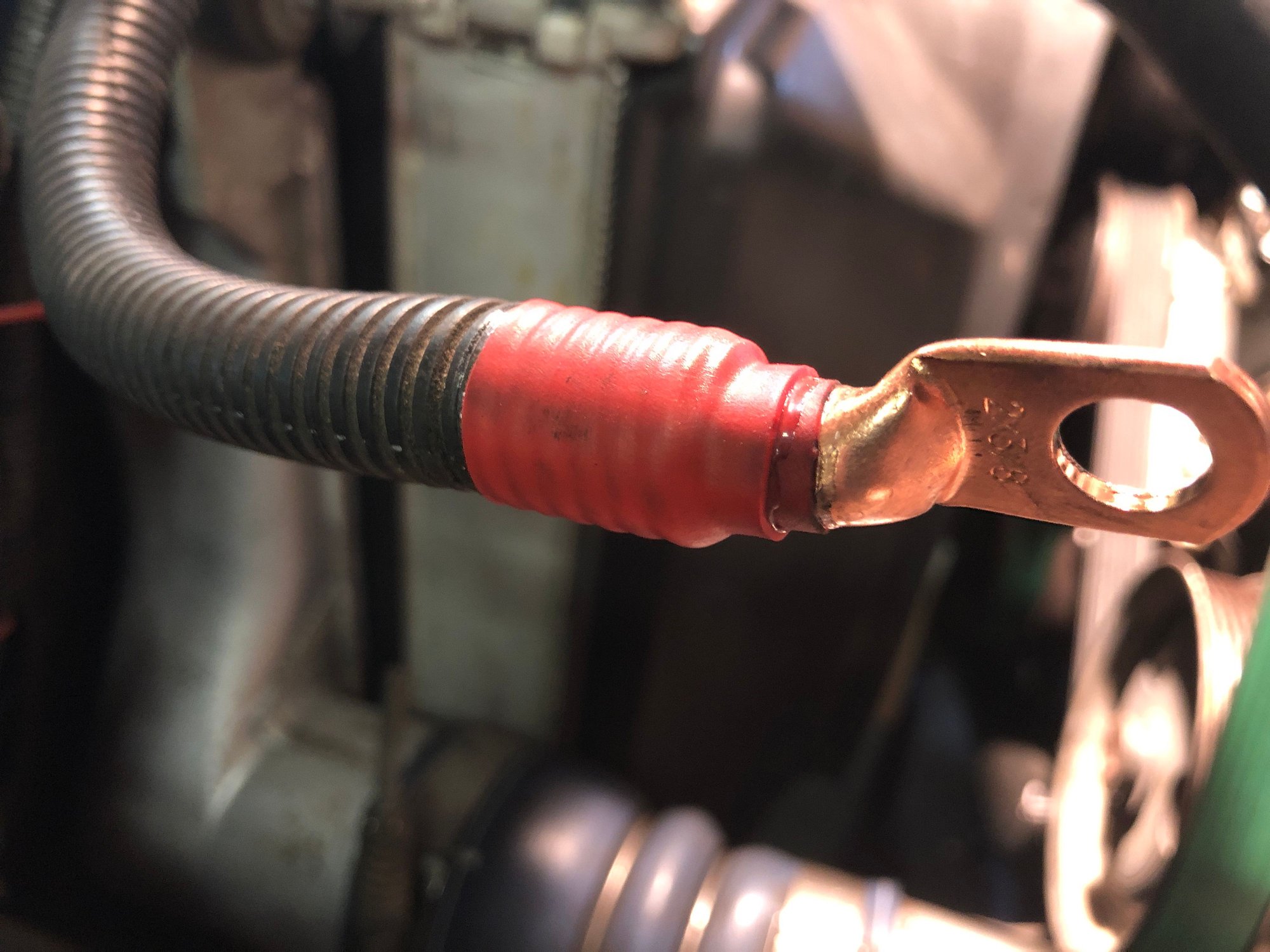

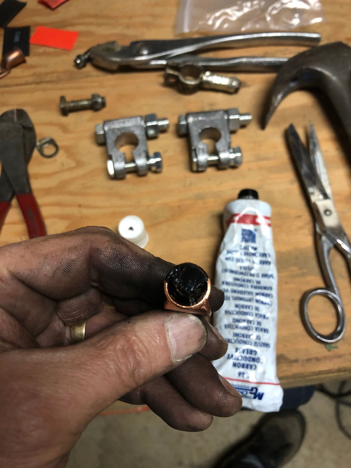

Just finished the military clamp conversion for the battery terminals.
Currently running 5 year old lead acid batteries that are maintained on a NOCO Genius 2D for the last 2-1/2 years, prior to that no maintenance.
Amazon Amazon
I used conductive grease on all the cables and lugs. Cables were in great shape with minimal oxidation. I didn’t have to cut more than 1 inch off any cable.
BTY that conductive grease is nasty. It’s not just greasy, but carbon black deep into the pores wash my hands 3 times nasty.

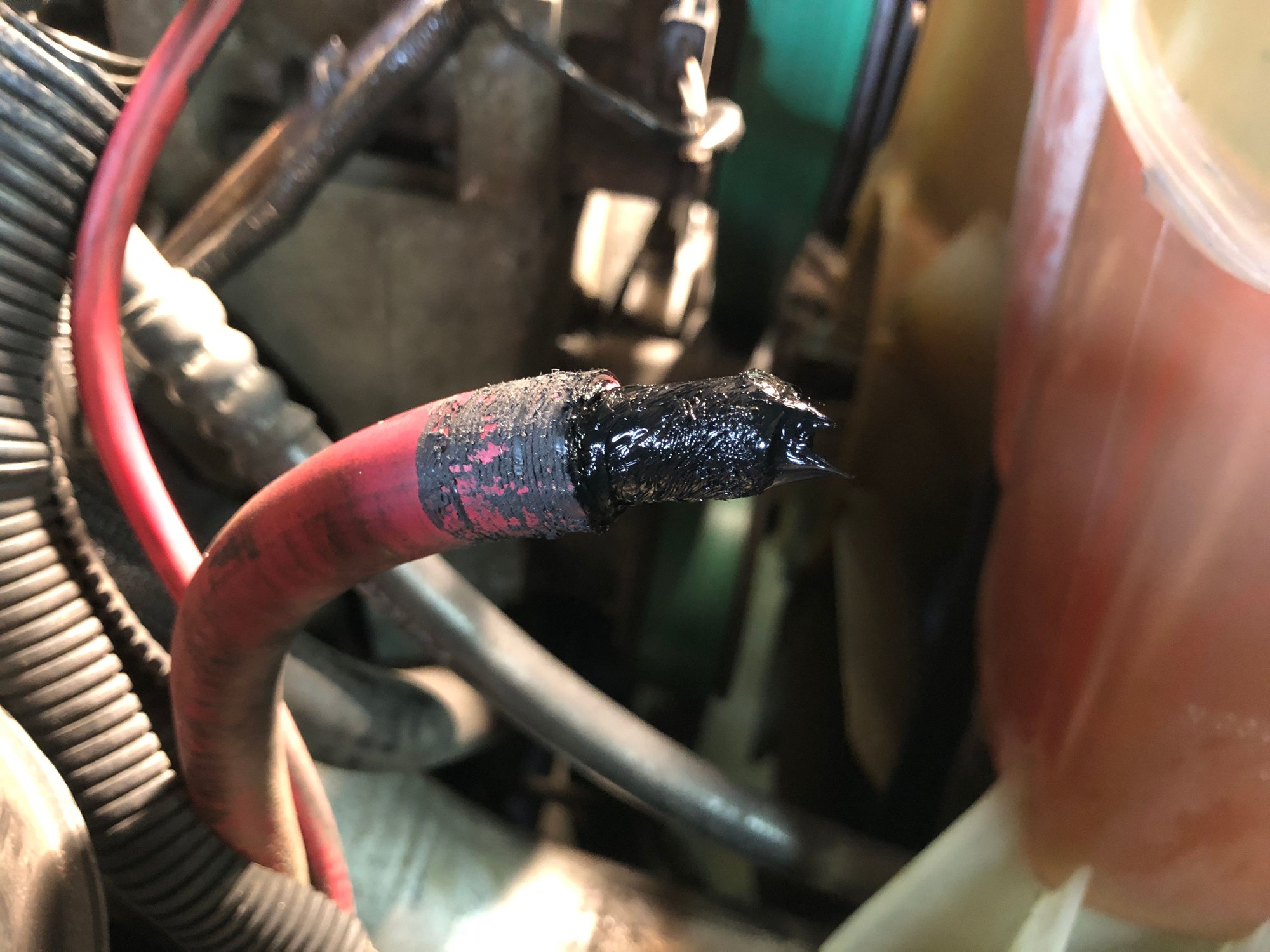

Showing the saturation I got on the cable from the lugs. That was before I even used heat.
I used adhesive lined shrink from cable to lug, then also locked in the split loom.
I used adhesive lined heat shrink from cable to lug, then also locked in the split loom. Colour coded of course.

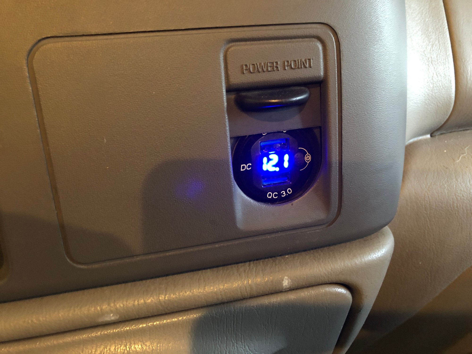

KOER with glow plug relay still active. Never seen the voltage in the +12 before today. IIRC 11.7 was average.
KOER with glow plug relay still active. Never seen the voltage in the +12 before today. IIRC 11.7 -8 was average. Been a couple months since I fired it up though and my forgetter is getting better.

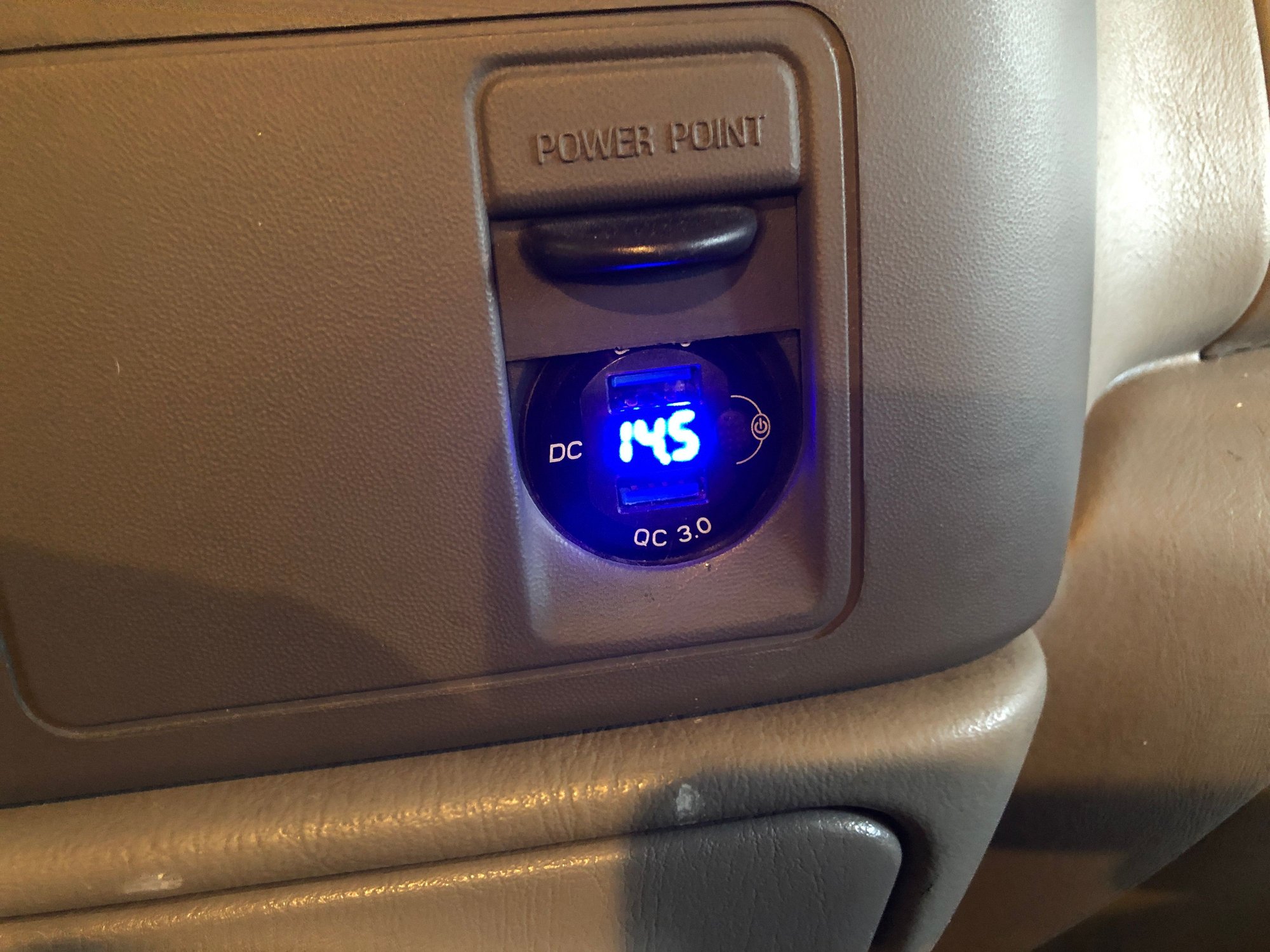

KOER after the GPR kicked out.
KOER after the GPR kicked out. That’s always been a variable based on GPR cycle and engine RPM.
The 23 year old factory terminals didn’t look bad but the results speak for themselves. I call this a success considering investment and time.

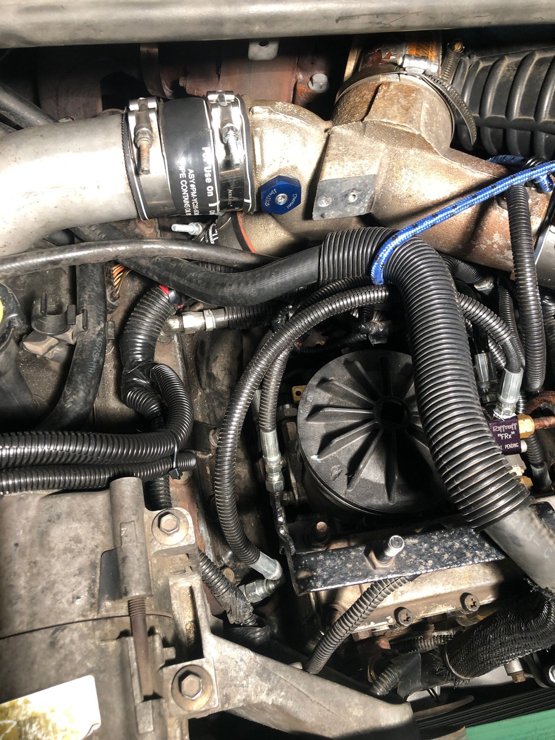

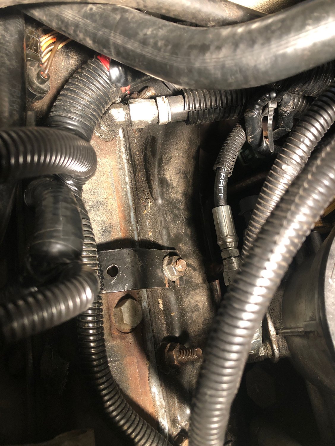

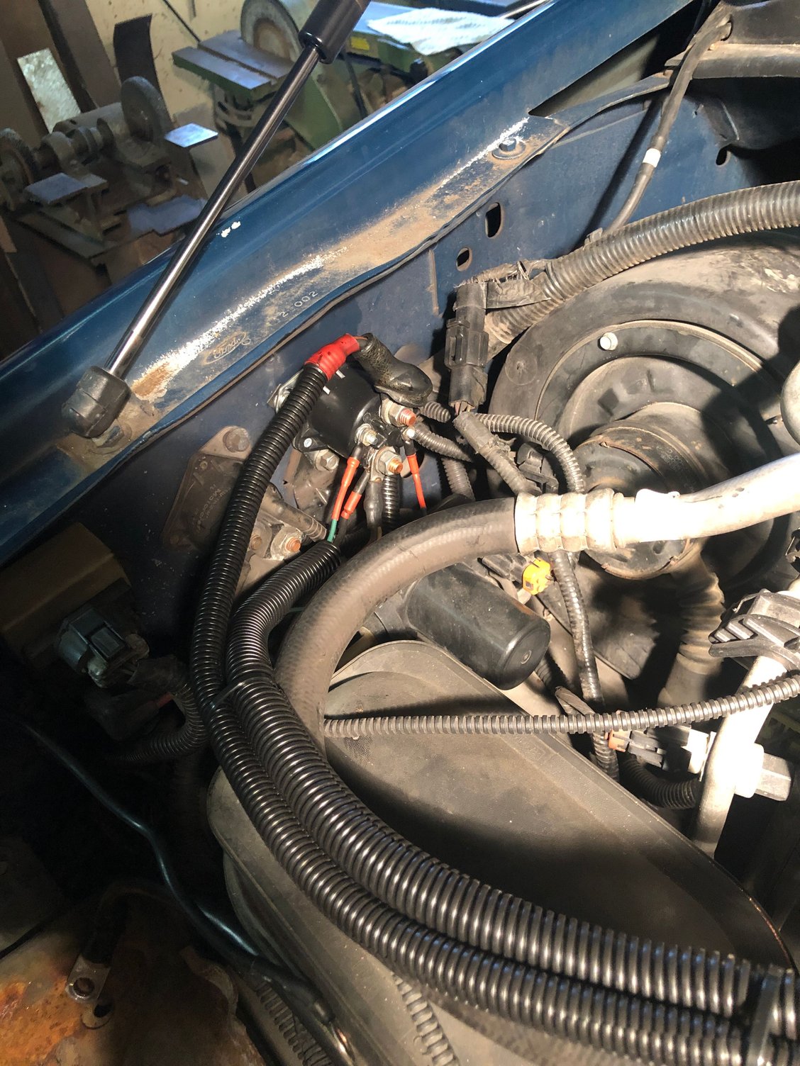

Today I finished up my GPR relocation and AIHR delete.
Before… wires are removed but relays and bracket are still in place.
After… so much more room in that tight valley. Wish I would have done this before the fuel pressure gauge. Would have made that job a lot easier.
I mounted the GPR on passenger inner fender. Lengthened all the related GPR wires to accommodate.
I’m not sure if I will keep the 6awg relay feed line separated or if I will tuck it into the same wire loom as the relay control and glow plug feed wires.
This is how it currently looks at the inner fender.
I even made a bracket to support the wiring harness. I utilized one of the plenum bolt/studs to secure it.
I trimmed back and terminated the wires for AIH with heat shrink and taped to the harness before doing the wire loom. I know it will set a soft code, but no cel in dash. No biggie since that soft code has been there for years after deleting the heater element.

What is the reason for moving the GPR to the fender?
Old Jan 2, 2025 | 05:23 PM
  #1044
F350towing's Avatar
F350towing
Joined: May 2020
Posts: 2,936
Likes: 2,198
From: Langley B.C. Canada
If I can’t get my Fuel Pressure where it needs to be with the fuel bowl FPR poppet and spring then I’m going to go with an external regulator and that will be where I mount it.
Let’s call it a preemptive strike.

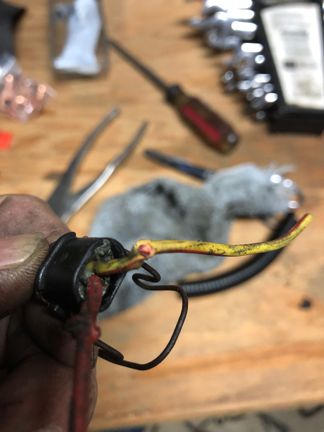

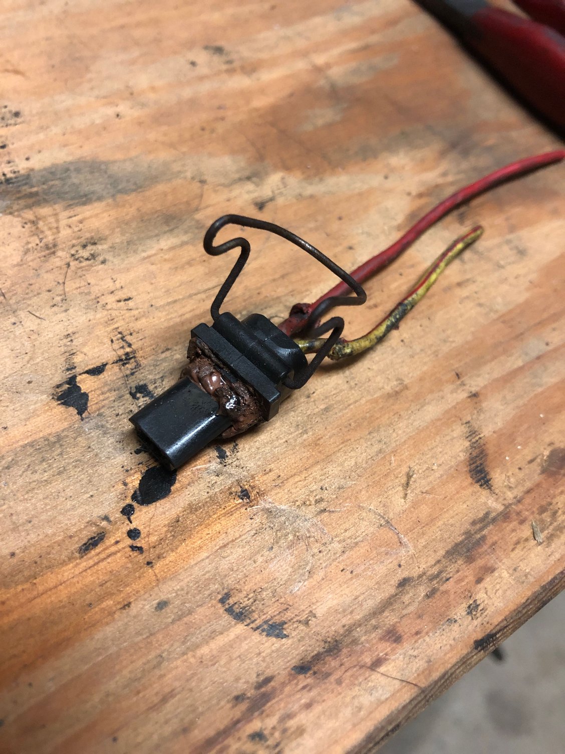

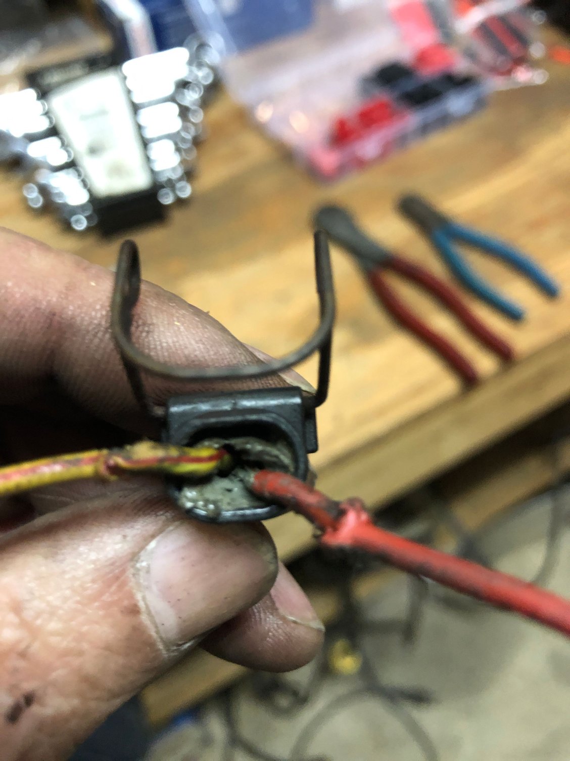

Noticed that my IPR plug seal was all gummy and gooey so decided that it was time to replace.
Stripped back the harness to the main trunk and checked the wires. All looked good, so I spliced in about 2-1/2 inches back.
Once the plug was out I got to take a closer look at it. Is it normal for the 2 wires to be fused to each other about 1/4” off of the plug?
Also found a small bare spot on the yellow wire.
Seal on the plug is done.
Seal on the plug has broken down.
Almost like extra insulation on the red wire where they we’re fused together. Grey goo inside, I’m assuming that was an insulator material
Small bare spot
Small bare spot. Lines up with the fused area. I may have done this when I separated the 2 wires.
